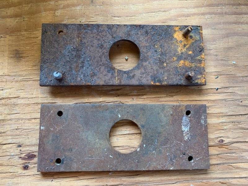

There's a big steel plate with 4 counter sunk screws. On Chargers they had a large hole in the center.
The extension is the frame that sits under the cap and provides structure. The hardware goes through the plate in the extension and through the back of the console. I took it apart a year and a half ago, and somehow the hardware got mixed in with something else
If talk about console extension the screw are fairly large phillips head screws. the heads are about 7/16" to 1/2".
Think what it threads into is mounded in rear section, no loose nuts. Been awhile.
Isn't the steel plate threaded?
The holes in the steel plate (“extension” in the parts book) are not threaded in my car
Here is a picture of what they look like. All the ones I have seen have the threads in the plate.
