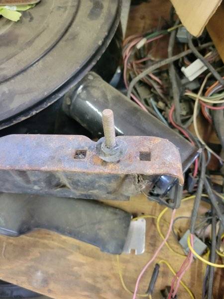

Look at the seat mounting from underneath. You should be able to remove the seat and re-drill 4 holes. Even 1 inch makes a big difference.
You can't just drill new holes in the floor pan. The seat holes actually pass through a reinforcement bracket that is welded to the body side rails. I am a tall guy too, and was feeling cramped in my '64 Polara. I found a set of seat extenders at Jegs that bolt between the seat and the adjuster mechanism that moves the seat back about 2" . These are universal and can be used on many different cars.

Check if your seat frames are like the bucket seats and have multiple hole positions...
I found the seat extenders at Year One in Georgia. They have a web site. Click on B-body, then on Interior. They will be in Seat Frame section. Part # is SB 246 $32.93
Depending on the reinforcement brackets width there is room to go back and re-drill. One inch is doable on just about any car I have done.
