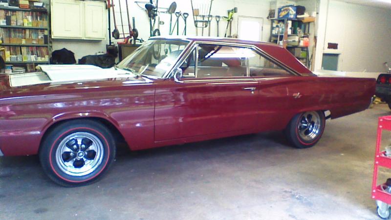

Personally I'm a Crager S/S fan. Love the look and fits the period. I just ordered a brand new set for my GTX to replace the pitted ones I've had on there for 40 years. Love that look with Goodyear polyglas GT raised white letter tires. Could be any tires - anyway......

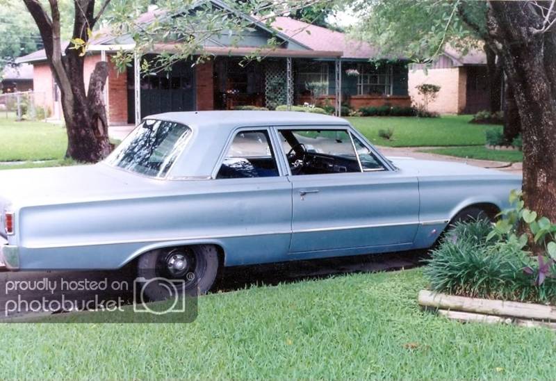

Cop car wheels I've got. I know what you mean about tight tolerances for the rears as well. With the 255/60/15's on cop car wheels with a 4 1/2" backspace I have about an 1" of clearance to the quarter and about 1 1/4" to the leaf.
Any pictures of your cars Meep-Meep?

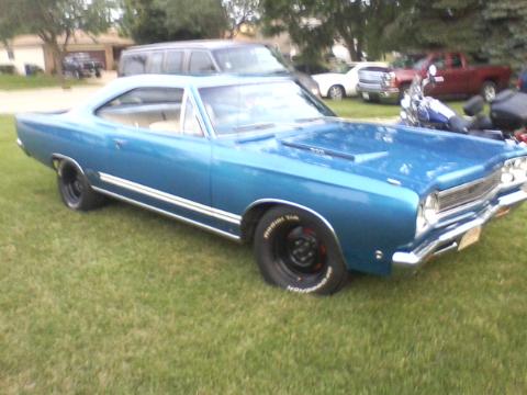

Here are mine: Rev Classic 100
Front: (2) 15x7 - (4" Backspace, 1" Lip)
Rear: (2) 15x8 - (4.5" Backspace, 1.5" Lip)

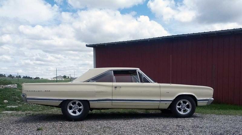

All are good choices. For a 67, I like the Keystones.

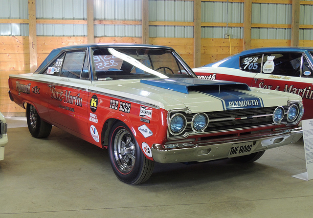

Had black cop car wheels with the small center caps but I'll be going with slots next.....and yeah, the weather had been nasty so the dull paint looks even worse but I did wipe off the wheel :D
