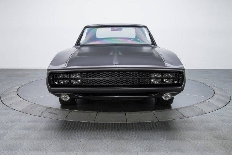

Thanks KD, I've looked at your post and the dimensions that you have used and your car looks great and I understand the look you are trying to achieve. I'm kind of trying to bring
more modern touches to the look of this car as I've seen in some of the ultra- customized chargers 1970-dodge-charger.jpg. I favor painted bumpers, no vent windows, shaved moldings, custom grill w/ headlamps exposed. The Gen 2 design is timeless and can look period correct even in the 2020s. Not many cars designs can claim that achievement.
