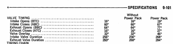

Hi where can I get information regarding the cam profile that originally was in the 440....Thanks
Intake Duration. 268 degrees
Exwhaust Duration 284 degrees
Lift. .458"
from FSM.
First column is for 383s, second and third are for 440s.
