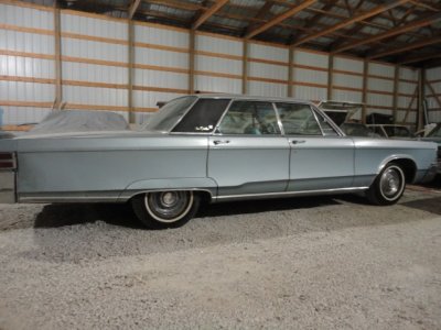

Hey matt! My 67' New Yorker is still sitting here waiting to be adopted. 15 years and counting!Lol
I wish I could. Hey did I ever answer your email a while back????
Hey, I don't remember! Mental pause they call it. I''ll post it for sale here one of these days. I'm a bit attached to it.
4dr. hardtops are so gangster....and hard to notice the 2 extra doors, immediately.,
If it were a '66 300 4 door hdtp with power vents and a console I might be seeing if he'd trade for a B-body project.
It is a clean car. I have had it here since around 2001 or so. It has never sat outside as long as I have had it. All original, and the engine/trans runs excellent. No power vent,sorry matt!
****, I thought it had power vents. I'm really out then!
That is a sweet car though, you should put some miles on it!:thumbsup:
They are powered, depending on how much energy I have! Lol
