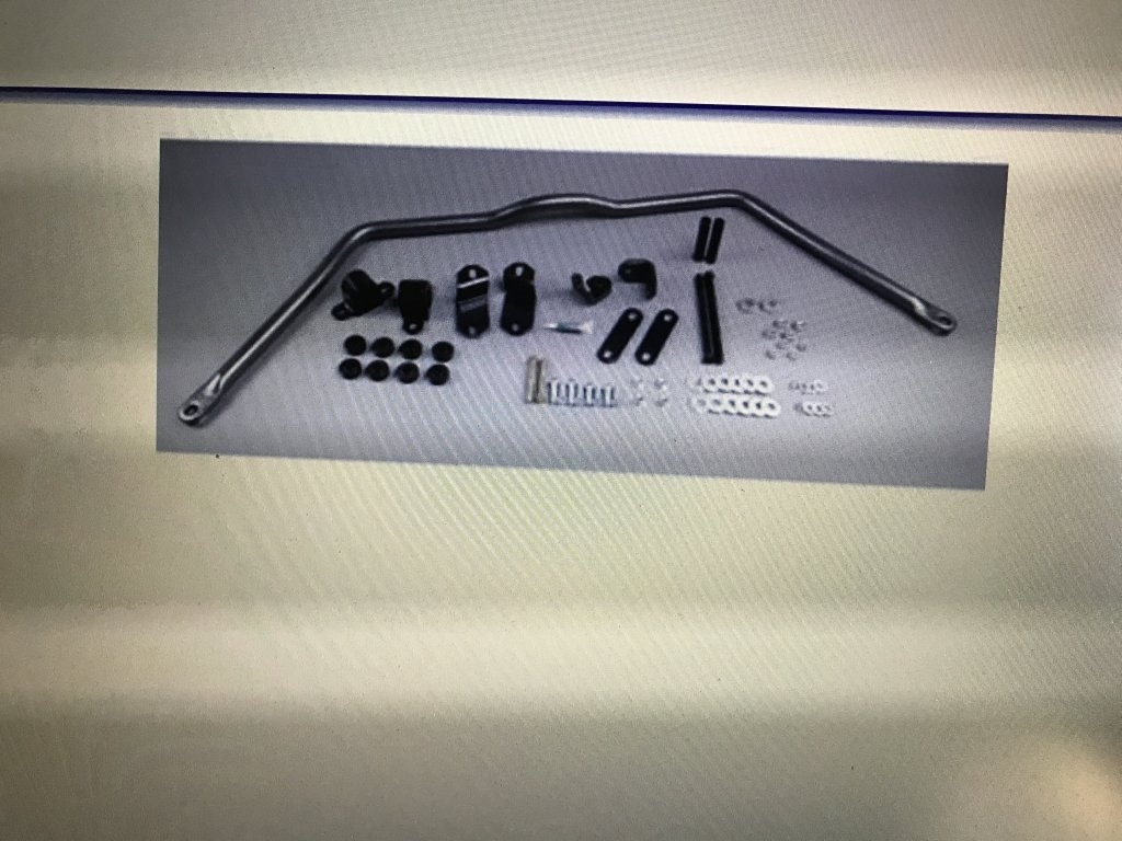

Got a polygraphite bushing kit from PST coming in and a summit front sway bar.

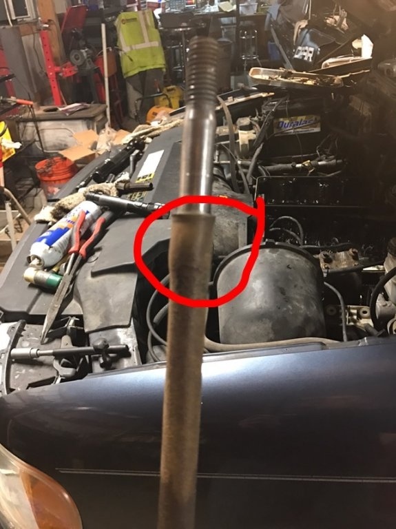

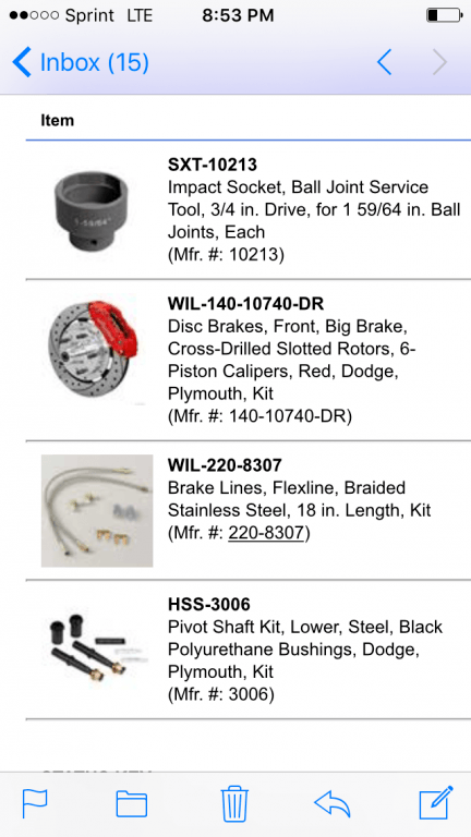

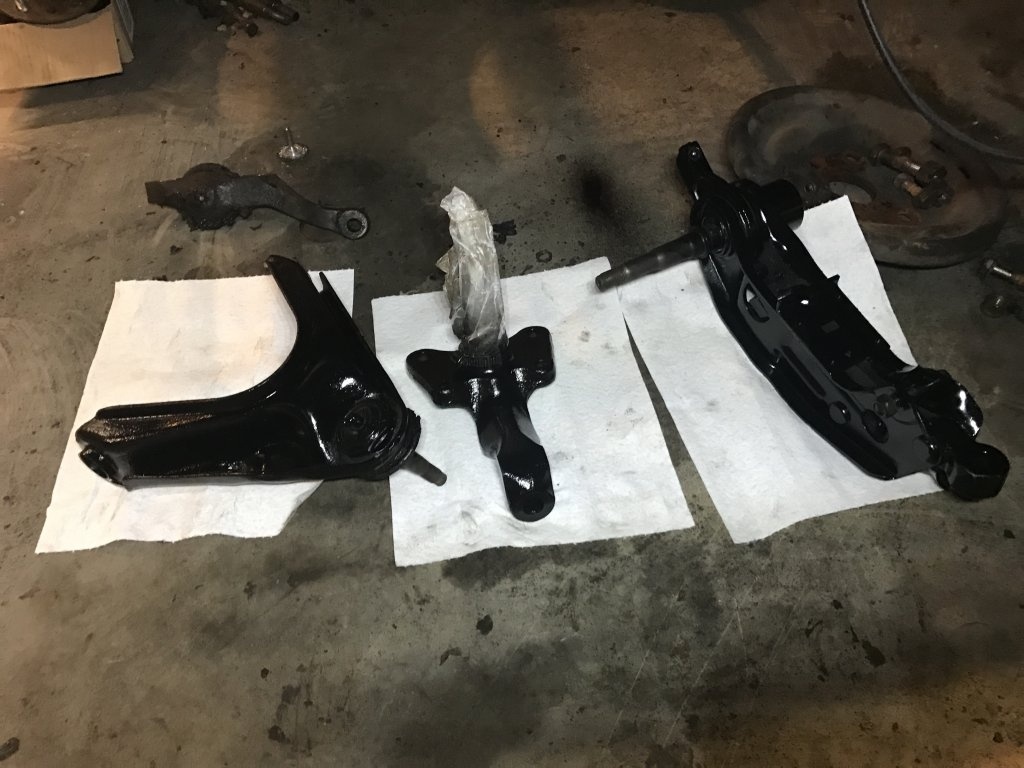

Hey guys started installing my front end kit from pst ran into a couple problems and had to get new strut rods, when I removed the drivers side it flexed like a half moon! The passenger side was bent towards the end so I decided to replace, also pivot shafts need replace so while I'm waiting I cleaned up my control arms and spindles and ordered the front brakes, 6 piston wilwoods can't wait to get them.

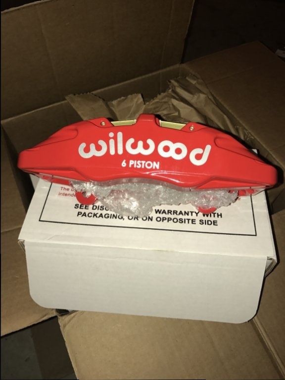

Got a big delivery of parts yesterday, new wilwood 6 piston front brakes, new hotchkis lower pivot shafts, Mancini racing strut rods. If everything goes to plan I'll be done with the front suspension this weekend,also have new inner tie rods from moog and idler arms also moog. check out the size of these wilwood 6 piston calipers, I love it!
View attachment 406148 View attachment 406149 View attachment 406150 View attachment 406151

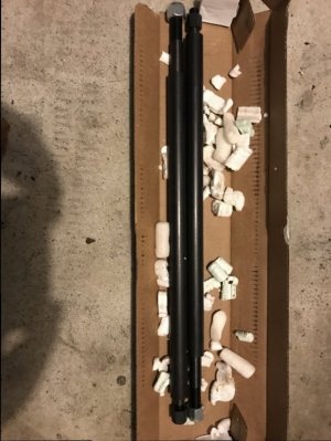

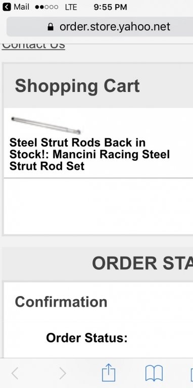

New beefy strut rods from Mancini, these are bigger than the factory rods. can't wait to get to the garage Friday I have a lot to do

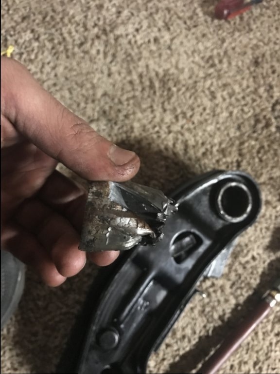

The poly is nice, but be ready for a pain in the *** replacing the lower control arm bushings, too me 4 hours to get both removed, what worked best for me was a small chisel and hammer.

That's odd, wish mine were like that cuz that's was the hard part, I pressed my shafts out in little time but struggled with the outter sleeves.
They are a PITA....Mancini has a tool that changes hours to minutes....For us here a bunch of friends went in on the tool so it was more economically sound. The next best thing but you have to be careful is to weld a washer and press out....
Ya I seen they have the remover after the fact, I didn't even think about it I was determined to get them out, good experience if nothing else. Next time I'll be using the remover for sure though!
