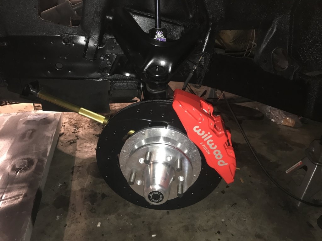

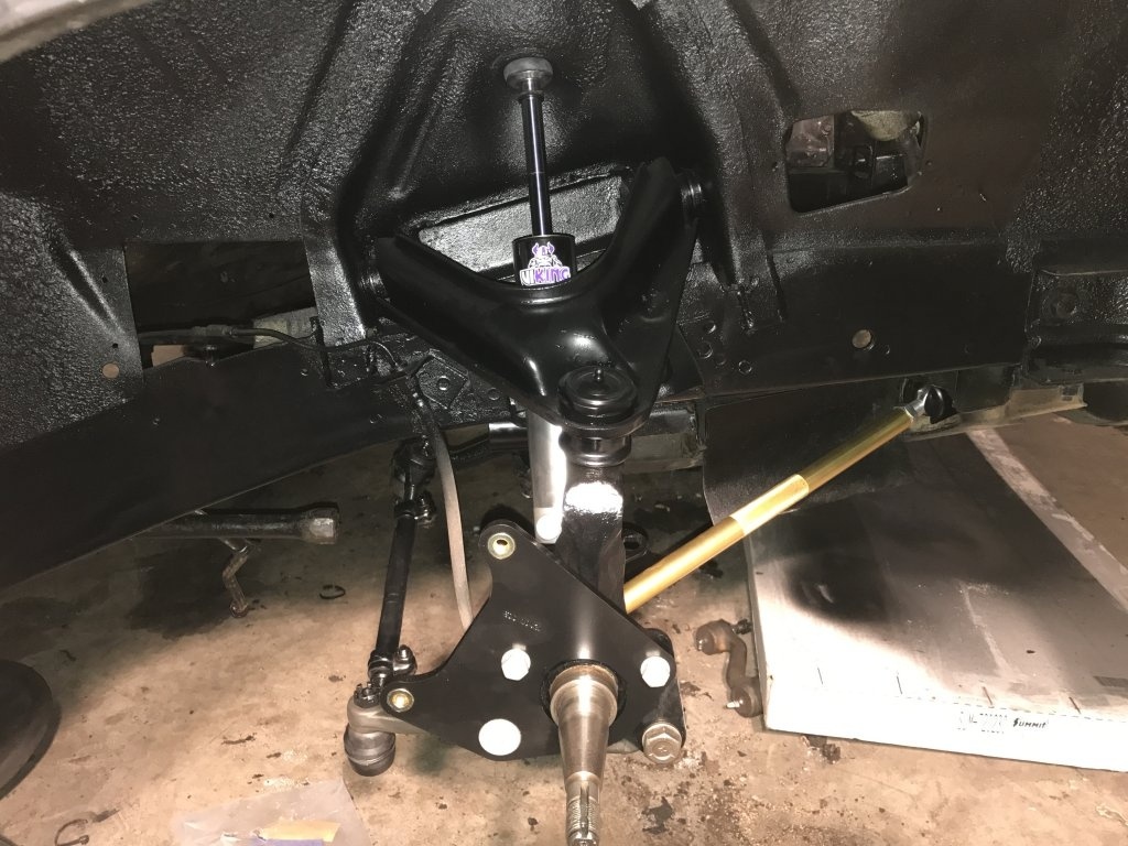

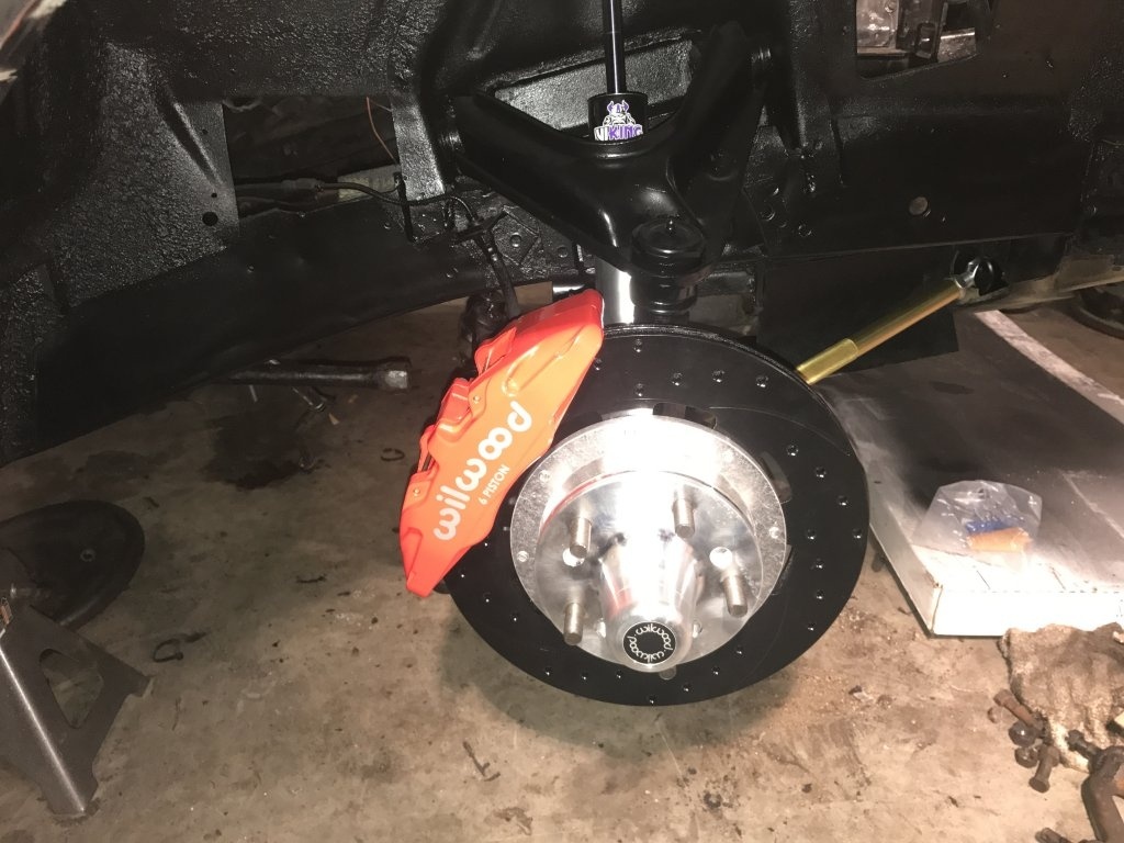

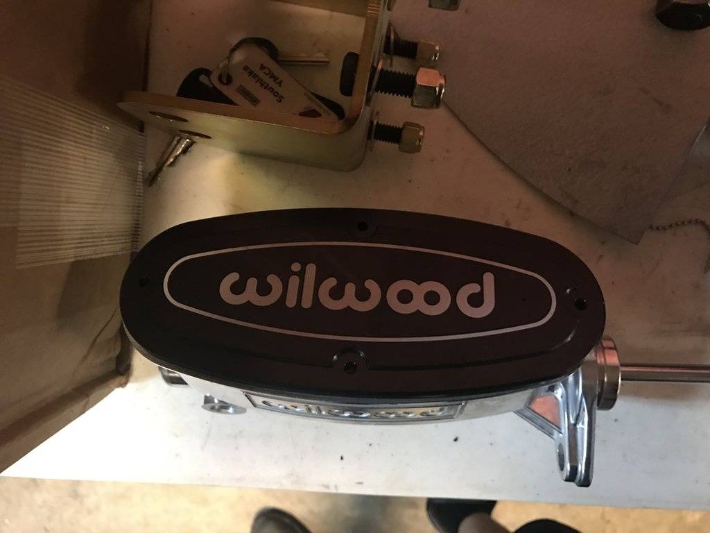

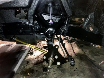

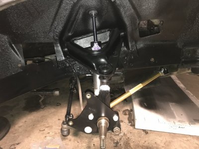

Buttoned up the front suspension finally and installed the wilwood caliper bracket, had to get the hell out of the shop last night or I would've been in there all night. I'll have the brakes assembled this weekend

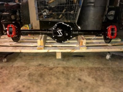

Finally putting wheels back on the ground, 4 link is next RMS sent me a new cross bar to fit the dana so I can start assembling now.

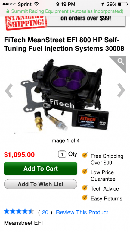

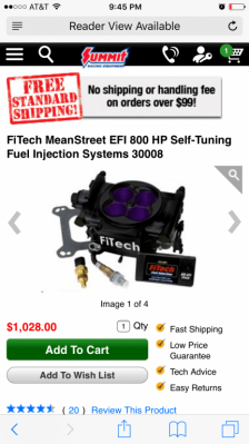

Original plan was to use Holley sniper efi the 8 injector version capable of handling 1250hp, but I talked to Holley and they're so far behind in back orders for the 600hp version they don't envision taking orders for the 8 injector version for another "4-5 months" so that's out of the question now. I'm thinking I might use the fitech meanstreet efi, anyone have suggestions on fuel injection for a 700-800hp 505"
My two cents don't do the returnless setup. They say it's good but you end up with cavatation. Spend the money and get an efi intank setup. I had the atomic efi setup and with the returnless pump. Was great until I took a hard turn and cavatation started and never quit....
Run the fuel command center or the edelbrock sump setup if you want to keep your stock tank and pickup.
Ya no way, Im goin with a 15 gallon cell and in take pump

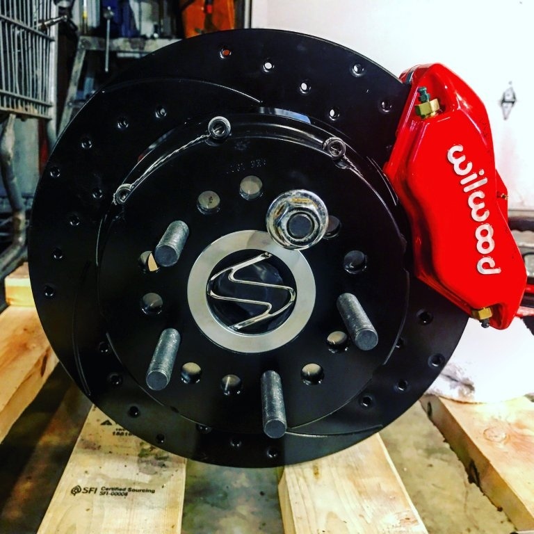

Started prepping the strange s60 for install (hopefully this weekend) got the rotors and calipers mounted up still have to fab brake lines and install distribution block

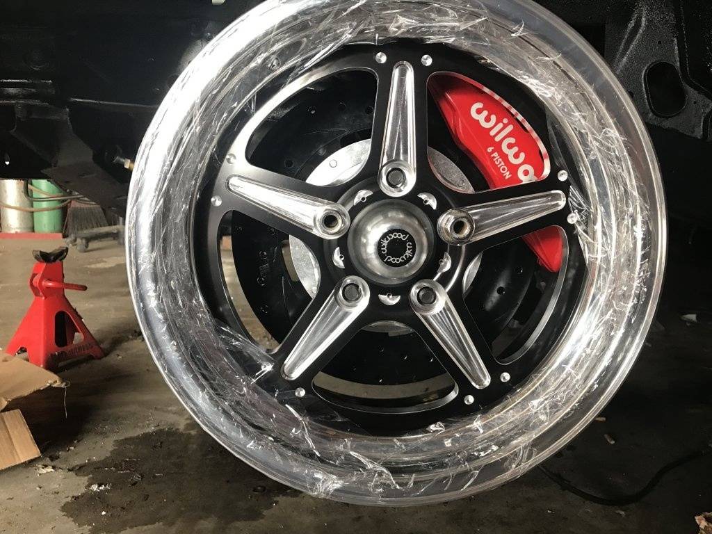

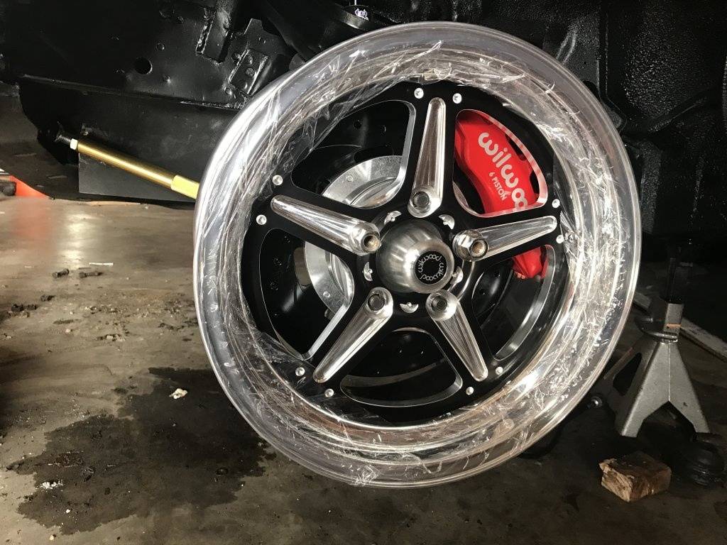

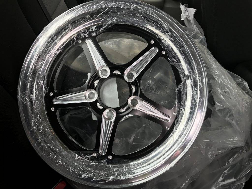

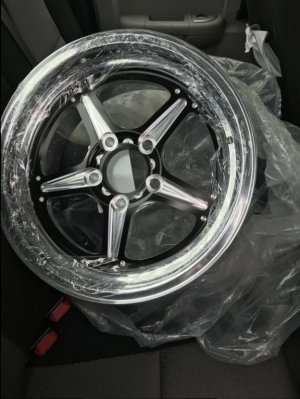

Got a delivery today from billet specialties, what do you guys think? 15x7 fronts, billet street lites I got a killer price on them

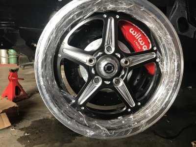

Here's another shot with wheels set on the hub, love the way the rotors fill the space behind the wheel, I gotta save up some money to buy the rears now.
