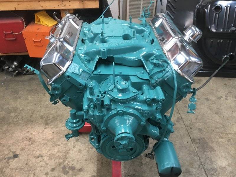

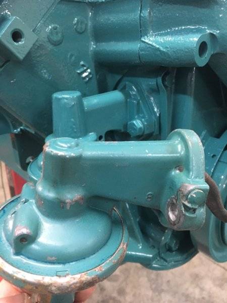

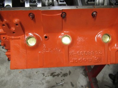

Original part from what I can tell. I had a lot of good paint on the engine to compare.
Local Mopar dealer, Roseville Mopar parts, Summit Racing, etc...

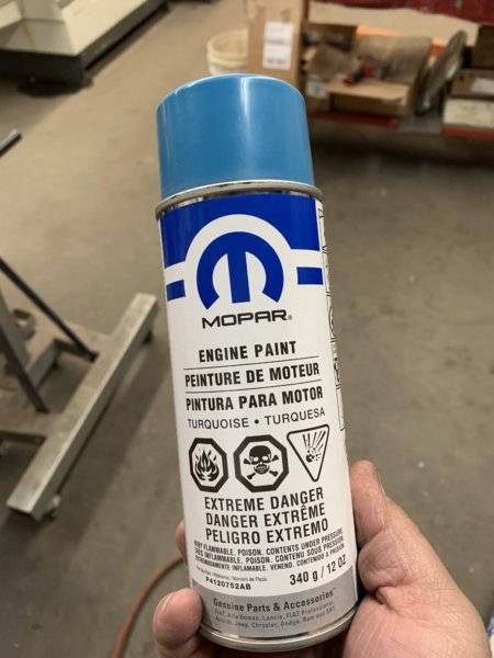

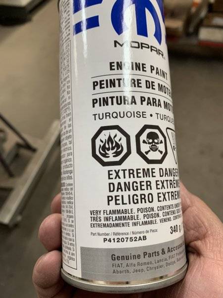

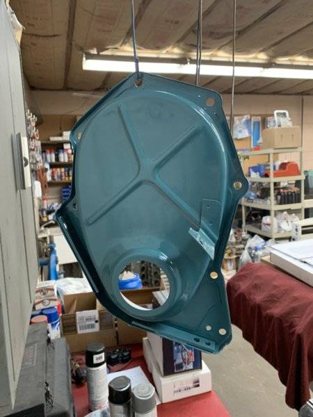

P4120752AB Turquoise Engine Paint. Cap is not indicative of the actual color. Mopar mixes their paints to the original formula so it is correct.

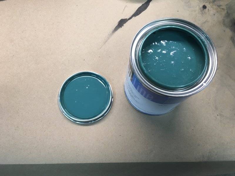

I ended up with Franks paint, which is PPG acrylic enamel.

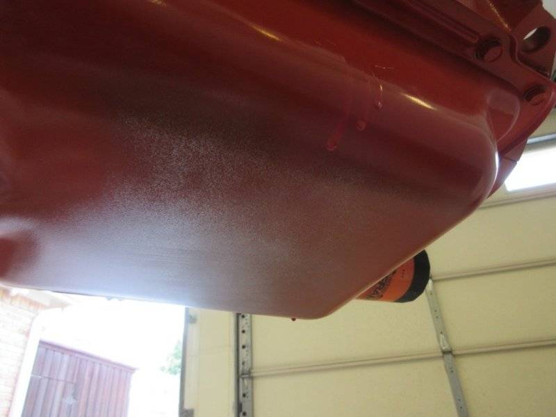

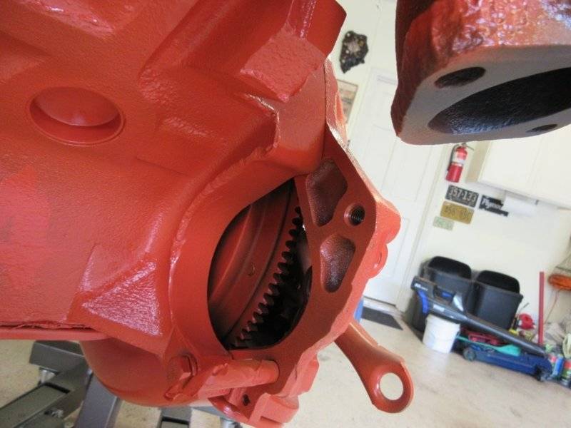

I shot mine with an HVLP gun, but you can brush it with really good results as well. It flows out and the cast iron has so much texture in it, you can’t tell it’s been brushed. That said, a show car finish would have plenty of bare areas on the bottom of the engine and pan, and a spray pattern that replicated the top spray position of a factory job.
Decide what you want for a finished product and apply the paint accordingly

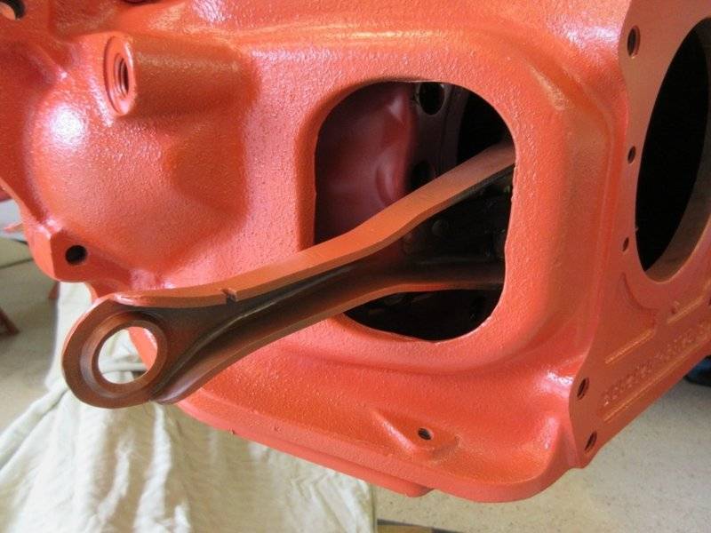

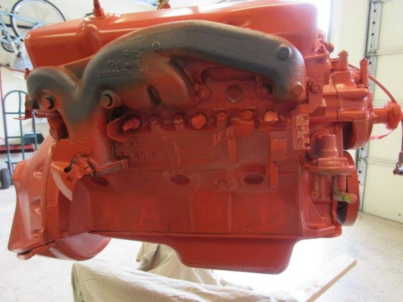

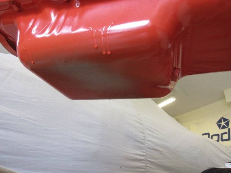

You can do cast iron and touch up thermostat housings/water pump housings etc......and have it flow smooth....
But the flat non cast iron surfaces will not flow out smooth......

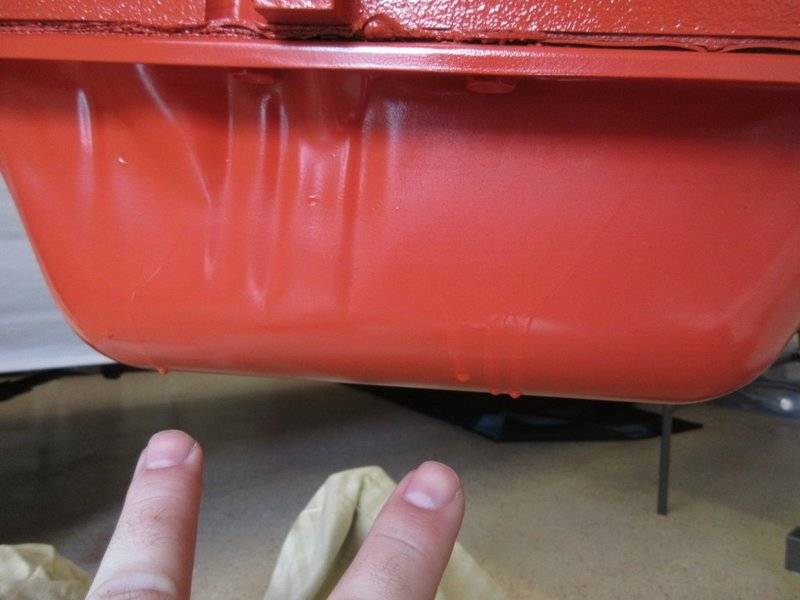

@greycharger cannot supply a picture of a source he "claims" to be brushable and flows smooth on ALL surfaces. Why are you reluctant to supply a picture of something you claim to be nice and it just may or may not? Words speaks inches pictures speak miles:D

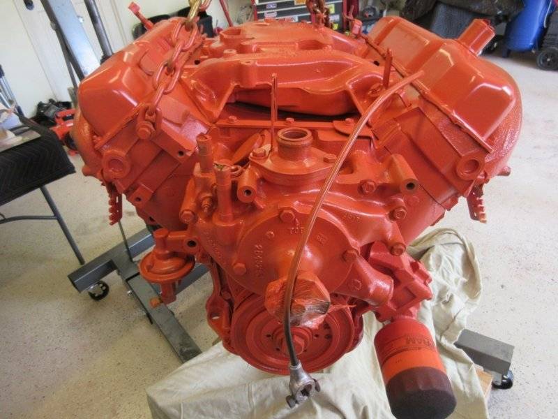

Here is a "Factory job" .....

It was easier to just buck up and pay frank for the PPG acrylic enamel.
