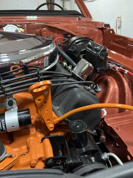

I put in a pertronix II and just one more wire from Distributor to coil. Put black heat shrink around it.
I’ve seen mopar boxes hidden inside the washer bottles that were hogged out underside.

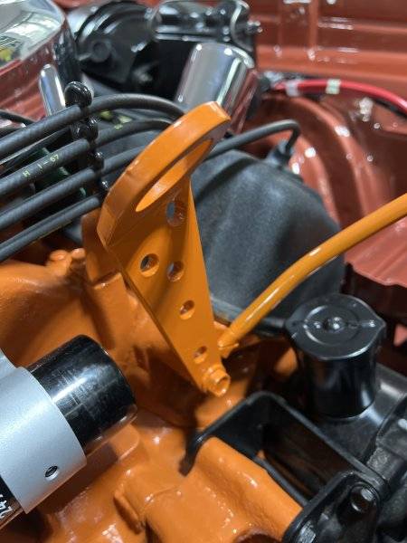

Got a few things at Carlisle- like the correct negative battery cable, hood letters, interior screw kit, rear bumper etc and something I always wanted - the factory lift hook. Figure it will be a good conversation piece
Congratulations on getting all of your new parts, the car still looks great too! And I can’t say I seen that hook on a HEMI before either, so it definitely is a great conversation piece

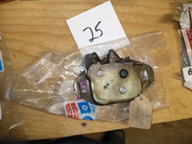

Here's an NOS one, dried grease on it. Have popup spring is black. Oops 25 is a hood latch.

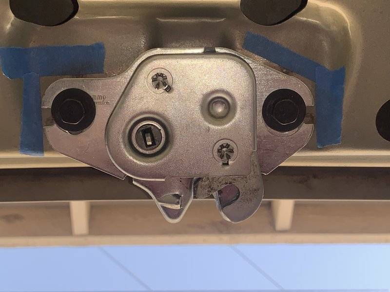

Factory did a lousy job of adjusting the trunk. It's been pinching the weather strip for 59 years. So I moved it down a just a little. Trunk shut much better now.
