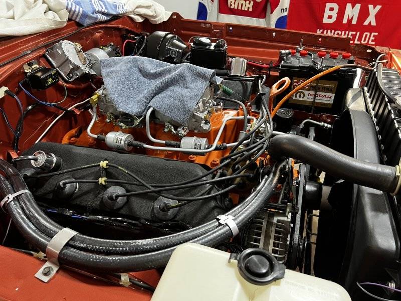

Well- getting close
I had the distributor rebuilt and the cap he put on was wrong- had to find one
One fuel line was leaking, and my rebuilt starter is about to **** the bed
But it wants to go! Lots of spark and oil pressure.
Just need a faster starter - going to put a mini on it for now and change back later
Well- getting close
Hang in there !!!
So the rebuilder put the cheaper non Prestolite cap on it ??
Well- new update. Changed the starter to a mini starter- much better to crank it over.

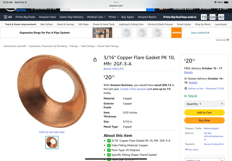

We need to solve the timing issue and the biggest problem- the new fuel line kit is leaking at both carbs, the t block and where is goes into the pump. Not sure who flared this thing ….
I'll second what @AR67GTX said. Usually tightening and loosening several times will do it. And lean on the line wrench too. New fittings need some "oomph" to get them to seat! :thumbsup:

Lots of smoke in the garage - combo of the oil in the motor from the priming that was done on it- then when that cleared - it was the painted manifolds - ha
