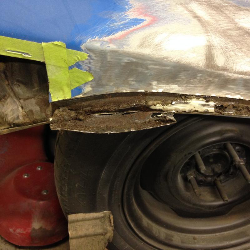

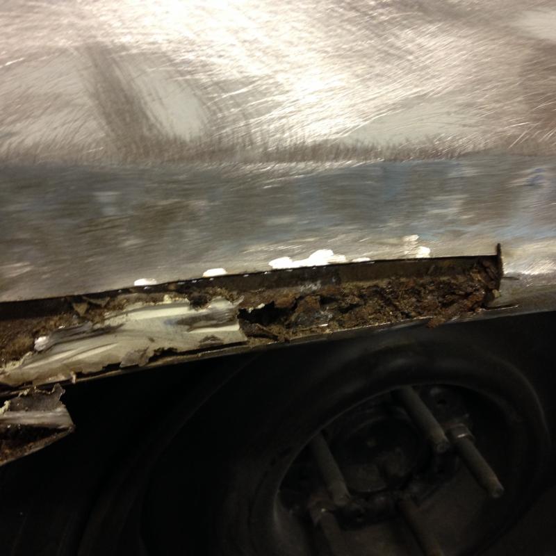

Rear quarter
could you post pic on your wheel arch process,I need to make some too but not having much luck.Scarebird sells fr. disc brake adapters and you just find the rotors etc. from wrecking yard or buy new.They give you a list of what you need but they will not work with 14 in. rims
Thanks for the info. I will post some pics of what I did on the rear quarter on the left and what I am going to do on the right. Depends where the rust is. Behind the rear tire well the AMD panel is prett y nice but does not help if the wheel arch is rotted. Mine has both areas gone. So on the right I am starting with the AMD panel and now looking for an arch out of a 4 door satellite. If that does not work I will get a sherman and rework the arch and cut some of it out so it fits then weld in the pieces to get the arch right . You will need a metal bender and stretcher. You can get a paor for about 150 at Harbor freight that will work good enough. Anyway will get pics together and post.

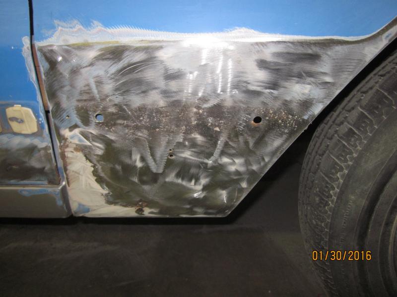

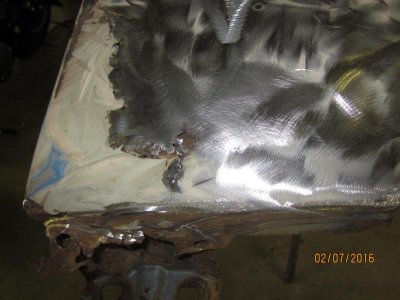

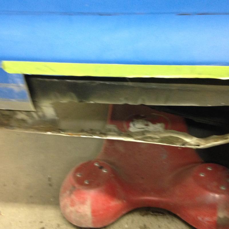

Nothing left in the front lower fender - the metal stops the rest pure bondo. Up higher along where trim goes those are all small pin holes filled with bondo

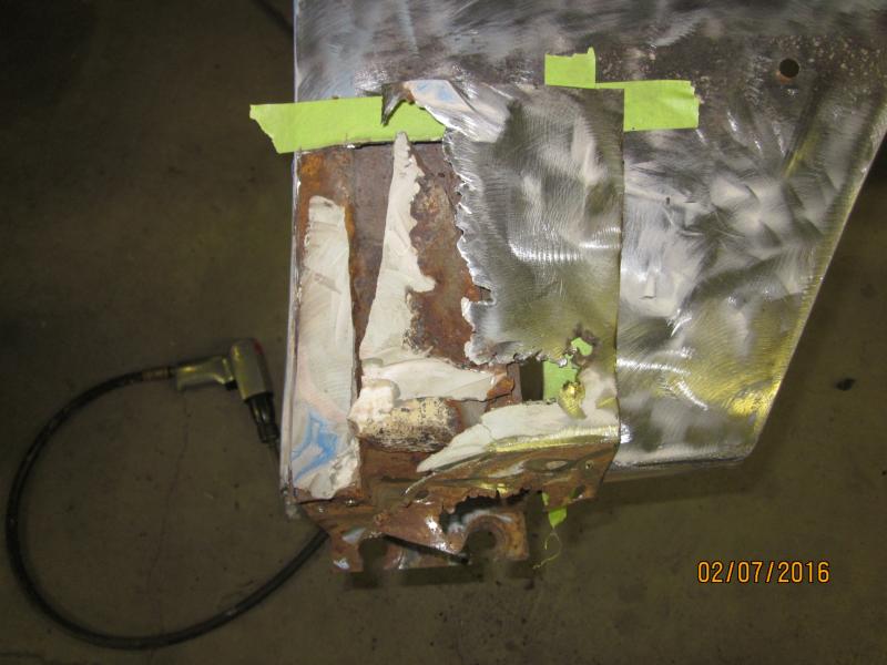

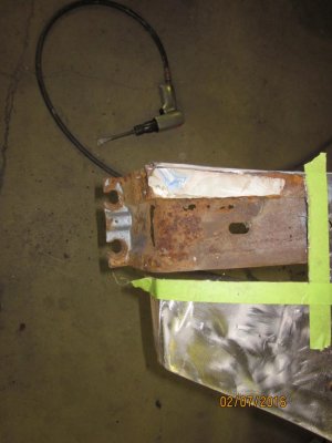

as you can see the end of the panel is all bondo. I will bet this car will be 500 pound lighter when I am done. Anyway I thought I could skin this but the lower portion on the leading edge of the fender support is all rotted out out. So the inner support would be hard to reproduce so Is there any source for a inner fender support or a source for a donor fender. Will a 1966 Coronet fender be the same for the lower rear section of the front fender? What is the difference in a 1966 coronet fender and a 1967 satellite fender? I call lots of places trying to find a reasonable front fender and have had no luck. Any suggestions or tips would be appreciated.

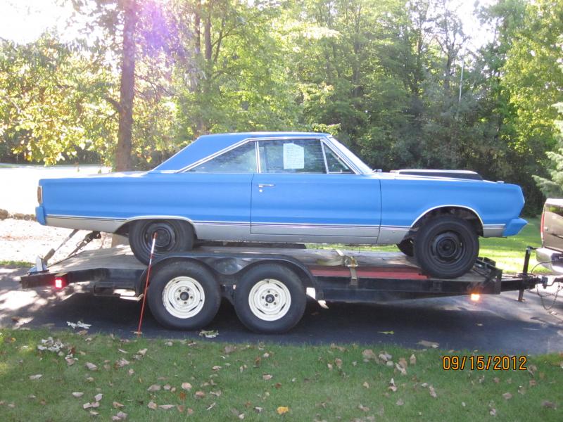

This is what we started with. Lots of bondo under all that blue = More than we thought - no engine or trans ,

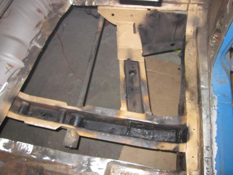

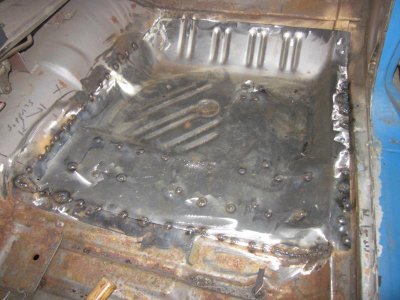

Frame had allot of rust - used a Safe T Cap to repair. The torsion bar cross member when it is welded to the rocker panel was rotted out . The repair was welding 22 ga sheet metal to cross member to the rocker panel - smoothing it out with bondo then coating with tar. So I cut all that out and repaired it properly. Then cut and trimmed the floor pan that was rotted out and butt welded it in. This is not quite finished yet. Took me about 15 hours to just get this much done. I thought this was a fairly solid car but sure got lots of metal work to do and gallons of filler to cut out and do the proper repairs. Sure wish more parts and panels were available for this car. The process would go allot quicker for sure -

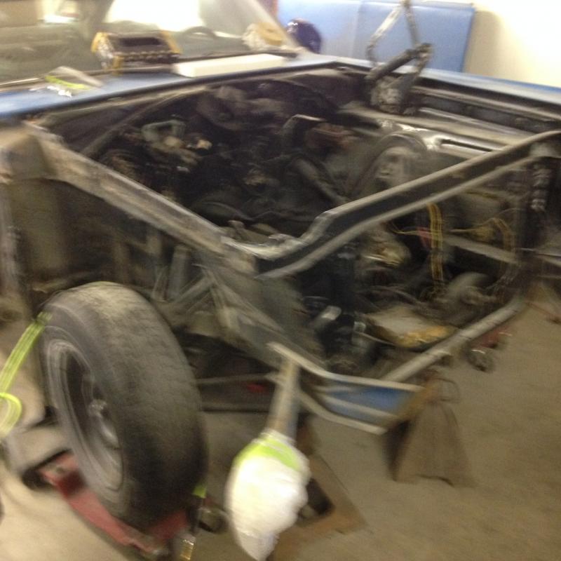

Started to cut out bad metal from the rest of the quarter. Once I get the worst out I will fit a new piece in and cut this up a bit to get a good fit. So Far I only have a AMD patch panel but that does not cover the wheel well. Also will have to fab some of the inner fender. Also in pic I removed the right front fender . The lower corner is rotted out as shown in a previous pic. I did find a 1966 fender to cut the bottom rear off and weld it to my 19767 fender - thats this week ends job
