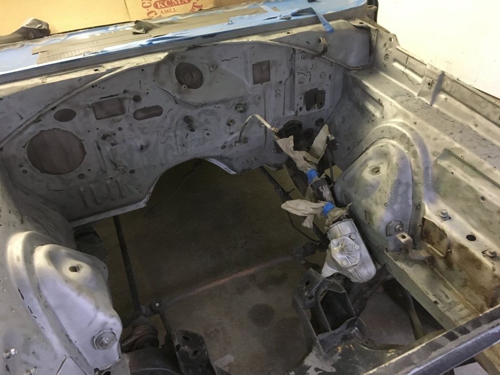

Thanks for the pics - I am not building a show car but a darn nice driver. I appreciate the list of details and costs . My concern is what you described.
pur in a bunch of bucks and not work right - v get a kit for 1/2 and it works. I will have allot of welding on the firewall patching in all the factory aiir AC holes plus the inside return air openings too. Nothing I cannot handle tho. based on what I see I can sell off a bunch of heater parts and ge some bucks - Not sure what to do but getting close to knowing what I want to do - Almost all sheet metal is repaired (quite allot done) so next is heater ac box then dash then I can get class back in etc.
pur in a bunch of bucks and not work right - v get a kit for 1/2 and it works. I will have allot of welding on the firewall patching in all the factory aiir AC holes plus the inside return air openings too. Nothing I cannot handle tho. based on what I see I can sell off a bunch of heater parts and ge some bucks - Not sure what to do but getting close to knowing what I want to do - Almost all sheet metal is repaired (quite allot done) so next is heater ac box then dash then I can get class back in etc. View attachment 386940
