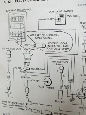

Here are a couple of pics from a 69 service manual. I would think 68 would be the same. Dash lamp wire goes to Z in bulkhead under dash. The other side is your harness that goes down to the back up lamp switch on the tranny.

68 is definitely not the same. The Z port shows dark green for left turn. I have a 68 manual in front of me. I converted the one to a 4 speed and it has an auto plug in it with violet and white but nothing goes to the bulk head. Neither car does in fact. I’m beginning to say f*^% reverse lights!

Its almost like they didn’t plan the light out for interior because it was a half year deal and then switched **** around in 69.
I guess that is why '68's didn't have a dash reverse light ! Your actual reverse lights though are wired through D and C the same as '69.
Wire up the A or B to the dash reverse light... and call it done.

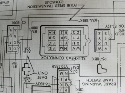

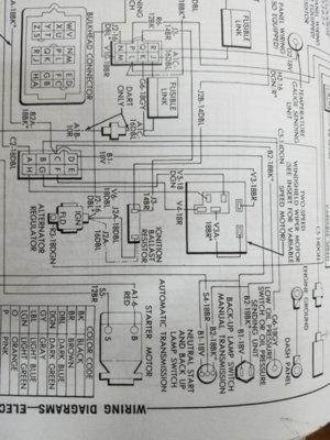

Looking at the '68 wiring diagram.. it appears they took the wires directly from the door A pillar connector to the trans switch. White wire is feed... violet out of the switch to reverse lights. dotted lines shown to the firewall bulkhead D and C for both.. so I bet Auto's went the way the wiring diagram shows and manuals got the extra wires shown as dotted... You switching from Auto to manual in both cars??
Nope the runner yes. The charger has a new harness and I think it was replaced with an auto type when it was done because my buddy didn’t know any better. I found both auto style plugs about 5 minutes ago so I can send them into the bulkhead. Holy **** this under dash work sucks! :D

These are the purple and white wires in the harness I found wrapped up under tape. I think this pigtail is on all harnesses that are aftermarket, and if its a 4 speed then you pop the end off the leads and stick them into the bulkhead in C & D ports. I think they go to the neutral safety switch maybe on an auto car? Anyone can comment if I am wrong but that's where I found the wires taped up. I will make these work and then have reverse lights again on both cars!
You are correct. I took the female terminals out of that plastic plug shown in the picture above and then I undid the bulkhead from the firewall and dropped it down into the car. I was able to insert the female terminals into ports C&D on the bulkhead and then reinstall the bulkhead in the firewall. It took about 15 minutes so I’ll do the same on the road runner tomorrow and all will be fine. Thanks again!
