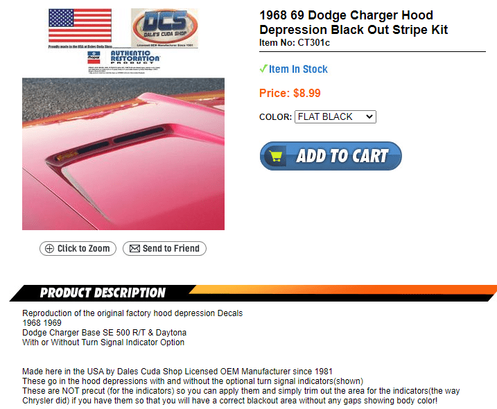

Hey guys, bought a set from DCS and was wondering how you cut the centers out assuming you apply the sticker 1st and then cut it out on the car. I'm guessing that's how it was done by cutting an X in the area.
I am not understanding what you need to cut. Mine came from Pheonix Graphics and all six pieces were pre-cut to fit.
Mine was from Performance Car Graphics and was the 6 pieces also.. I believe that only the stripes that ran over the marker light openings were "X" cut.
DCS sells them as they came from the factory back in the day. They're not pre-cut into 6 pcs but come as 1 long piece per side.
there rounded on the ends, x cut is if you have turn signal indicators, so you can put them in after you install the graphics
There will not be enough material to "X" cut the openings. I would cut them about 1/8" to 1/4" long on each side of the opening and install the turn signals.
Thanks. That's what I was thinking as well. They delivered today so I'll be installing on sat.
