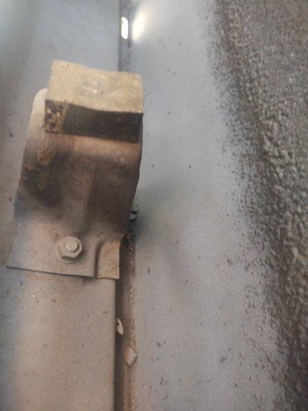

Yes I have those brackets on my original power window 70 Charger
So what are you wanting to know?
I’m at work now but I’ll post a picture for you tomorrow but by the sounds of it you know what you were looking for

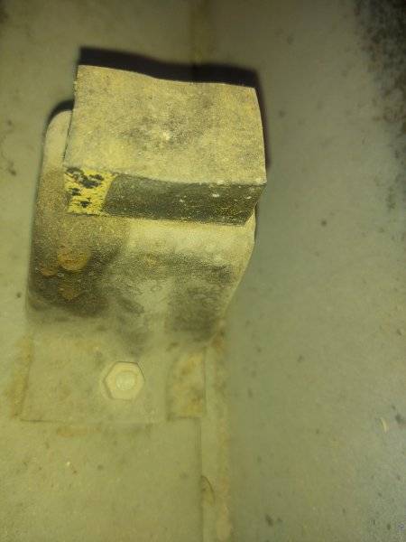

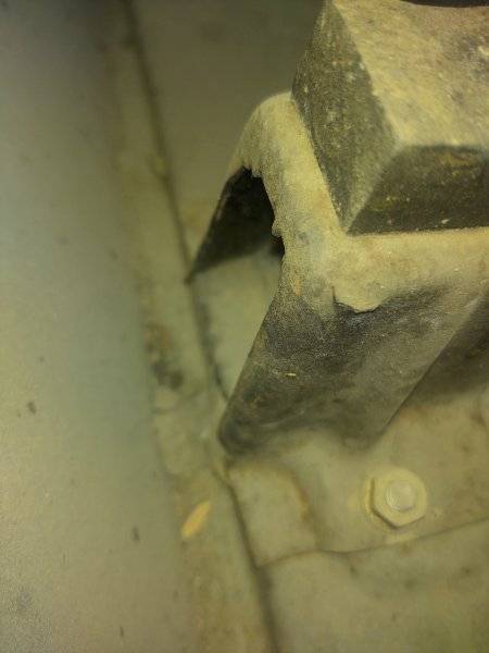

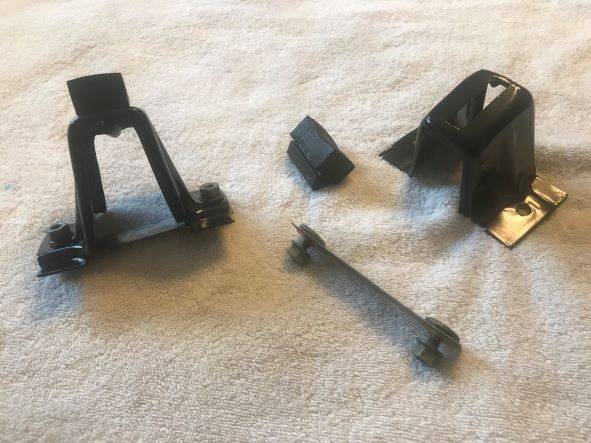

Here's a picture of the said window stops/bumpers brackets.
6PKRTSE
7:57 PM
Nov 15, 2010
2,822
4,677
Motor City
My two 70 Chargers are both power window cars. Mine do have the stops. Sorry, no pictures of them apart though.

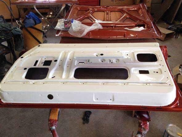

Right about there.
Look how they cut out the hole for master gang switch. I thought someone might have added the power windows later in the cars life but found out that's the way they hacked the hole bigger at the factory. Just another car at the time. Next lol

Yep. My car looks like an angry beaver chewed his way through the door for the switch.
