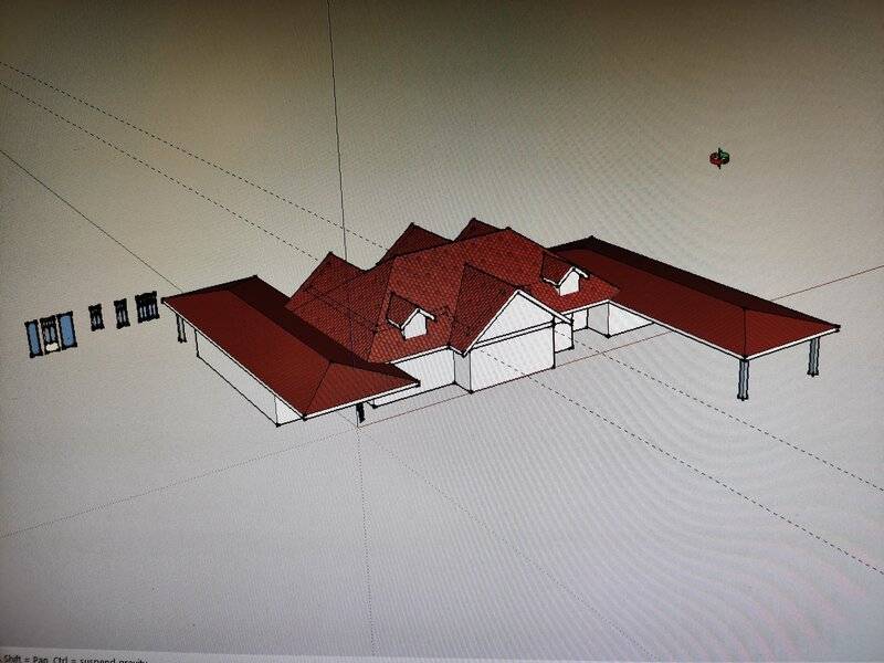

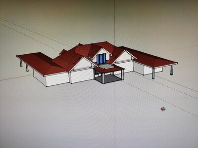

Wife projects! My wife wanted a larger deck, OK dear. So I added a 30' x 32' deck with a 28' x 28' garage under it. Win Win solution.
Well, I talked her into extending the roof on one of the extensions to have a 3-car carport so I guess sort of a win-win? The extentions are the two lower pavillions on each side in the 3D rendering. The bottom picture is how it looks now.

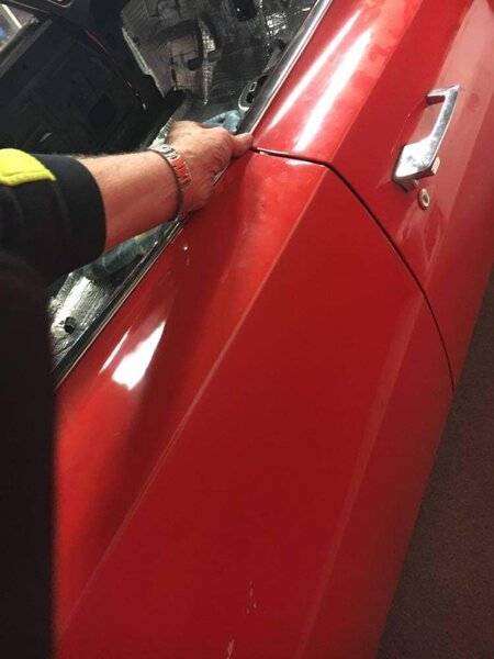

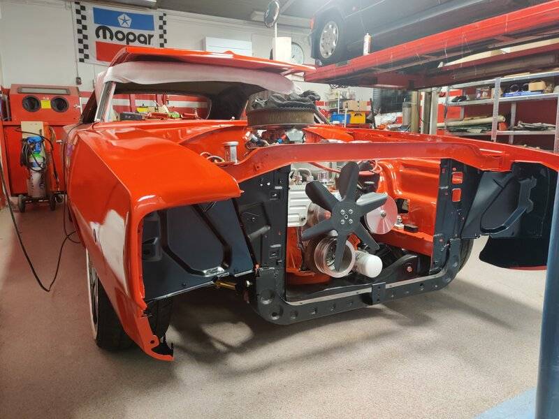

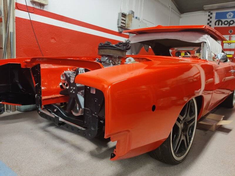

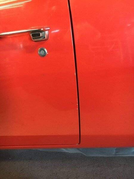

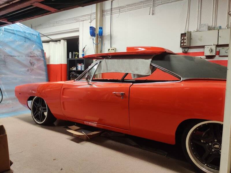

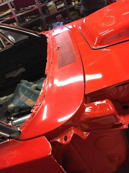

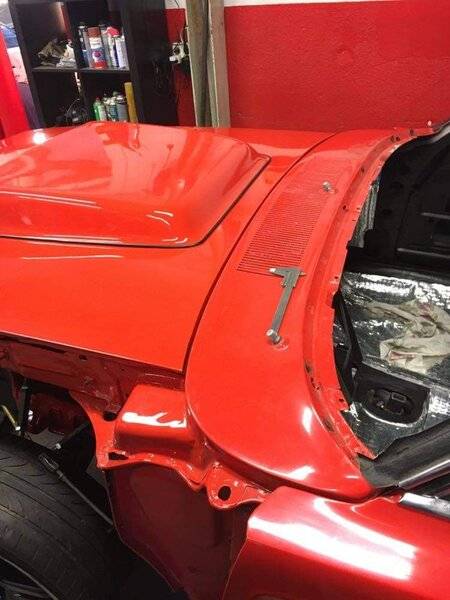

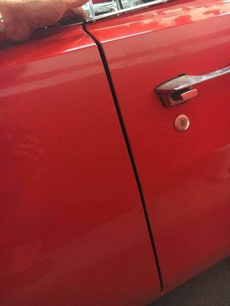

Removed the masking and hanged the fenders just to have a look. Alot of adjustments to do.

Thank's Funknut! But I have to disapoint you on the quality of the paint job! It looks pretty ok from a distance. But, bear in mind, this is just for making it decent enough so I can get the beast on the road and test everything out properly. After I'm pleased with it all I'm tearing it down to have a shop do a top quality job on all panels. I'm also probably removing the vinyl top to have the roof painted instead. I think this color looks better without a vinyl top.
Can't just wet sand and buff? Looks awesome from what I'm seeing.
Might be possible. The dust came when I sprayed the clear coat. The base was almost dust free, not sure why though?

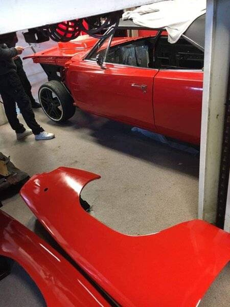

I thought it was going to be a standstill when I'm abroad but as it turns out my father and a friend of his has started to align doors and hood so far! I'm truly blessed having this help, very thankful!

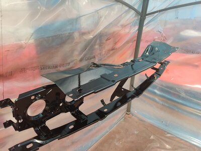

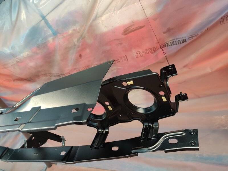

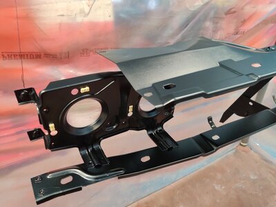

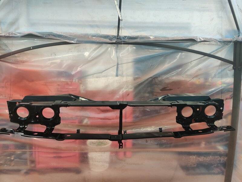

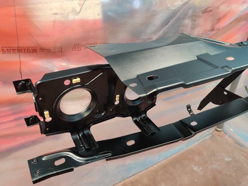

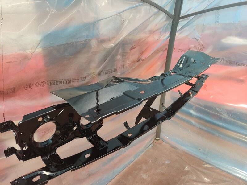

Took on the dreadful work of sanding down and re-spraying the grille frame again. If it's not satin black this time I'm gonna go ballistic.

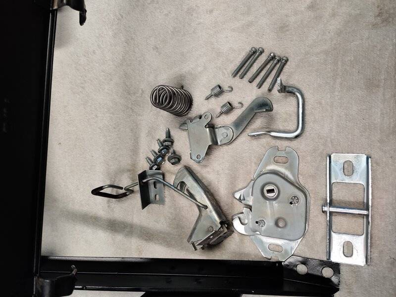

Zinc plating stuff again.

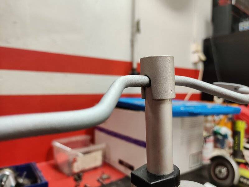

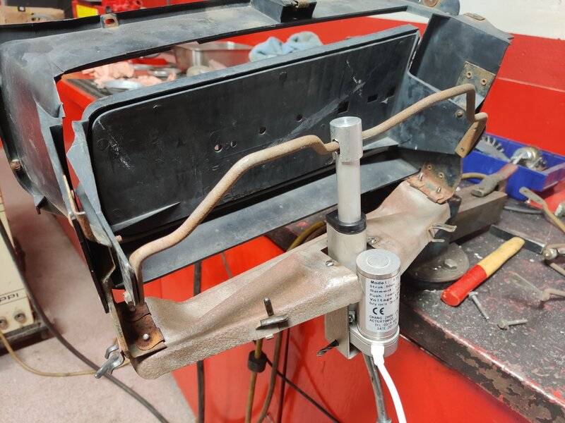

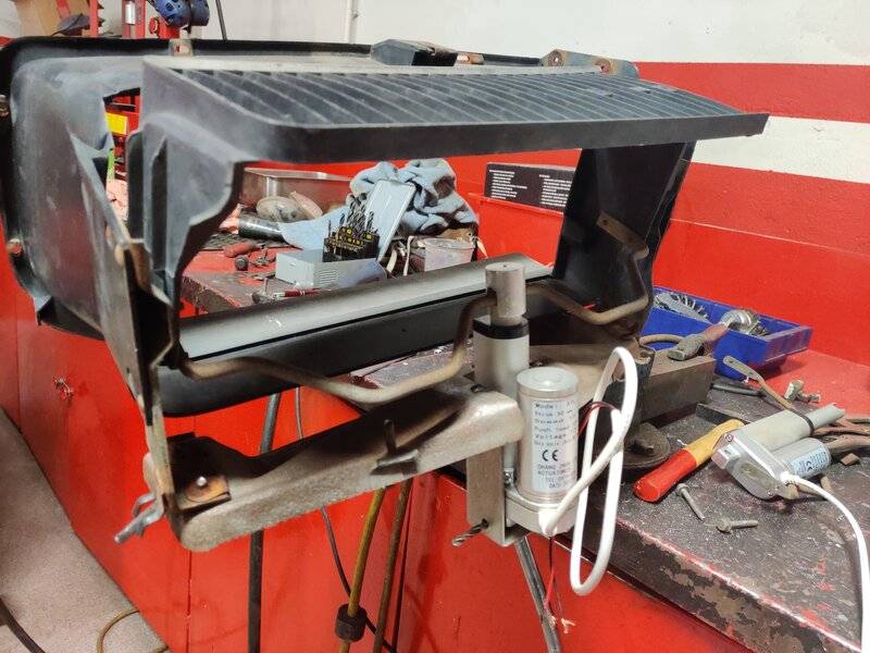

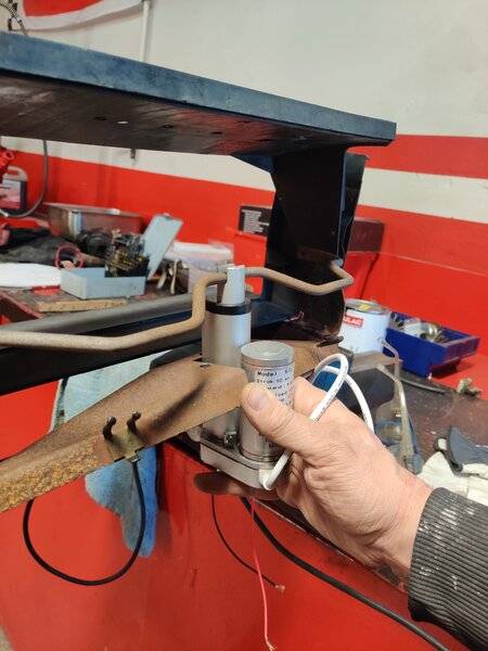

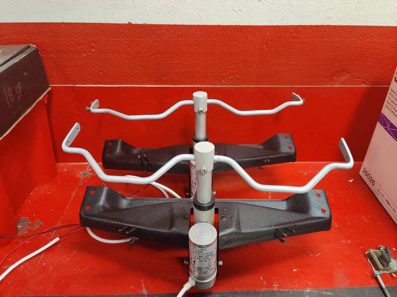

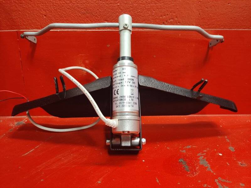

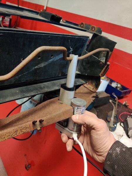

Started mocking up the electrical motors for the headligt doors. When I bought them I didn't have a clue what stroke to chose but ended up with chosing 50mm. Well, it fit really good and the stroke was spot on. Pure luck.
Fabricated some brackets and cut up the original one to make everything fit.

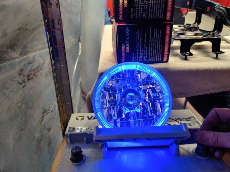

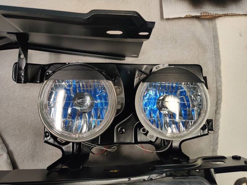

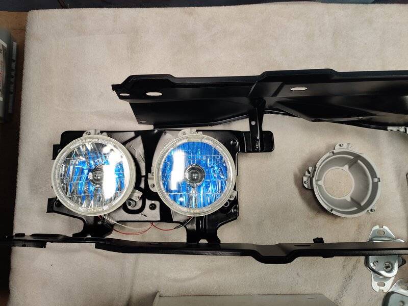

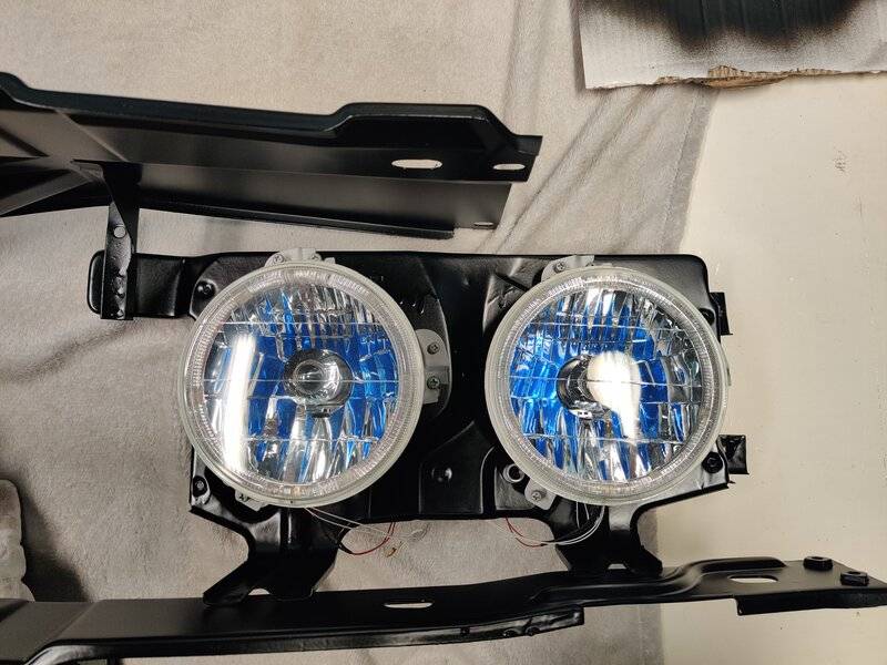

Trial fitted the headlight brackets and the zinc plated fasteners together with some H4 headlights that I've had on the shelf for atleast 13 years!
Let's just say I wouldn't chose blue halos today.. not really my cup of tea anymore!:wtf:
I'll probably wire it to a button just so I can turn them on when I want to look cheasy.

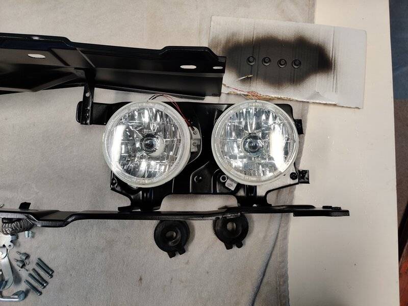

But the light itself looks ok. I need to enlargen the holes in the brackets slightly, too tight fit as it is.

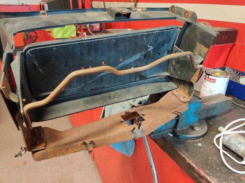

Adjusted the light buckets to fit the H4-lights.
The rings holding down the lights were to small so I'm gonna ask a friend to 3D-print something.

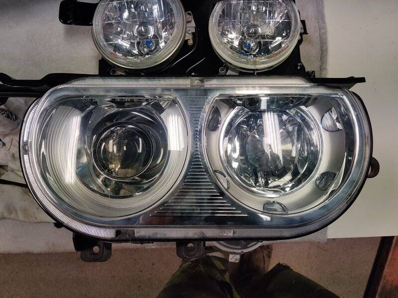

I like the mean look of the new Challenger lights were the upper part is cut off. Wondering if it would look good with having the holders covering the upper part of the lights?
Made some brackets for the electrical cylinders and welded them in place. Looks like it could work.
IMG_20210222_191448.jpg IMG_20210222_191510.jpg IMG_20210222_192339.jpg IMG_20210222_192321.jpg IMG_20210222_201748.jpg IMG_20210222_201855.jpg IMG_20210222_201900.jpg

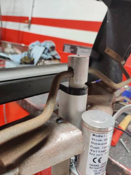

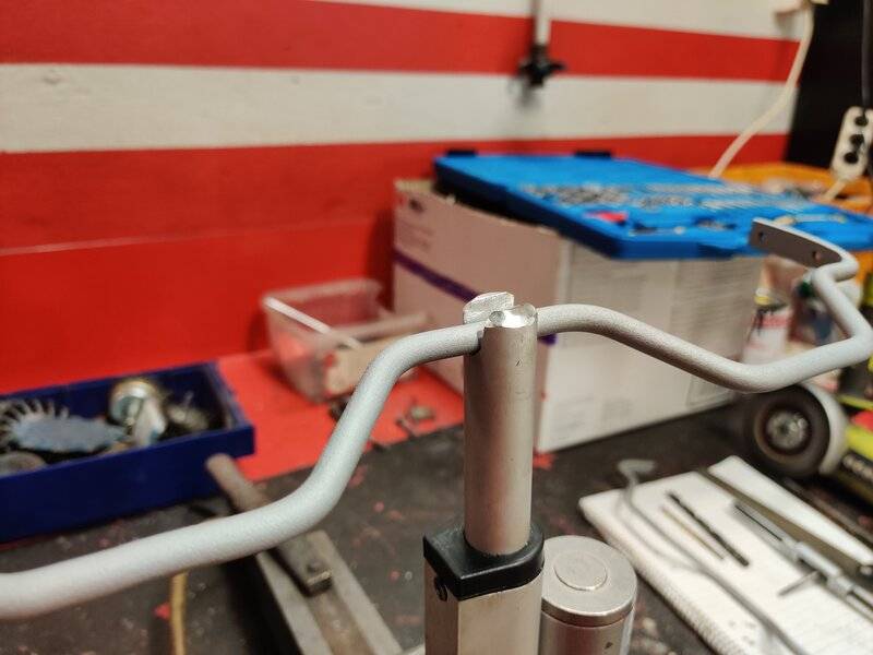

Door actuators completed. Did some "cups" in the lathe to secure the door levers to the actuator rods. Drilled, tapped and secured the "cups" to the rods with some small (metric):wtf: screws.
IMG_20210301_202104.jpg IMG_20210301_202032.jpg IMG_20210302_193919.jpg IMG_20210302_194259.jpg
Love it! I thought about trying something like that but both of my actuators still worked so I said piss on it lol. If they ever fail I'll have to remember this.

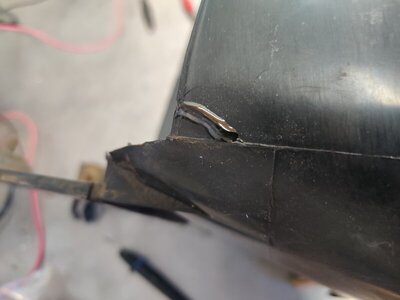

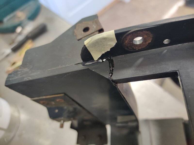

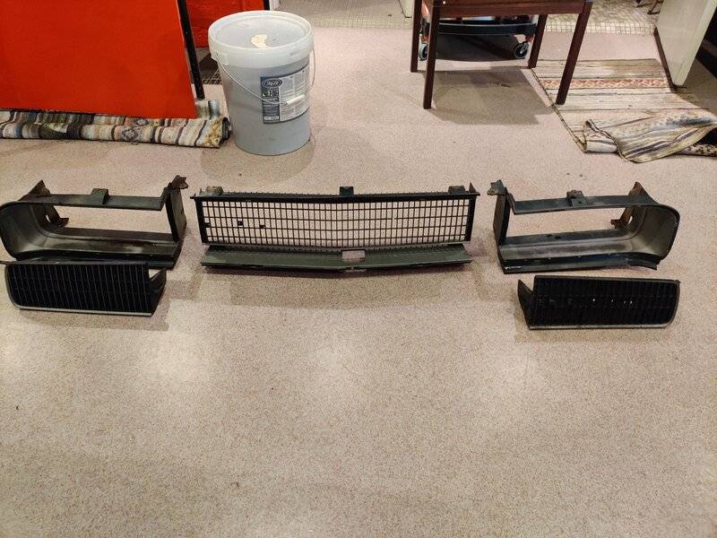

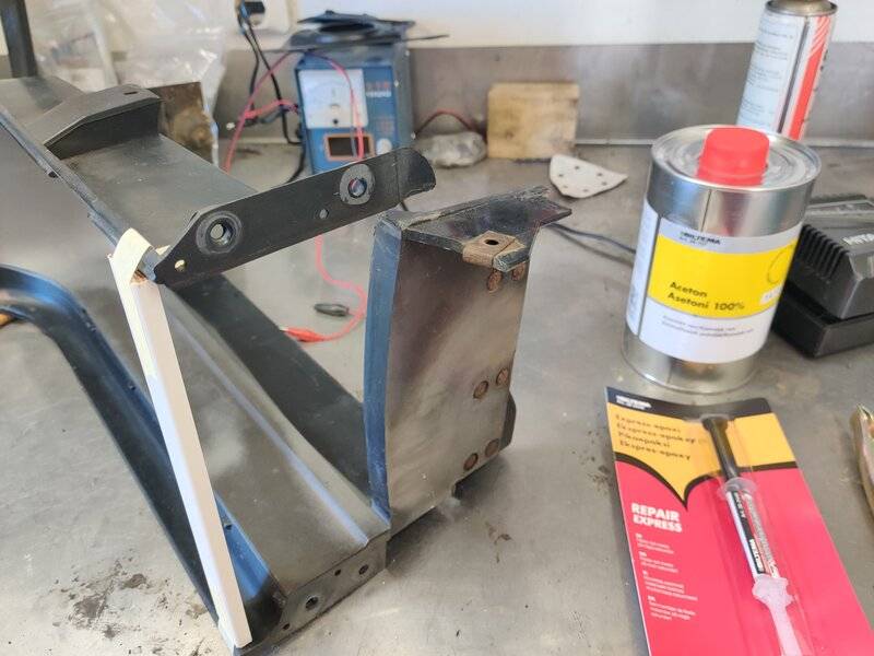

Started repairing the plastic grille parts. Old and brittle stuff! First a good clean.

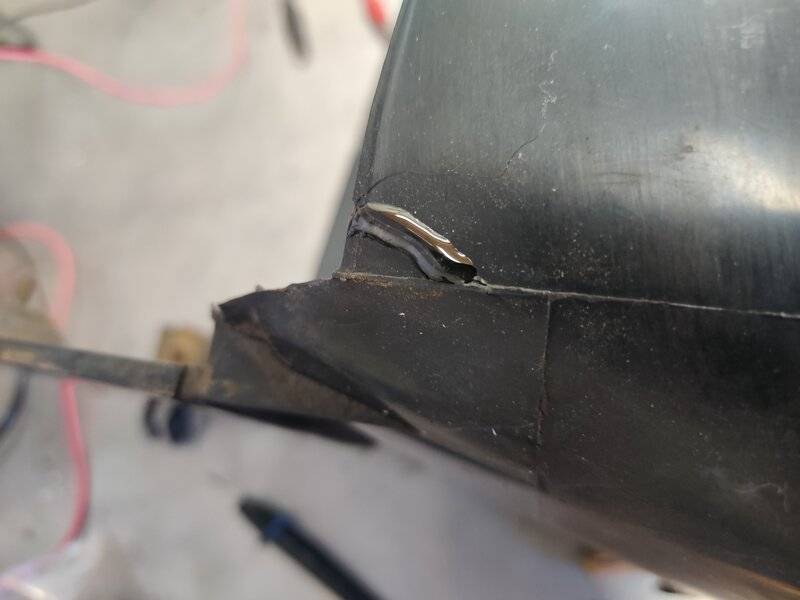

Used the dremel to make a v-shaped groove in all the cracks I could find and tried an epoxy-glue. Let's see if it holds up? Does anyone have good pictures and measurements on the side tabs that tend to be missing on most grilles? If so, feel free to post it here. Going to try out the "Lego and Aceton" method to fabricate all missing pieces I might need.
