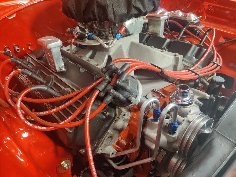

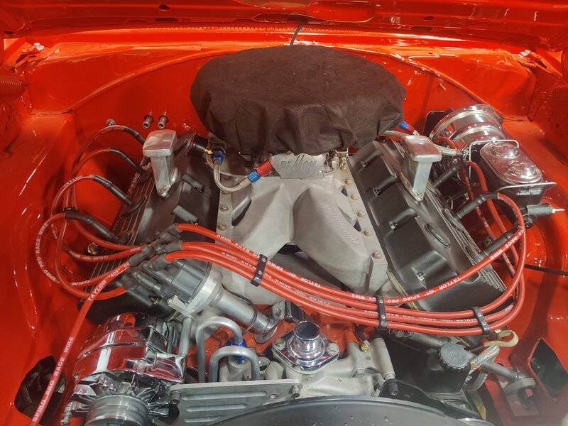

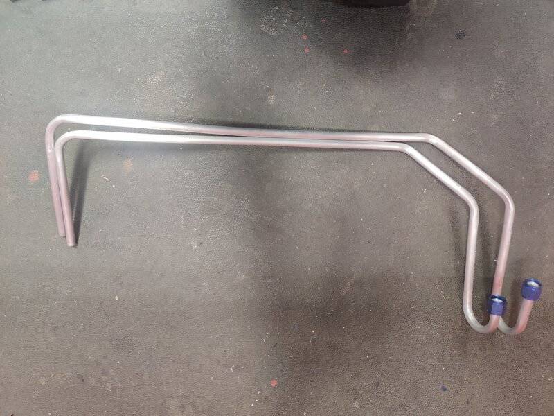

Two water pipes in place, but how on earth I'll be able to tighten the hose clamps between the firewall and the valve head is a different story. But it will be stealth.
Don't see a small flare where hoses go on those beautiful tubes. Sure wouldn't want one of those hoses to pop off.
