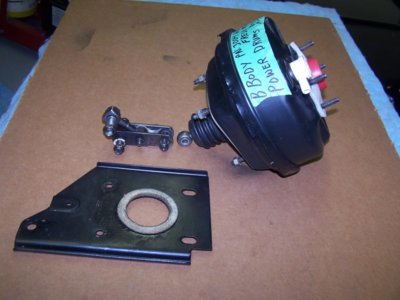

how do i do this any tech help appreciated,,,need a booster for drums ,,,plus do i need a diff, rod to m/c ,,,,help please thanks ,,,studs on engine comp.,,,nuts by steering colum,,,,,going to carlisle i hope what do i neeed thanks to all for help mark in ohio
You need a power booster mounting plate for the firewall and firewall seal to replace the manual one. You also need the specific PB linkage from the pedal to the booster. Pedal is the same.
Have you thought about making it a manual disc/drum?

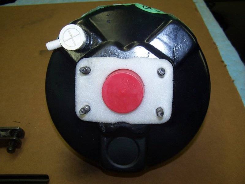

These parts would be all you need for drum brakes. I had this booster rebuilt for my 68 Charger then upgraded to front discs. I have $300.00 invested in it.
