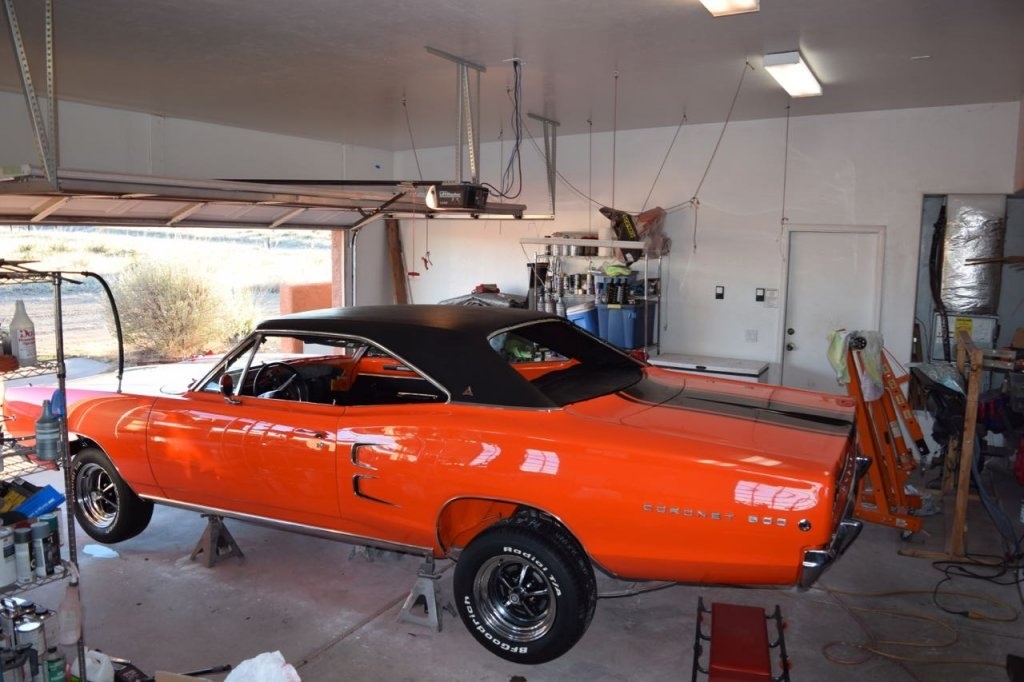

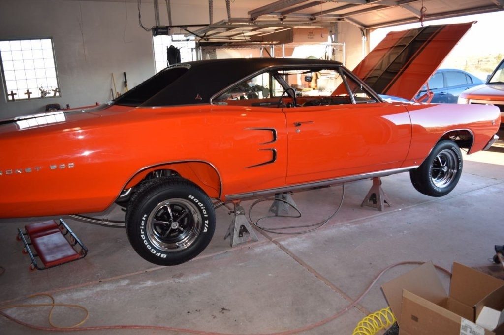

One other bit of trivia the LF tire I believe is the original Firestone spare

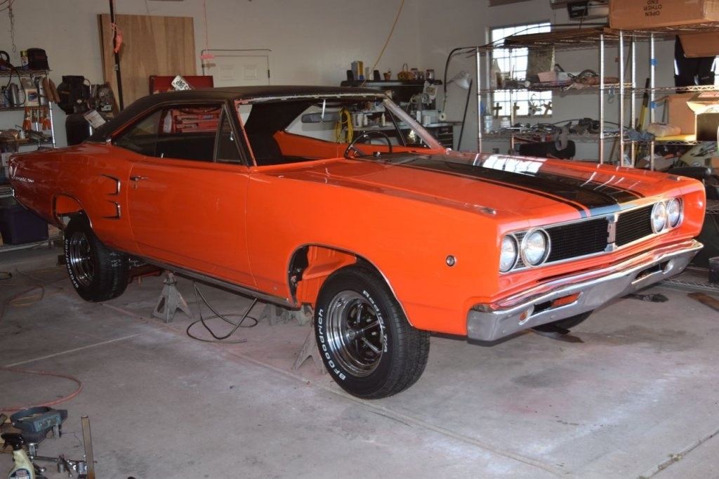

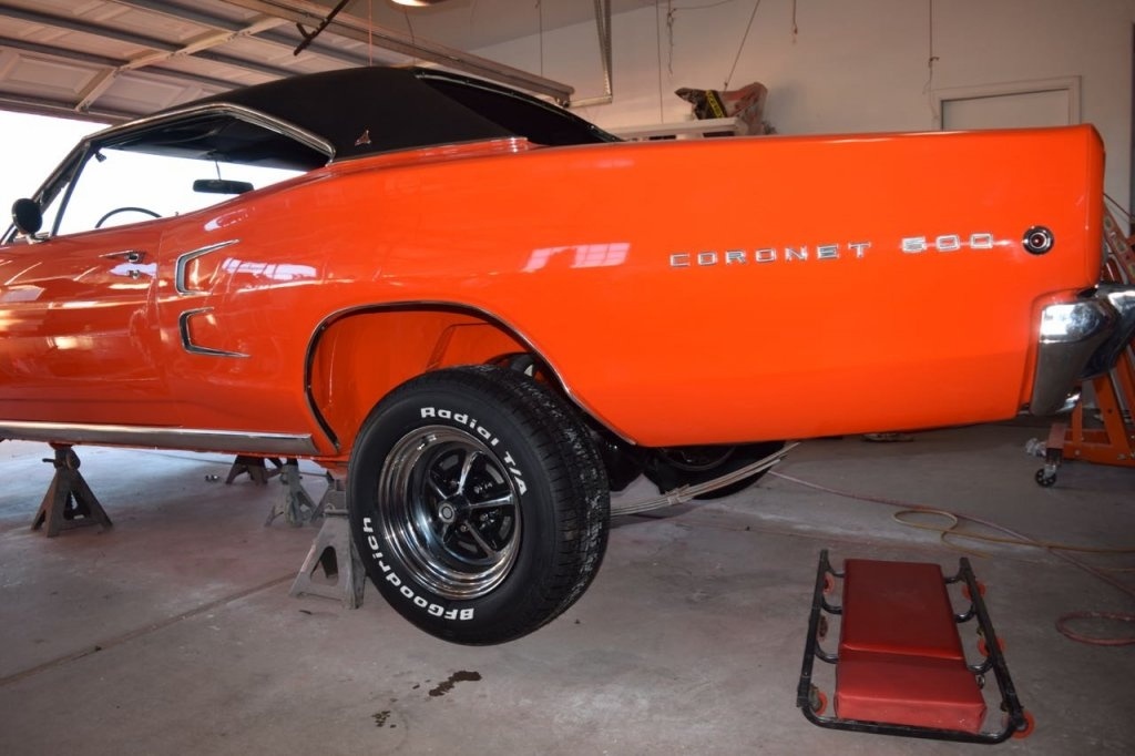

X2. Btw those magnums really look nice. Good choice.
No matter how many modern rims I look at when I see a pre-70 car with Magnums it just works it is just a classic design that will never go out of style.
Looks nice! What width rims and what size tires?

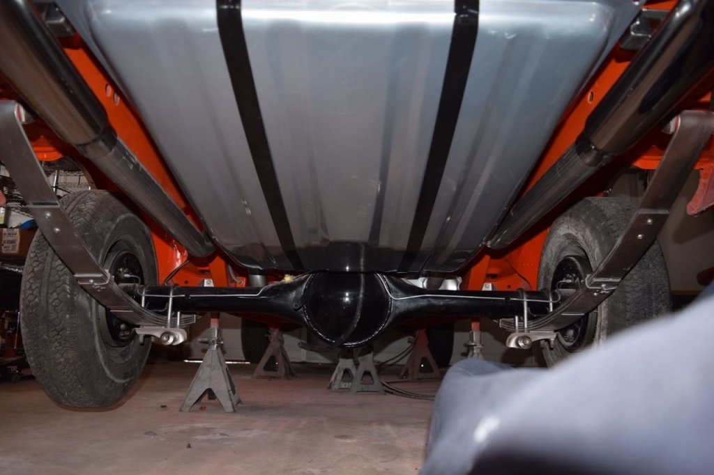

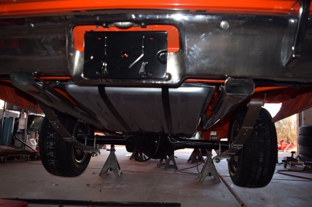

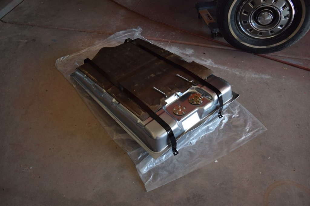

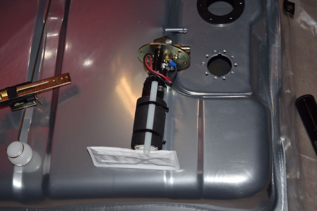

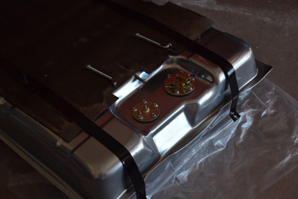

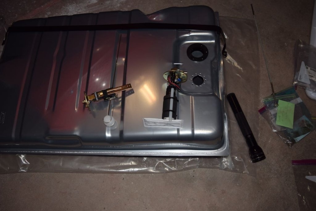

Got the Tanks Inc stuff ready to install. Lesson learned by others here is take the advice of the instructions and use Permatex Aircraft Sealer on the gaskets. They look like they would not leak but several here are proof they will. Also got the tanks straps painted and the original tank pad out.
View attachment 393341 View attachment 393342 View attachment 393343 View attachment 393344
Although it is too late for your build (for anyone reading this), Bouchillon Performance makes an intake fuel pump that is in the original style of the fuel tank. Their system uses the original tank and the sending unit is replaced with the fuel pump and wiring. Theirs is ultimately designed for a Gen III Hemi swap but they should work with any fuel injection system.

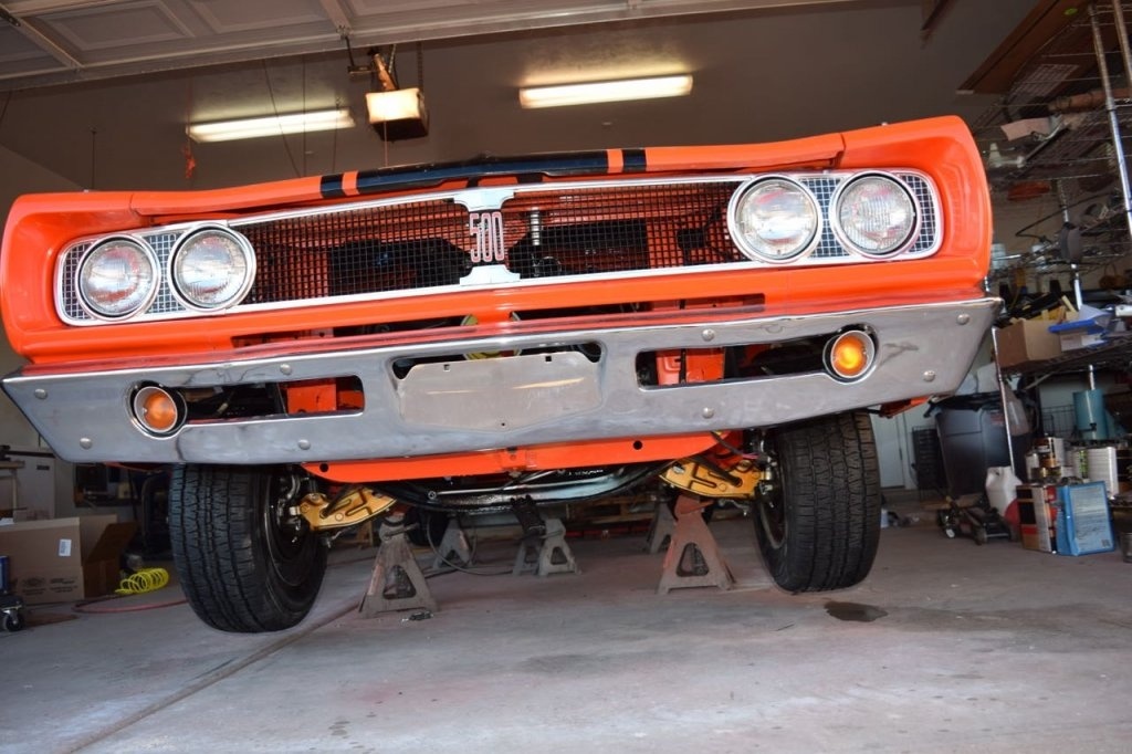

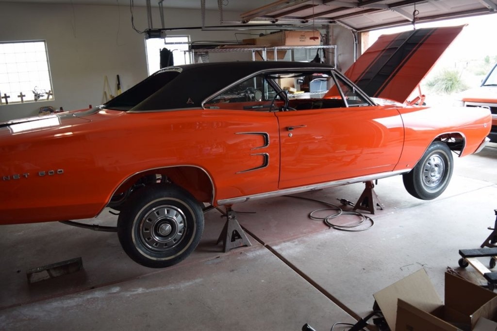

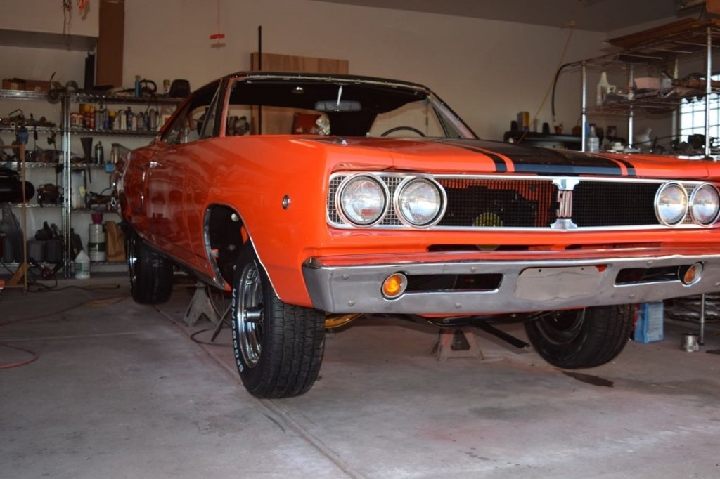

Looks stunning Jim! How long until that piece of art is rolling down the road?
Are you crazy. That would get my tires dirty!Lets see that bad boy on all fours!!
