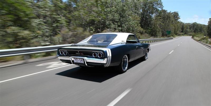

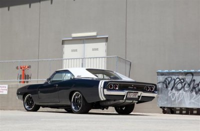

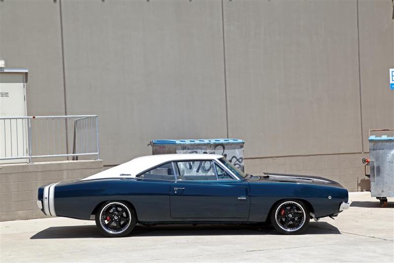

here is some more photos from the magazine shoot that I was lucky to have done here in Australia, enjoy.
Great job, looks like allot of fun to drive!
Great car it's simply amazing looking. I really like the Mopar emblems in the wheels. That's cool.

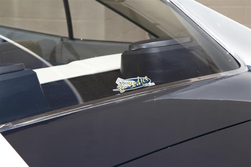

Great photos Ben. Gotta love the B-Bodies sticker on the rear glass.

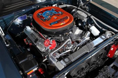

That is one sweet Charger Benno, I'm going to have to go back and look at my thread where you posted your wheels "really like them". Love the steering wheel, dash and air filter "cool car".
very nice ride there. would like more info on you dash. close up pic and who did resto? beautiful car.............

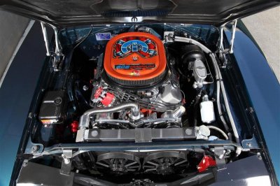

You have one gorgeous car well deserving of a photo shoot. Still love the air cleaner lid.
Some very cool custom work there Ben, and congrats on the magazine shoot :headbang: Love the FBBO decal :)

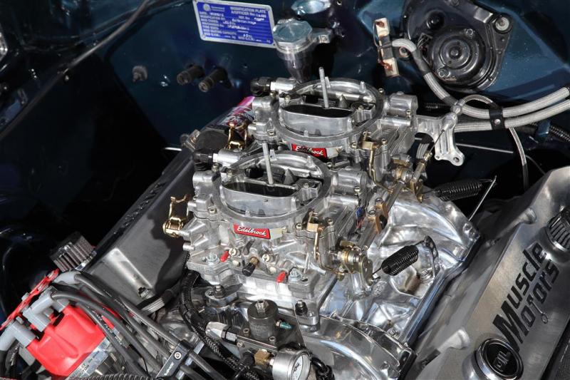

thanks guys, Dash and resto done by myself. here is a build sheet also for anyone interested. thought I would share since I had to for the magazine anyway.
ENGINE
Engine Type: 7.2L 440 Wedge, now 8.3L 505
Sump: Milodon 7 Qt road race pan

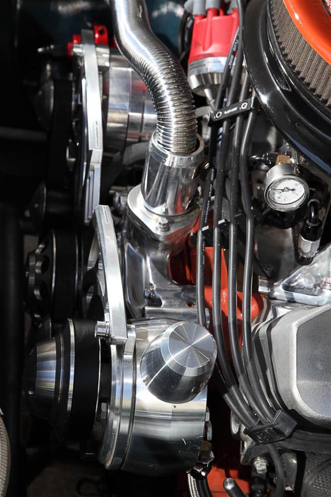

Crank: K1 4.25 stroke Rods: RPM H-Beam 7.100 length Bearings: Clevite Rod bolts: ARP studs Pistons: Keith Black ICON 26.7cc 4.350" forged Rings: RPM Compression: 10.1 Camshaft Brand/Type: Lunati, Hydraulic 300/305, [email protected] Lift & duration: .540 lift, 300/305. 252@ .50 duration Pushrods: comp cams magnum 3/8" Lifters: cam matched lunati micro-trol Rockers: comp cams roller rockers 1:5 ratio Cylinder Heads: Stealth 80cc Port work: yes Valves: comp cams stainless Valve Springs: lunati double valve springs Collets & Retainers: comp cams 10 lock Gaskets: cometic and felpro Oil Pump: Melling HV pump Fuel Pump: clay smith 6 valve mechanical Fuel Regulator: race pumps regulator Fuel Lines: 1/2" aeromotive lines Fuel Tank: stock with 1/2" pickup Intake Manifold: edelbrock ch28 dual quad, ported Carburettors: 2 x edelbrock 500cfm ported and tuned by diamond back engines 2 x 2" open carb spacers. Ignition System: MSD 6al Distributor: Pro billet MSD phased by FBO Headers: TTI 1 7/8" Exhaust system size and design: 3" x pipe dumped at diff Mufflers: dynomax ultra flows Wiring: ron francais
Cooling System: be cool radiator, SPAl dual fans Water Pump: edelbrock HV aluminium Braided Line: aeromotive and speedflow
Other items: custom fibreglass and airbrushed dual hemi air cleaner, march performance serpentine belt kit,

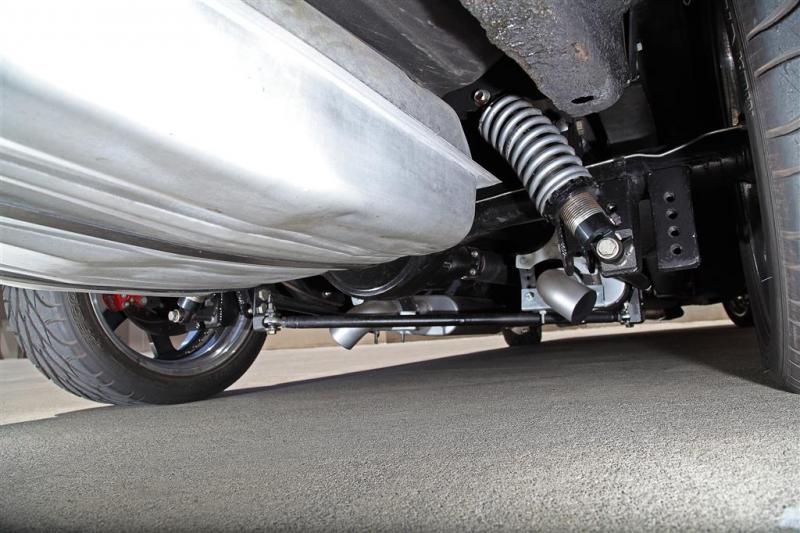

Front end: Magnumforce chromoly and powdercoated k member, QA1 single adjustable coilovers, magnumforce, 2" swaybar
Rear end: Magnumforce chromoly and powdercoated adjustable 4 link, QA1 single adjustable coilovers. track bar.

Colour: LL1 metallic dark turquoise poly white hat special roof
Body mods: fibreglass hood with 2" reverse cowl, front lip spoiler
Chassis mods: frame connectors, rear frame rail strengthening for the 4 link.

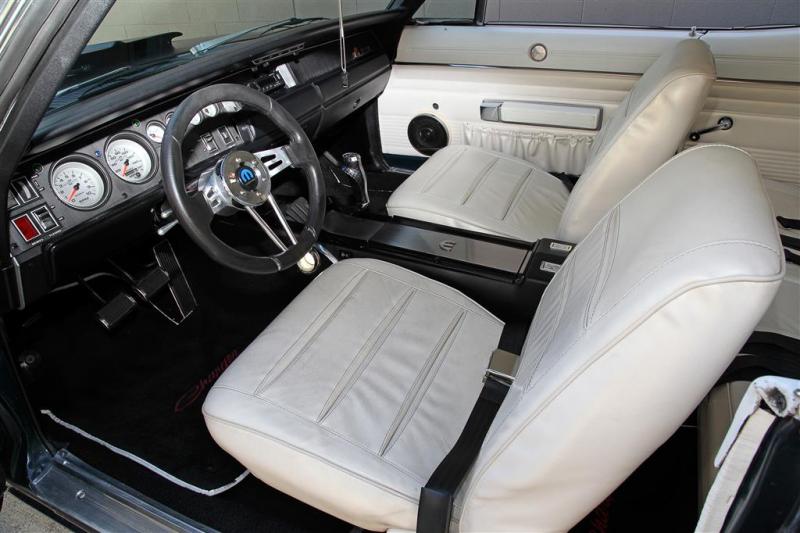

INTERIOR
Shifter: pistol grip with carbon fibre handle
Gauges: autometer auto lite II electric
Audio: pioneer 6" fronts, 6 x 9" rears, two subs and twin amps
Other: custom mats, LED light bulbs, custom boot and battery in trunk

hows that handle with the magnum force components. i have the same front end kit ready to bolt up. not sure on the rear 4-link,have not bought that yet? ride and handle ok? also can you pm me on the dash. would like more info.

One thing I would do different is use the alterkation 4 link. It allows for the exhaust to still come out the back of car not like mf.
Handles really well no body roll. Great traction. What d of you want to know about the dash
Wow benno440 . . . that air cleaner rocks ! ! What an incredible job - is that your handywork ??

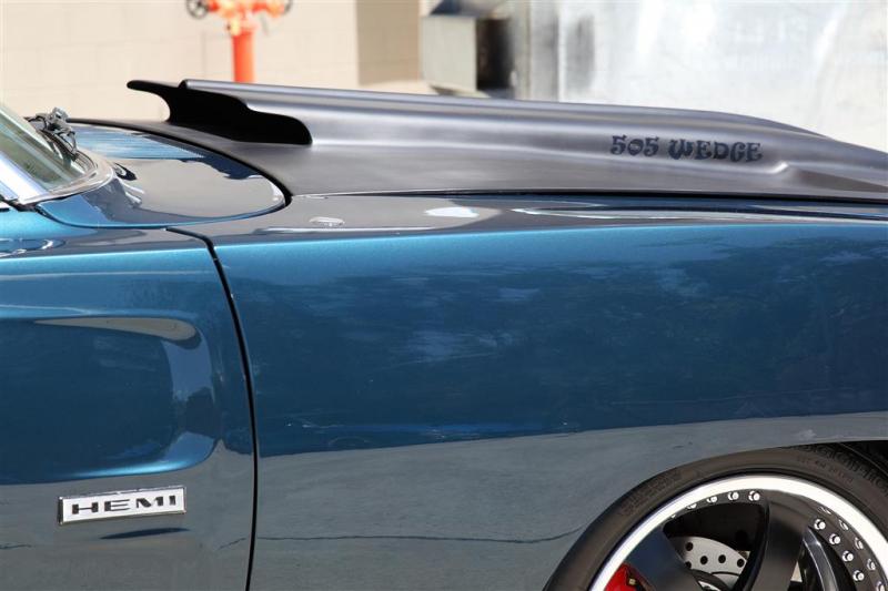

Where did you find the billet hood hinges ? ? Those look too cool - I can only imagine the pain in the wallet for them . . . ( sigh )
