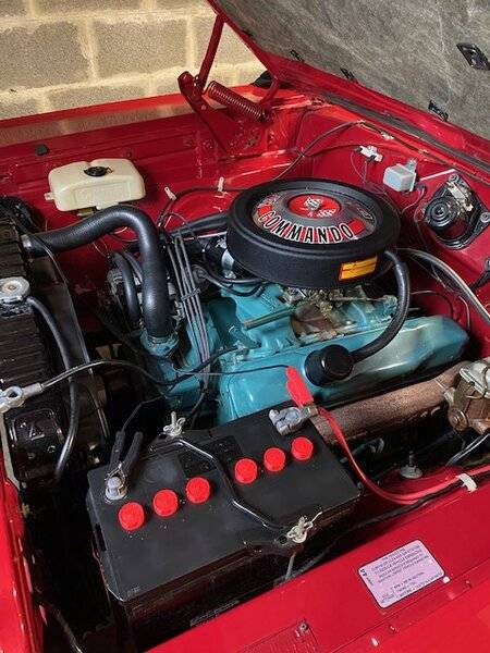

I am obsessed with the original and correct, and I have learned a lot from the books of david wise, especially . but I’m missing information and I’d like to know more about the engine. According to me the engine and the gearbox are not original, the engine is from 1969 and not HP

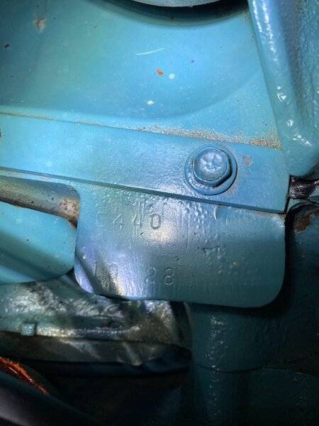

Welcome to the site. If your car has a Dec. 27 scheduled production date, it would be 1967 not 1968. They were well into the 69 model year by Dec. 68.IF that is an E on your 440 then the engine was built 10 months after your car's S.P.D.

The 1969 engine will have at least a partial VIN or full VIN on the passenger side above the oil pan rail behind the engine mount. 8 digits. This tells you what car it came from.

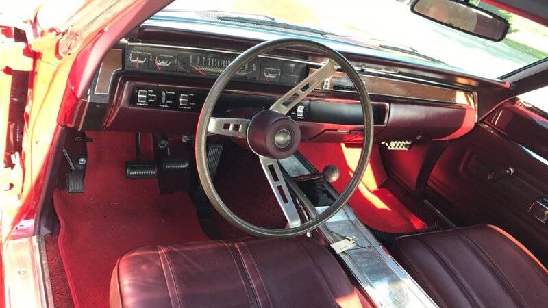

If it was assembled in december 1967 it shouldn't have the Hurstshifter. It came later in the modelyear to substitute the t-handle shifter.
It is on 15 road wheels which were not available on Mopars. They only came in 14" originally.

thanks Carsten, you're right
I would add that the gear knob, if hurst, was white.
woodgrain for 69

My December built 68 Charger has the Inland shifter. I had an early March built 68 Charger & that came with the Hurst shifter. The early Hurst shifters had "stick" script and the later ones had outlined HURST script. Don't know when they made the change from Inland to Hurst, but Hurst equipped cars would have a reverse light under the dash & Inland equipped cars would not.
