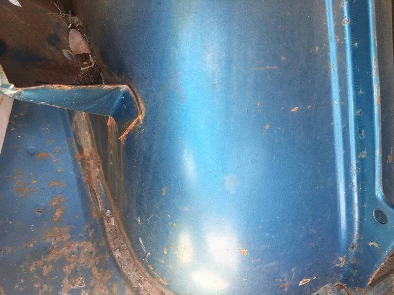

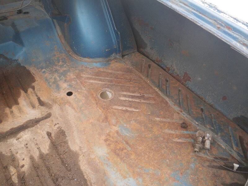

Here you can see the sound deadening material was applied first and then painted.
