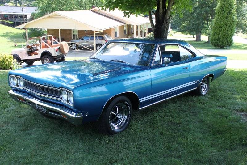

Just a reminder of what was the start of this thread... Gotta say you've made a lotta progress...
I needed this reminder. It seems it has take forever to get this far.

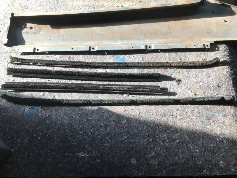

The car had been completely dismantled by this shop and the owner got it back with the engine and tranny on a pallet, as well as boxes full of other parts.
Digging through the piles of stuff I have in a storage shed was when I found these moldings. At first I couldn't figure where they went, then I noticed the holes in the top of the doors and counted the fasteners on each molding and they matched. Test fitted and viola!
I did find out that the door sill moldings don't match, the rear window moldings are missing and rocker panel moldings are in need of a lot of work to get the shine back.
Not having a lot of money, I have to buy a few items at a time and then pay off the credit card before buying anything else. Hence the amount of time it takes to get things done.

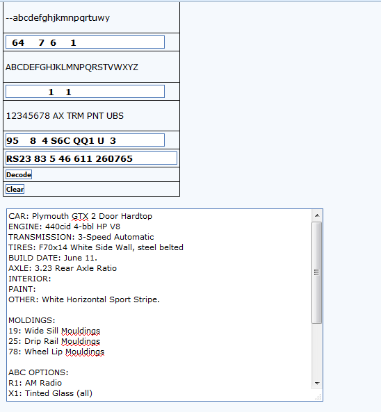

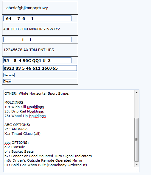

Nope. No 540 on my broadcast nor my fender tag...

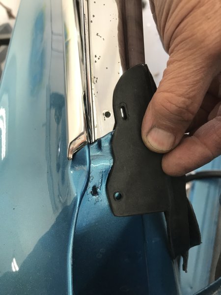

Getting ready to install the door weather stripping. In the manual it shows two fasteners at the vent window needed but I have no idea what they are? My guess would be screws of some sort.

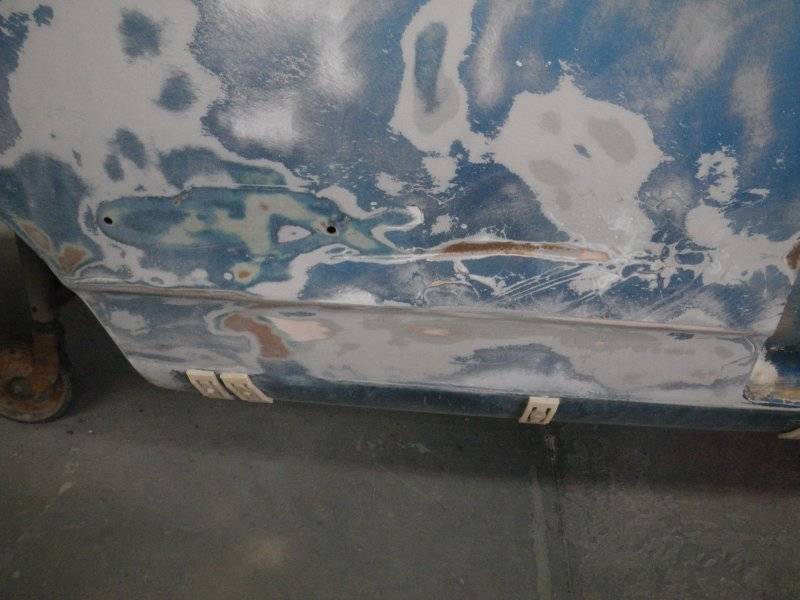

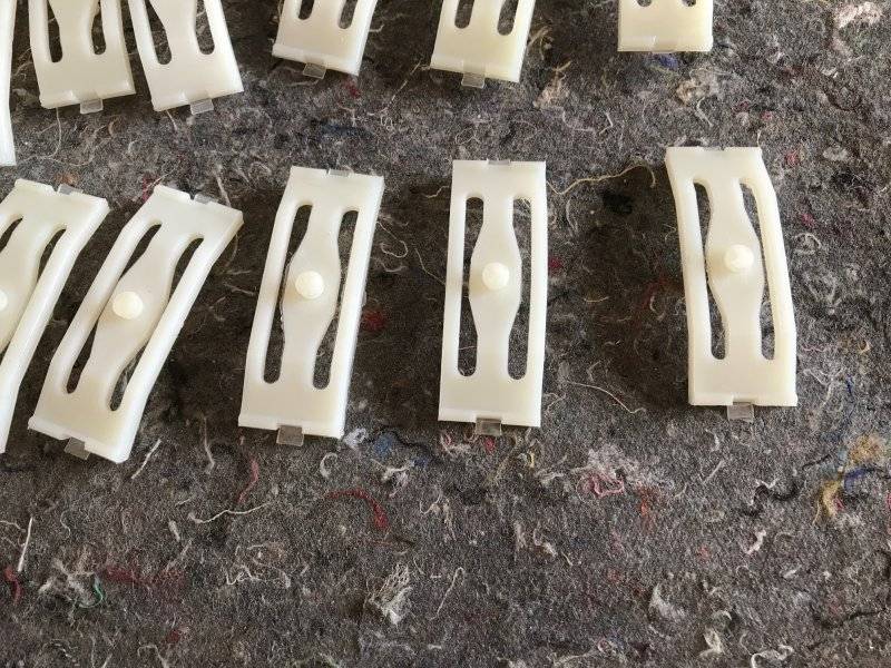

Anybody have two of these Rocker Panel molding clips for sale?
The package I bought is two short of what I need. Hate to buy a whole other package for just two clips.
You know the front locations don't use those right? They originally had a metal clip with a stud & a nut..
As does mine..
Wish I would have taken more car when removing the old ones. I just ripped them off thinking I would be buying new.
Bought the kit and it's two pieces short, contacted them about it and nothing . . .
