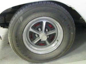

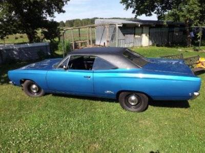

I really liked the 68 Roadrunners when they came out, and a friend bought a new one. In mid year they came out with a two dr. hdtp. and several new trim options. I just had to have one and ordered it with all the options I wanted: 2 dr hdtp, black vinyl roof , automatic tranny, power steering, radio, Satellite black interor, carpet, heavy duty rear axle option with sur-grip, 3:23 ratio rear gears, trunk tail panel deluxe trim, red line tires. The first day, I had the new keystone Klassic wheels put on. At that time , they did not come with the black accents, but I had painted them on myself.

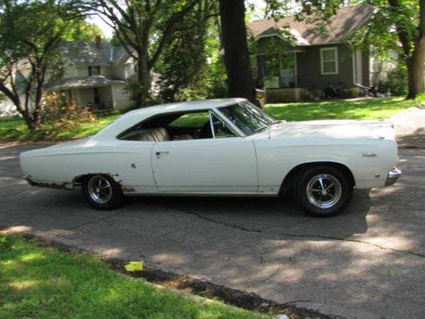

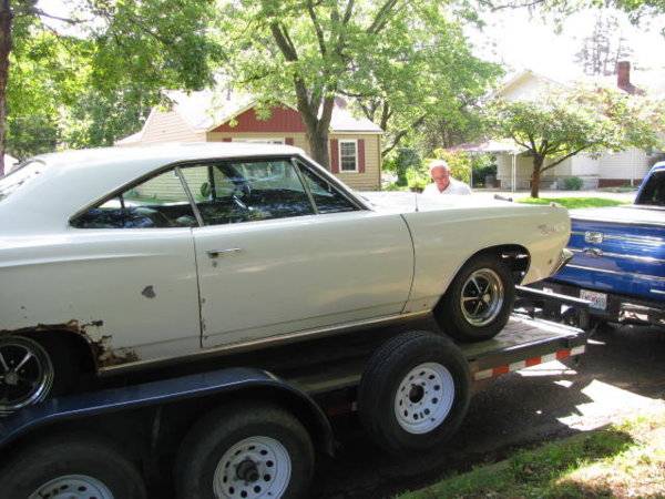

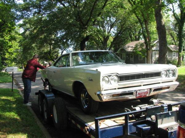

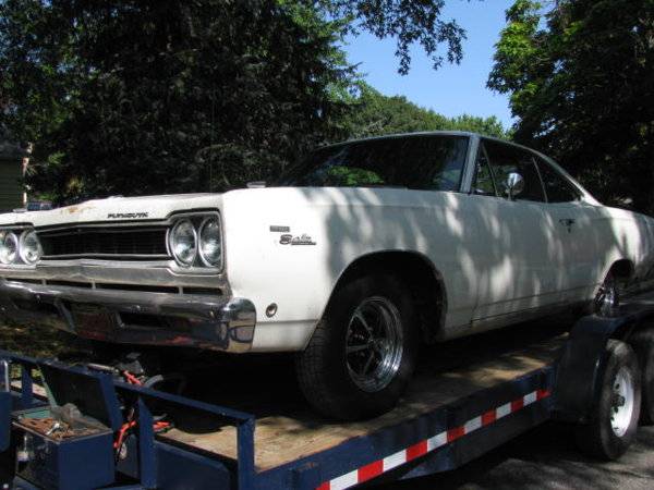

I loved that car, but hard times came on, and I had to sell it. In more recent years I wanted that car back, but Roadrunners in fair condition bring more money than I could afford. So, I have been looking for the right 2 dr. hdtp. Satellite for several years. A fellow FBBO member within 150 miles of me , listed one for sale and we made a deal.
I like the 68's better than the 69's.
Better tail panel and the side marker lights light up.

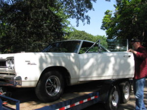

For the build, since it will see a lot of highway miles, and wifey will be driving frequently, I wanted a 318 engine for good gas mileage, and they have enough power for me. When I have the need for speed, big block 4 speed Brutus, the Dodge , will take care of that. I also wanted air conditioning and bucket seats with the buddy seat. All on this Satellite. Kind of a shame it is a Sport Satty, but I took what I found. It will look like my Roadrunner with the hood , front grille, and tail panel, but it will not have any Road Runner badging on it. I do like the wood grain dash and door panels. It will retain the stock 904 tranny and rear differential.

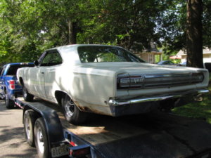

This car was a true " barn find" from out in rural Kansas. Been sitting there for at least 30 years. Very good condition except for rear wheel well rust, tattered drivers seat and worn carpet. The guy that found it put on all new brakes and front suspension. Cleaned up the engine & bay, installed new gaskets and seals, and timing chain. Also overhauled the carb. New battery and tires . Cleaned inside and out, with a paint buff. He drove it from Topeka to Denver and back to Topeka with no problems. It did have a seep in the radiator which I fixed with a new core, and the brake lights sometimes stayed on ( now fixed) When cold, a lifter makes a little noise. Does not burn excess oil.
We have driven this Satty several miles now, and I am very pleased with it. Now the build project has started. ..............To be continued.....................MO

Sooooo, it looks about due for some new rear springs? Great find, now to out-do Jim in Az.!

You got a little ahead of me. 8-) I had new rear springs built in Omaha two weeks ago. I had them built for a 1" higher than stock ride height.

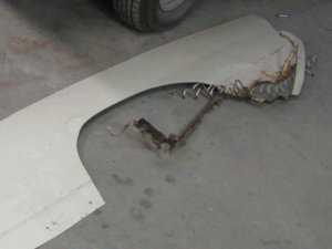

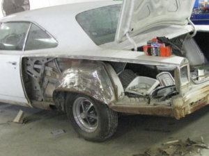

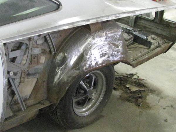

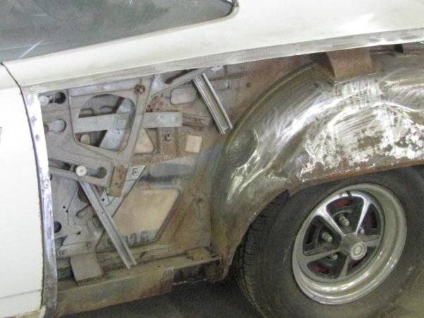

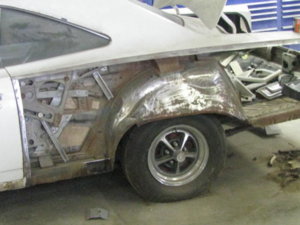

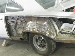

Last year while out on a drive, we got into a bad hail storm with this Satty. Had damage and after going around with the Insurance company having to prove the value of my car, we got a settlement . So , ordered both new AMD quarter skins and a outer wheelhouse. I also obtained a good Satellite grill, and new trunk finish panel trim, and correct Road Runner tail light bezels. There is a difference between those and the GTX-Sport Satty bezels.
This Fall I got the car into the body shop and got the quarter skin and wheelhouse installed. They also had to fabricate part of the trunk floor extension and replace a bit of the inner rocker panel. This Winter they have installed the left quarter skin, some other minor patching, filled hail dents and prepared the roof for a new vinyl top. Put in a new windshield, and patched a couple small holes in the windshield frame. The Road runner hood I had bought earlier , needed a little more work than I wanted to pay to have done, so I got a new AMD hood . It is not primered and installed yet. My AMD sheet metal fit very well. hopefully the hood will too. .............continued .......................MO

I guess I never told in the first post. Like the new one I ordered, it will be " Electric Blue" QQ1 code. In recent research, I find that color was one year only ( 1968) and a little darker than B5 blue. I think Dodge was called bright blue with Q1 code. And, I am finding that it is a little difficult to get the QQ1 color. It also will have a black vinyl roof. ...............................MO

With my current physical condition, I just can't do all the work I used to do. The 64 Dodge took me 6 years, so I stated with a solid driver and want to get it back on the road soon. The paint will probably have to wait till next Fall- Winter. I am using Urathane primer, so water-surface rust will not get under that.................................MO
My body man called me. The back window is out, and only one small rust hole that can be welded shut without a patch. It will need a patch at the rear of the rocker panel moulding, that was hidden by the clip. I am going to leave off those mouldings and the wheel arch trim. He is going to shim the door hinges to make them fit better, and epoxy primer everything. Paint chips in the doors and front fenders have been feather sanded.
