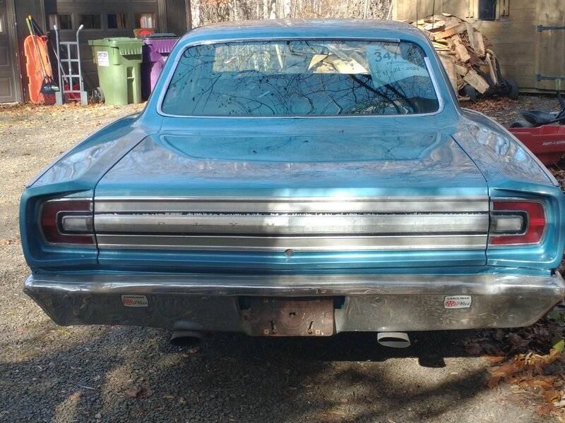

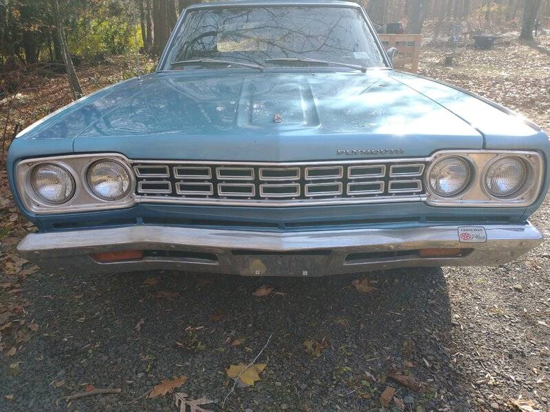

Thank you all for your guidance! It's a fine line between throwing parts and tuning up. The gas-adjust shocks and four tires on the way. Bushings older but seemingly ok. Sways likely next.
