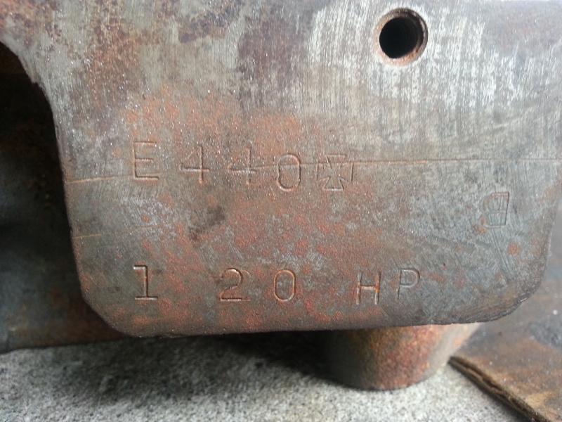

Well, since I have been drooling with envy over H2E's 69 Charger R/T Rebuild I decided to start my own thread on my own 69 R/T rebuild. A little background.... I found this car on Craigslist in Syracuse, NY. The ad was listing an original 69 R/T that had "driver quality paint" that was completely gutted and needed a motor/tranny and interior. The ad showed no photos of the car so of course I was skeptical but it wasn't too bad of a drive so I figured what the hell. Needless to say I was really happy with what I found when I went there. I found a car that is indeed an original R/T. The car was originally a Copper Metallic with black interior but is now painted black. The car is an original 440 / Automatic / 3.55 posi. The owner had a motor/tranny out of a 78 Winnie that was a package deal with the car. After some haggling I purchased the car and got her home. The original plan was to use the 78' equipment. Now that I have had some time with the car I decided that she needed better treatment than that. I was able to locate a date coded 69' 440 E440 HP block. I also located a rebuilt 69' big block 727 and a 1969 489 center section. Photo's to follow. Now it is nearly impossible to do a job anywhere as good as H2E is doing on his 69', but... here goes nothin'!

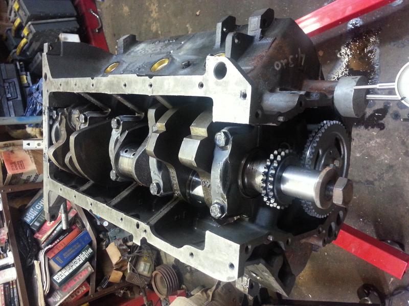

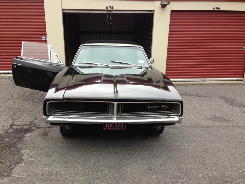

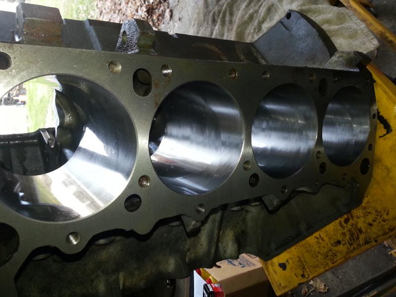

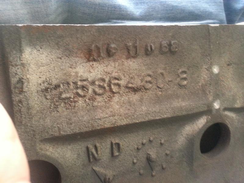

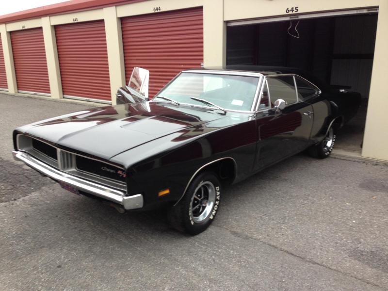

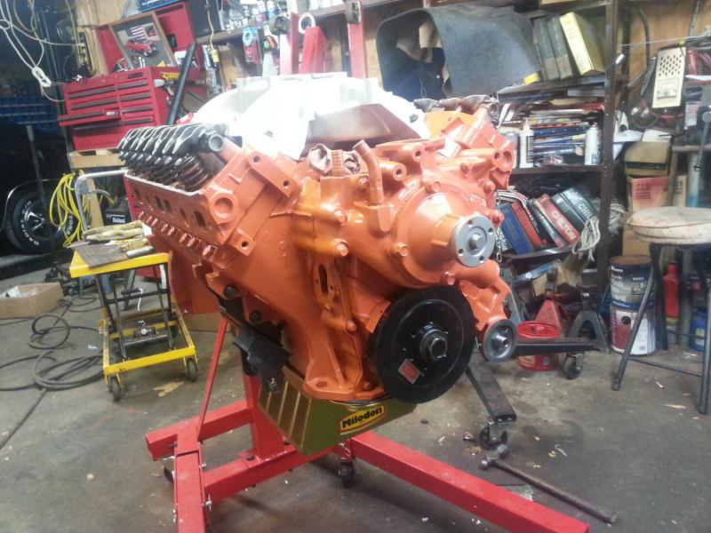

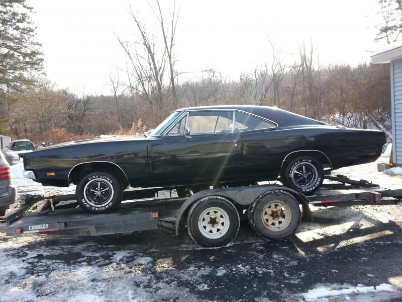

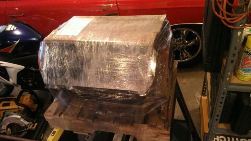

Here is the collection of the photo's I have so far. The storage unit pictures are on the day that I got the car. The picture of the block wrapped up is the 69 440' block when it arrived at my house. I had it bored .30 over. Then you can see a picture of the low end completed with the .30 over TRW Flat Top Forged Pistons. Lunati Cam. The last picture is from today when I trailered the car up at my house and brought it to the garage to begin the reassembly and motor/tranny install. More to follow.. Thanks guys!

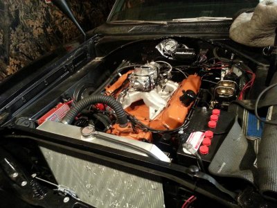

Finished the engine re-assembly today. Got it painted up. Ready to drop it in. Pumped. :headbang:

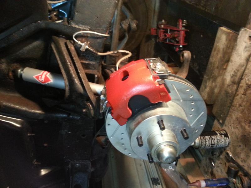

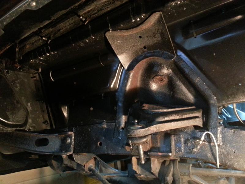

Finished up the disc brake conversion yesterday. Couple before and after pictures. Got the motor and tranny snugged up in there too yesterday. Currently waiting on my 69' 489 case clutch style posi 3.55 gear center section to be built. Should be done Monday or Tuesday. Once that is in I have to get a drive shaft built. Any suggestions in locating a rebuilt drive shaft?
