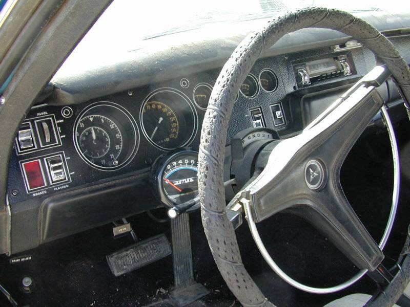

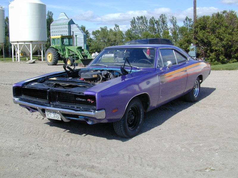

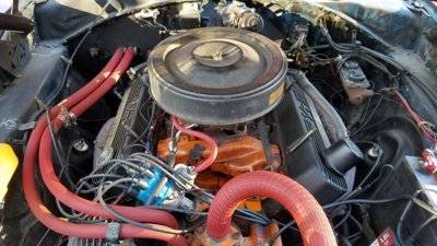

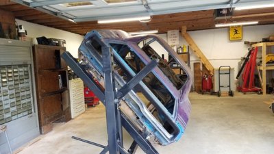

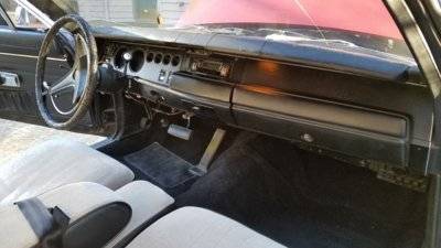

Here are some pictures from when I got it 16 years ago. It barely ran due to a flattened fuel pump push rod that took some time to discover.

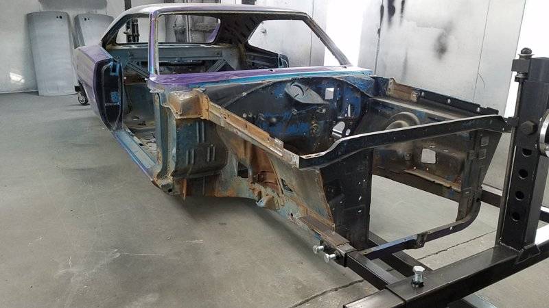

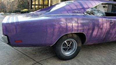

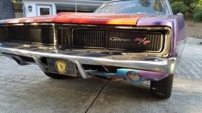

And here are some pictures just before tear down. I will post some pictures of the tear down next week.

I am the 13th owner of this car. It spent all its life in North Dakota before I got it. I think it was re-done in the 80's and had the interior replaced, painted purple, and the colorful stripes. For all those owners it stayed somewhat intact. Besides the rear end, rear brakes, and transmission most of the parts look original.
It didn't run well for many years. The previous owner thought the gas tank or lines were bad and weren't flowing fuel consistently. Some times it would allow you to tune it and drive, then it would change and run lean. I replaced the the gas tank, fuel pump, and fuel filter without any luck. I later read one guys post on a forum that said in the 80's a bad batch of fuel pump push rods were made. They were too soft and would slowly compress and get shorter. It was a very uncommon problem as most people didn't replace them when doing a rebuild. Mine ended up being a half inch shorter than stock. Enough to make the car run, but not well. Should have just checked the actual fuel pressure rather than just seeing that I was getting fuel.

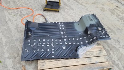

Well the Charger is still out for media blasting and priming. They are going to do the small parts first and then the body. I have started to order sheet metal. I am going to mostly use AMD from Summit Racing so I can pick it up to save on shipping if needed. I have ordered both valence corners, the trunk to valence supports, and trunk floor halves so far. Don't have the trunk floor yet.
Since I am not removing my full quarter panels or the rear panel with the tail lights, the half floors are the way I must go, right? I assume this is an overlapping seem. Can this be fully welded and body filler used to make it look seamless, or will I just need to weld it and use seam sealer? Thanks!

Most important thing is to buy good ones, AMD wasn't available when I did mine and boy were the ones I bought junk! Make sure they have all of the spot weld lips because those are common rust areas, mine was missing the rear lip that welds to the tail panel and guess what was rotted out on mine?

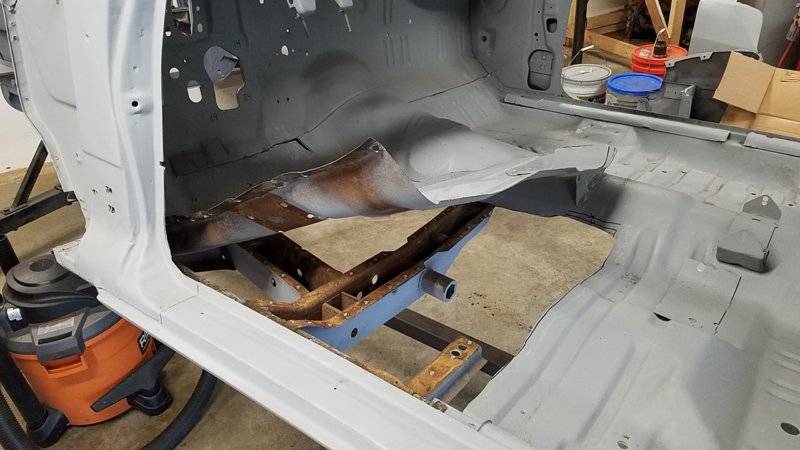

I did remove the trunk floor and lower rear quarters before blasting. Thankfully the frame rails looked nice and solid, even had some blue paint left.

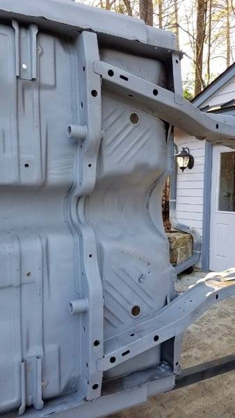

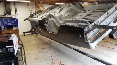

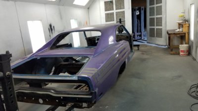

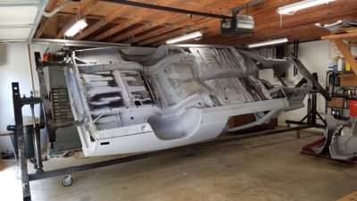

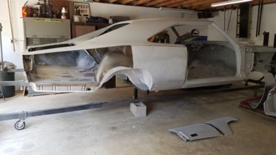

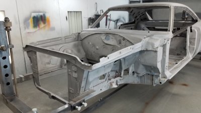

Sorry, I haven't been very good about posting and got very busy with the real job. I did get the Charger back from blasting. Here are a some pictures of before, during, and after. I am very glad I had it blasted and epoxy primed even though it took a couple of months.

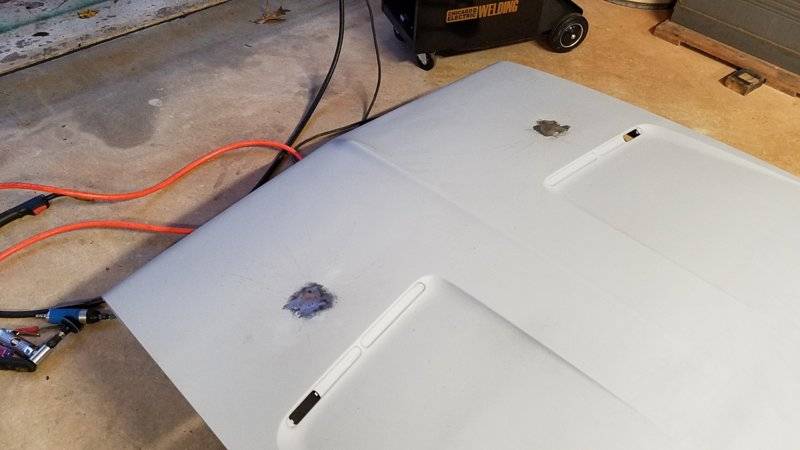

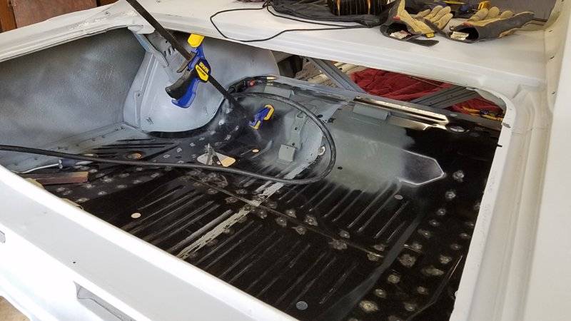

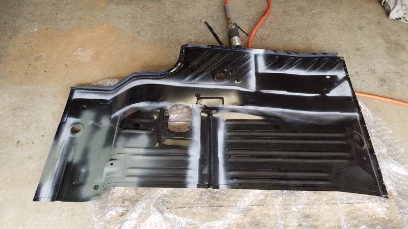

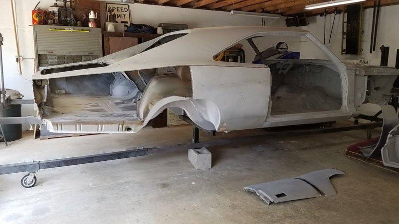

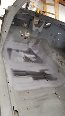

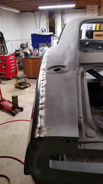

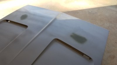

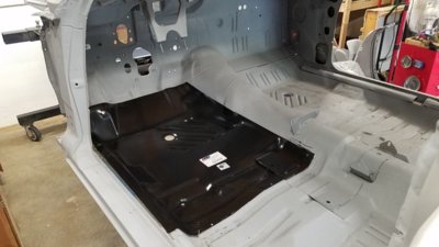

And the sheet metal work begins. Filled in the hood pin holes since they were not in the factory location. Also began installing the AMD trunk floor halves. I think the floor was harder to get out then in, but not quite done.
20181201_172654.jpg 20181202_123930.jpg 20190302_131924.jpg 20190302_134801.jpg 20190318_183635.jpg 20190324_162529.jpg
Need to finish the trunk floor welds, but went to AMD and got a quarter skin since it was on sale. FYI, a Charger quarter panel is about the full inside length of a VW hatchback.

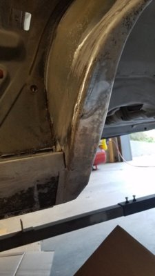

This is my first time with major sheet metal work, feel free to make suggestions or give tips. I will have questions on whether to replace the entire quarter skins or do multiple patches. There isn't a ton of rust, but with the rust spots and major dents with filler I am not sure which option is best. I will get more pictures and let others help decide.

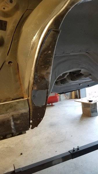

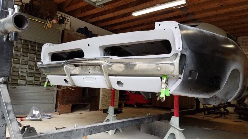

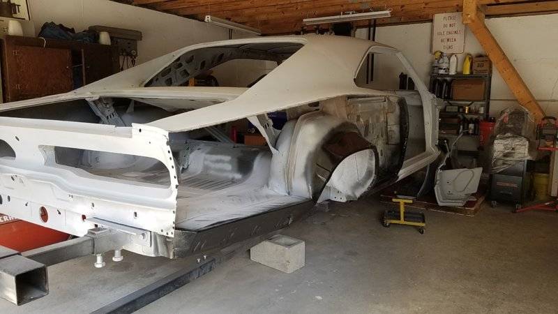

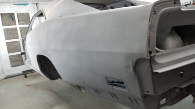

The quarter panels are done too. There was a lot more bondo in the quarters than expected, most from accidents just behind the doors. The lower rears were very thin and had many holes. With those issues I just decided to replace them. Also completed the rear valence and corners.
