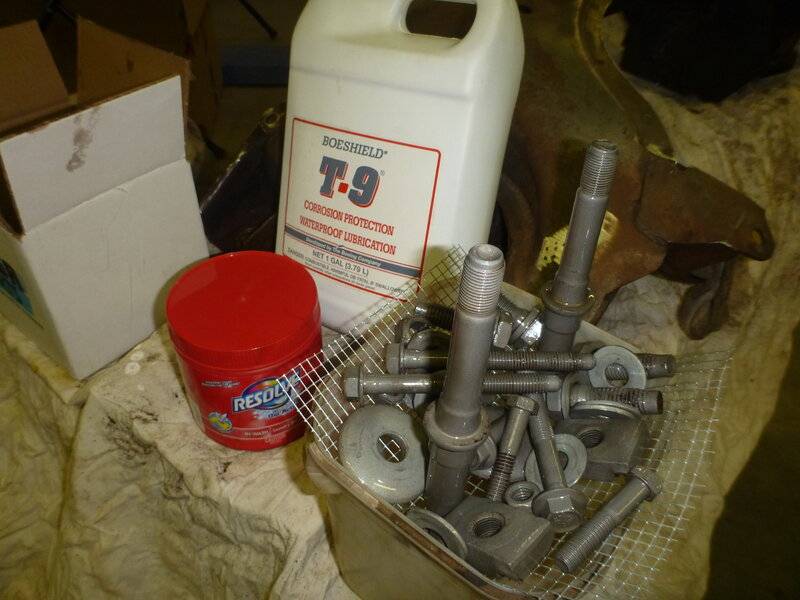

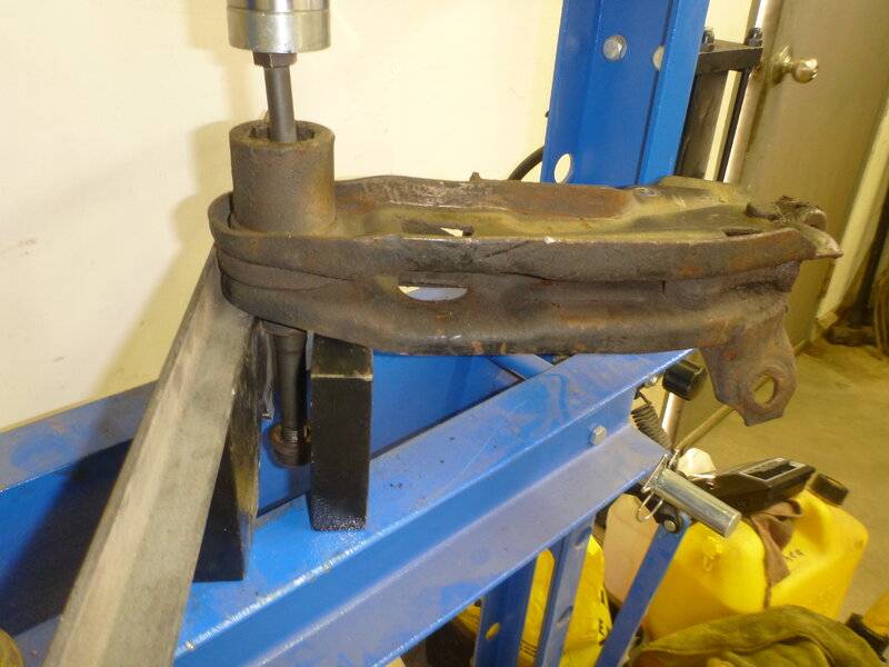

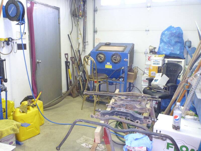

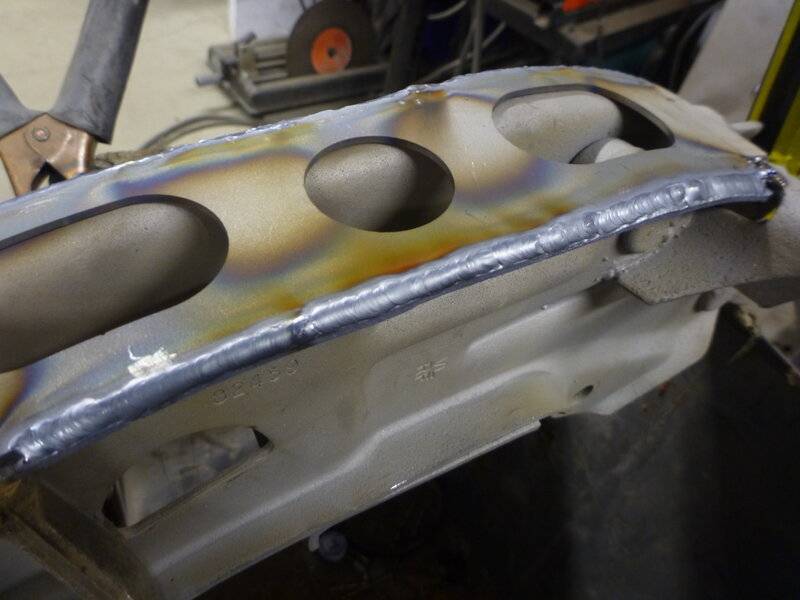

Had a blast today... all 7 hours of it doing hardware, strut rods, trans mount, sway bar mounts, etc. TBars, LCA's and a sway bar tomorrow... if I can figure out how to get it in the cabinet. Then dip the TBars and sway bar and weld some reinforcing plates onto the LCA's.

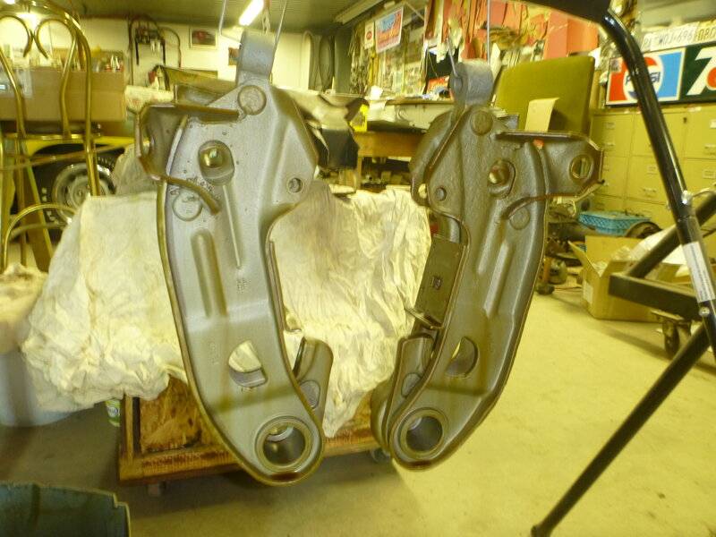

Thanks Greg... a bit sloppy to what I use to do, but my eyes have gone to hell and it's the first time I've used my TIG in over a year. Have to use 1.5 cheater glasses these days to see the bead. I don't generally grind welds, as it's taboo in the aircraft industry.
I have to "tune up" almost every weld I do. My stuff holds together but is not as nice as yours.

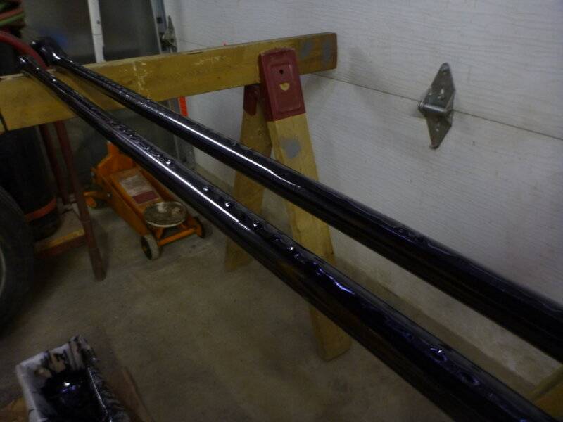

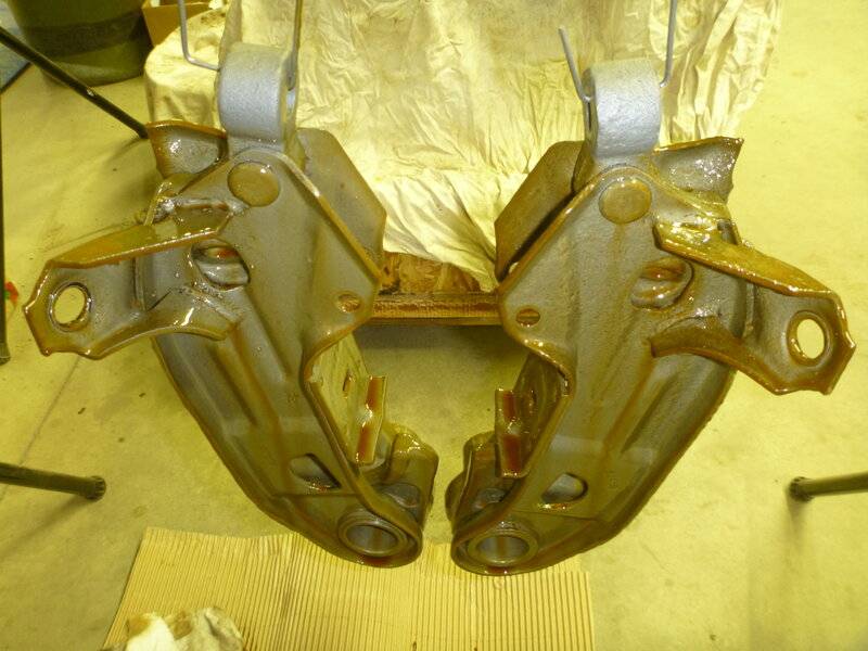

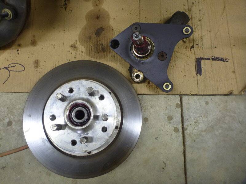

They actually dried to the touch overnight (kept the shop at 72F) and came out nice with the colour I was hoping for. I also tore the Wilwood disc kit off the spindles so I can degrease, blast and T-9 those. Nice kit, direct bolt on mod for 10" drum brake spindles.
