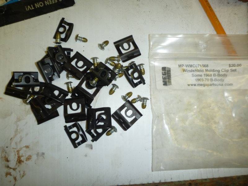

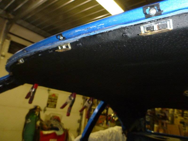

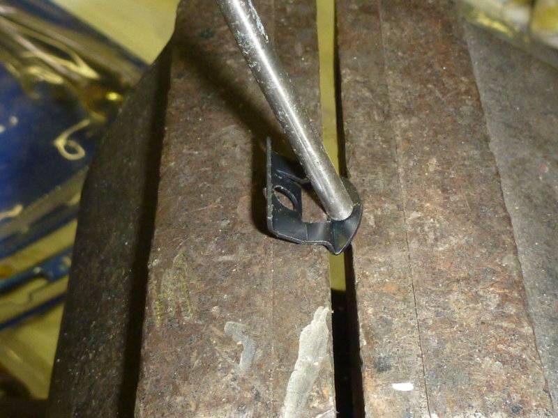

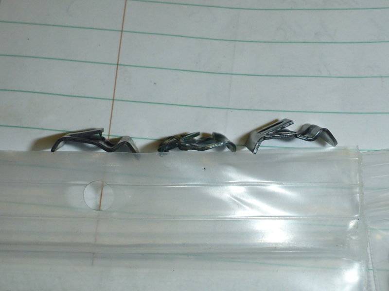

Did you have any issues with your rear glass clips? Mine don’t hold very well, they are repops from Nigel

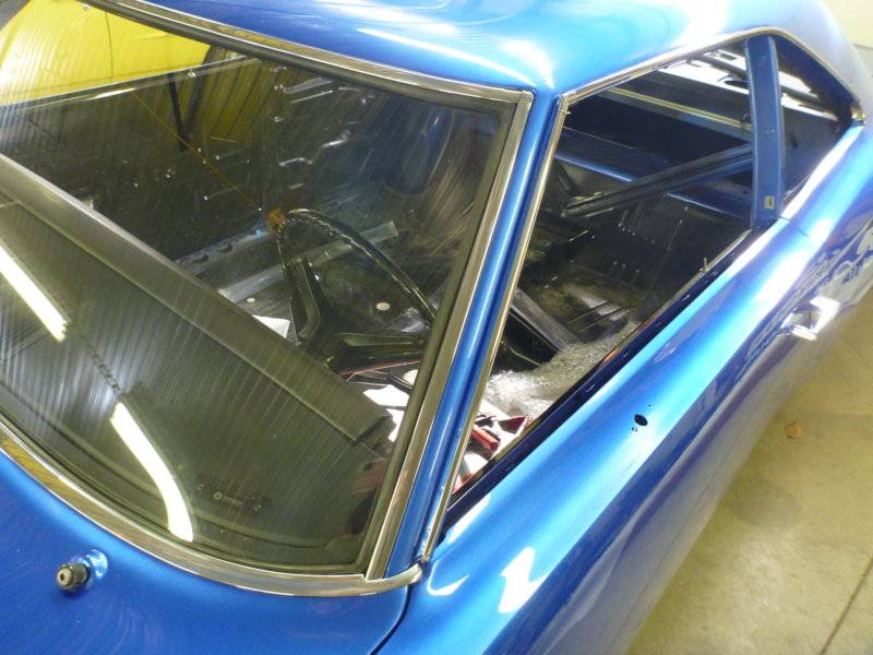

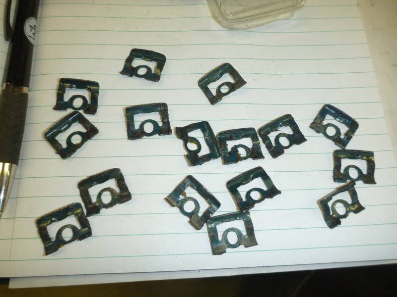

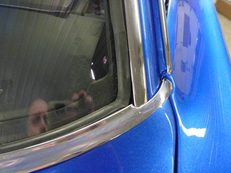

Front windshield I used a kit from Jamie at Megaparts which appears to have worked BEAUTIFUL! (first three pics). The rear glass I had 3 or 4 "rear glass" clip kits from various places, none seemed to have the "tab" to lock the trim in so I cleaned up and reused my old ones (middle clip in the pic showing three). I added a few missing clips by using some repops and using a punch to make a "tab". These are all covered somewhere back in my build thread.. but here are the pics.

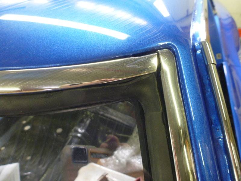

I can move it over, it's just keeping it there. Appears I got the windshield installed about 3/32 off center to the passenger side and I'm sure not going to try and pry IT over! :eek:

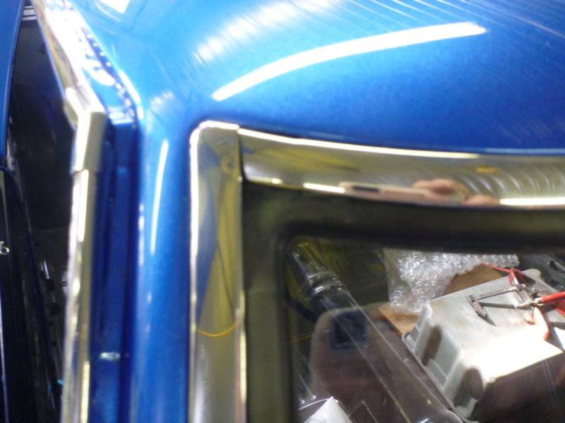

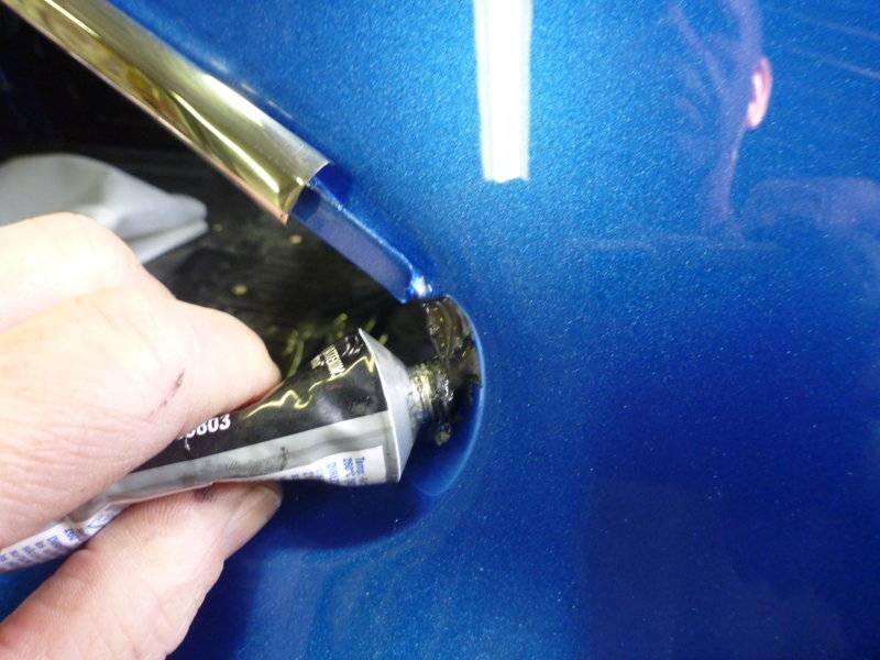

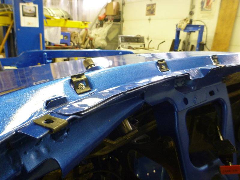

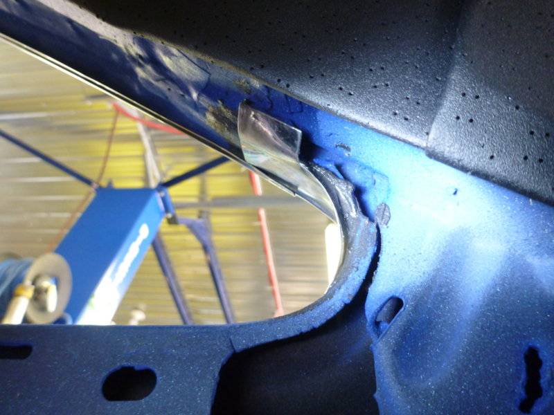

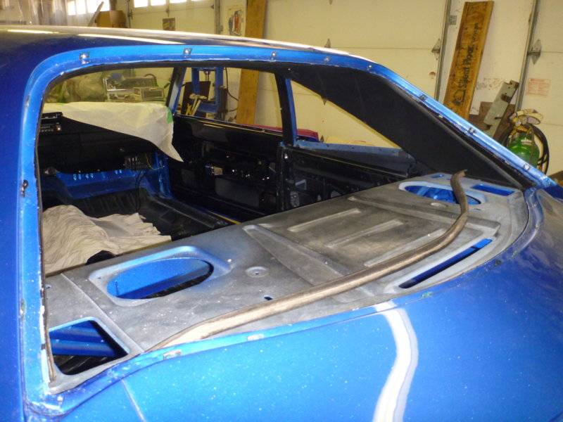

Needed to install the proper oval head screws and realized behind the trim curl was just a wide open gap for water to run down the drip rail and right into the quarter panel. Sealant and reinstall trim piece. I may be blind, but I could find nothing in the FSM on drip rail trim install needing sealant here.. maybe they let it run inside the quarter panel. All I know for sure is the curl has to be on first, then the roof rail seal channel, then the pop out window assembly.
Sealed up tight, ready for upper trim rails, their seals and the swing out window assembly.

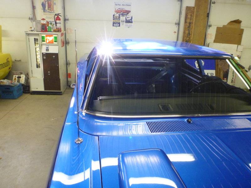

Antenna assembly installed and actually straight.

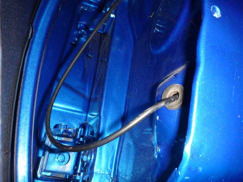

Don't forget a drip loop in the antenna cable and I still have to seal the grommet hole so mice can't crawl in . It's not the OE grommet, not even sure if one was originally there, I added it.

My original ‘68 rear glass trim had a couple big ‘globs’ of sealant around the bottom of trim. Almost like they tried keep trim down better?
Clamps off and final drip rail trim pieces in place. Windshield rubber is still not totally where I want it, but I'm getting it there a bit at a time. Wish I could just work with the "care", fit and timeline of the assembly line, but that's not me.
Almost have the rubber in the bottom drivers corner into place.
Upper drivers corner still off, but slowly getting it there.
Passenger side upper corner was perfect right out of the gate.

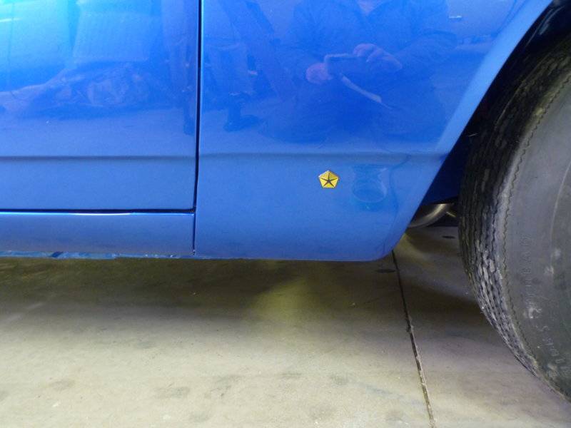

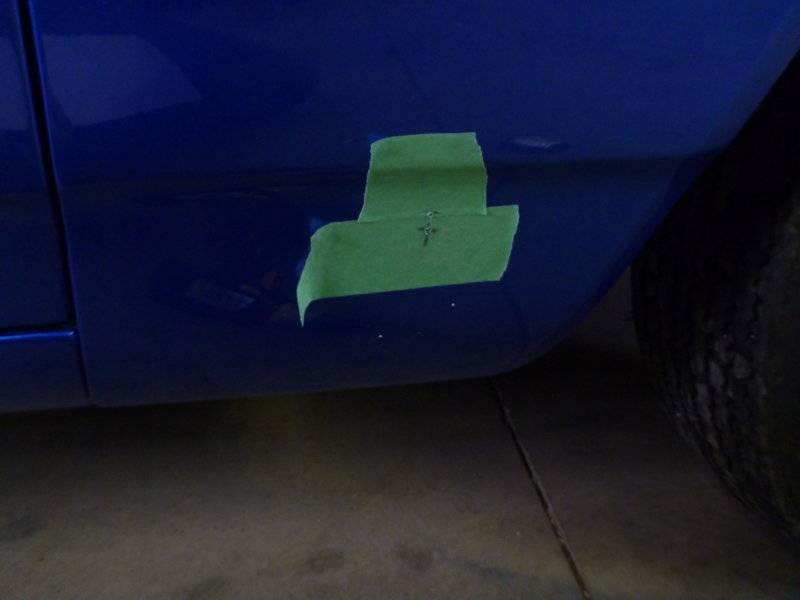

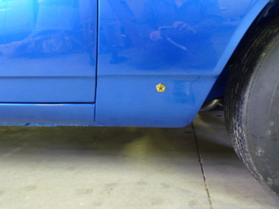

Nothing like drilling two holes in your car on the lower passenger fender, where we had to put some new metal in. Thankfully zero filler ! Locator pin 3/32 and retainer pin 3/16".(I did it the easy way, locator straight up, not 72* clockwise!.. I probably should have just glued it sans tabs)

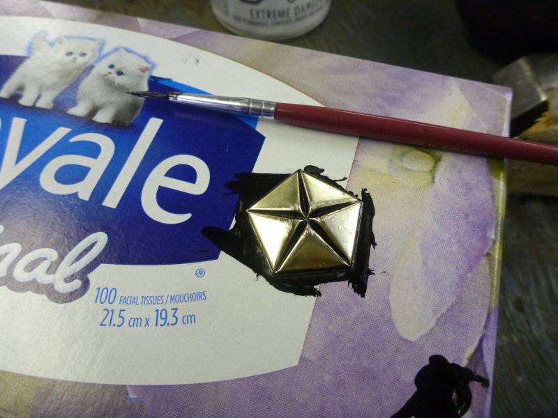

Can't go without the Pentastar.
beerestoration2019 1621.JPG beerestoration2019 1622.JPG beerestoration2019 1623.JPG beerestoration2019 1624.JPG beerestoration2019 1628.JPG beerestoration2019 1633.JPG
Funny how such a minor thing like adding the pentastar emblem makes so much of a difference in the looks.

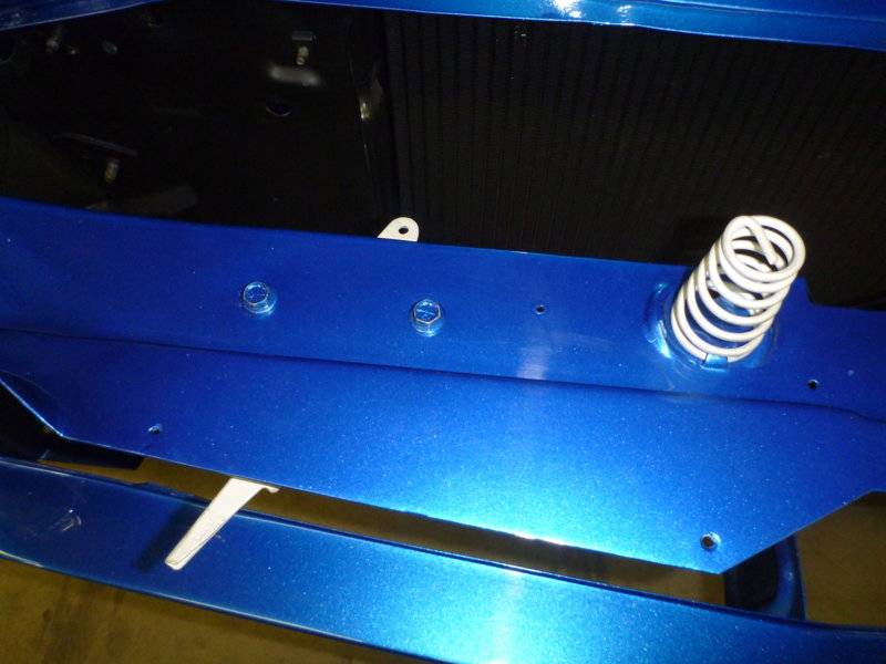

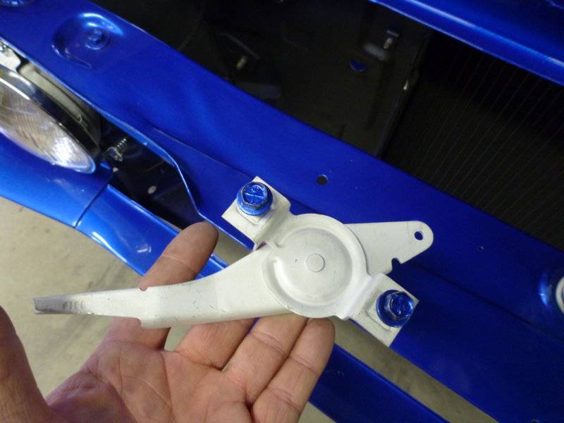

Hood release latch. Believe the bolts should be black phosphate, but I only have two blue ones left. Will correct later, but I want to get this latch on the car.
31st day of 1969, 25 days before scheduled car build.

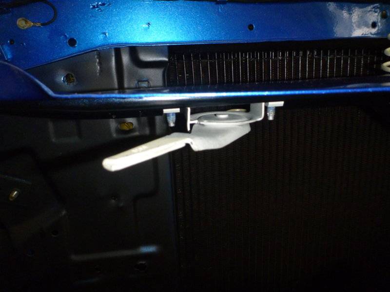

Latch installed under the grill support.
Latch and hood "lift" spring installed.

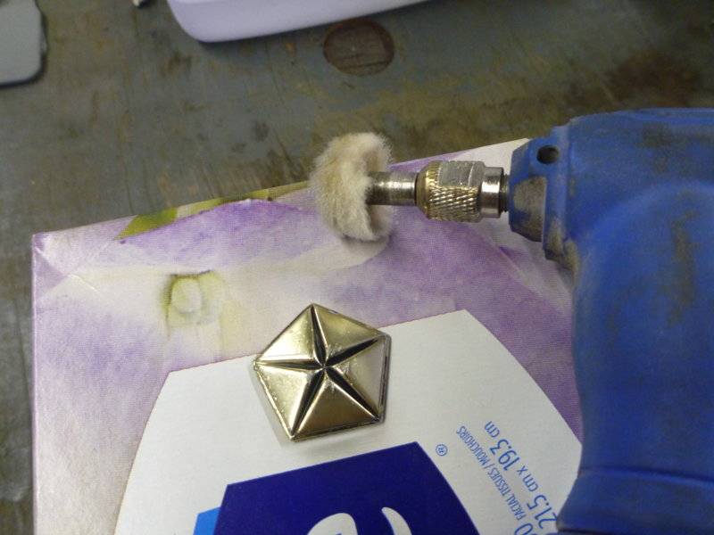

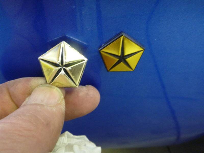

Had a "Wayne" moment today, when my mind registered that a $200 NOS Pentastar had been listed in the classifieds last night and got to thinking.. where did mine go. The $10 reproduction plastic looks so fake beside a real die cast one.
It's not perfect, and the body shop lost my retainer speed nut it seems, but a quick polish and it already looks 10x better than the repro.
Repainted the perimeter black, that was missing, and retouched the interior lines.

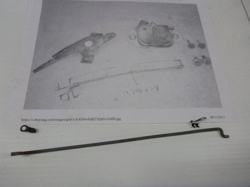

Found what I was looking for, almost panic'd because the plating house had already lost my OE and thankfully I was able to obtain this latch rod for a few bucks from the same lad (Steve) in New York State I'd bought my radiator from vs $300US for the full set in the picture. It had been the ONLY set I'd been able to locate and he would not separate and sell just the rod. My new friend in NY bailed me out, basically for postage costs. Thanks again @3white74 .
