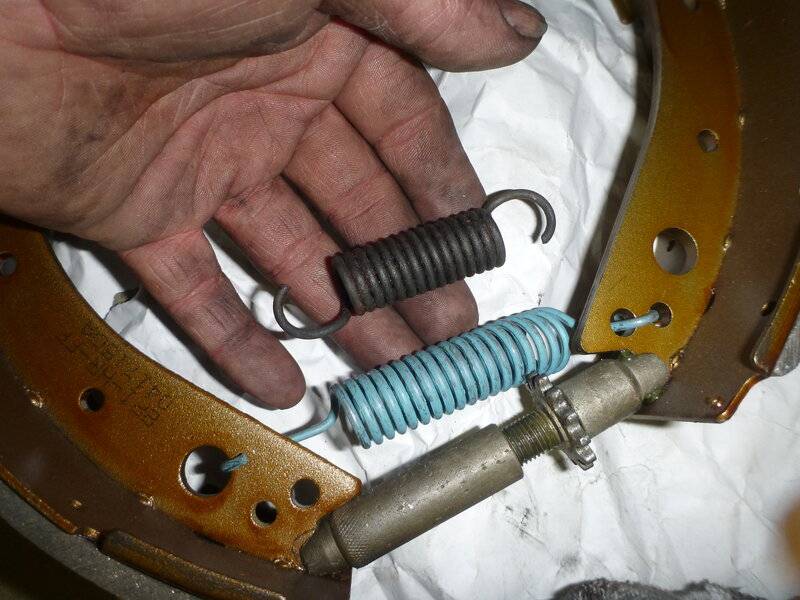

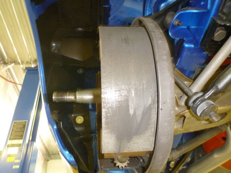

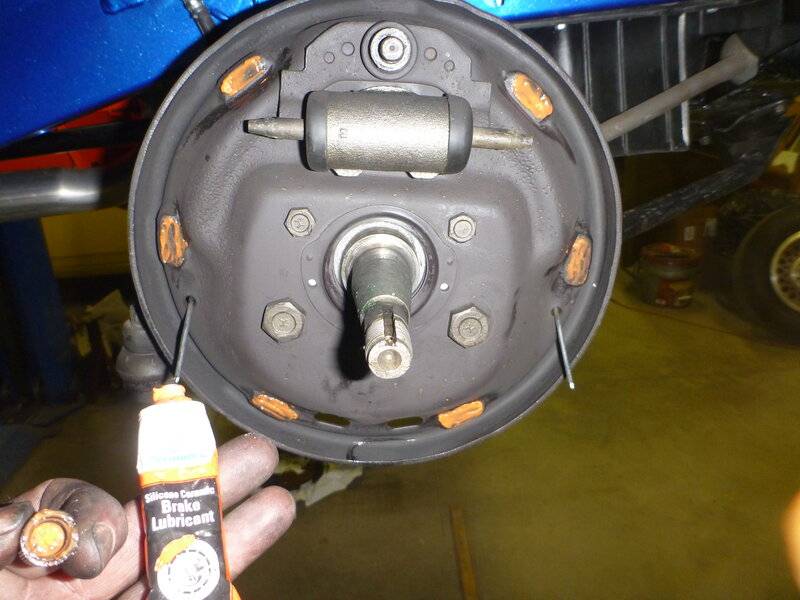

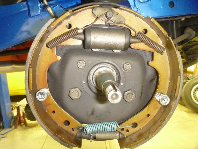

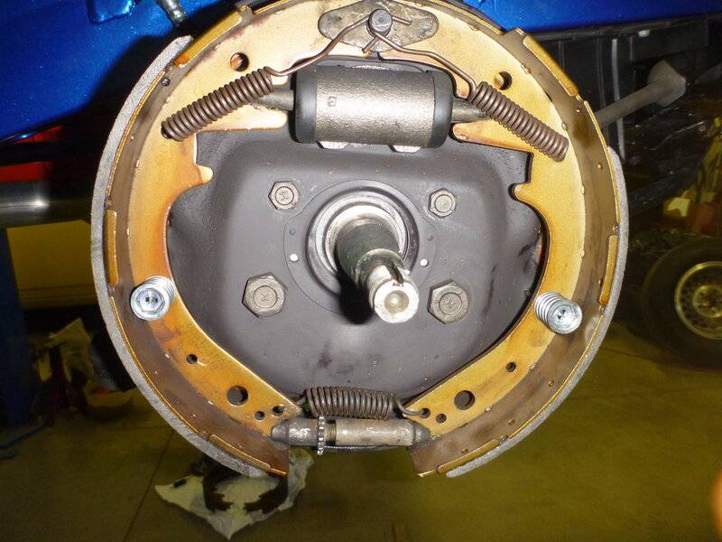

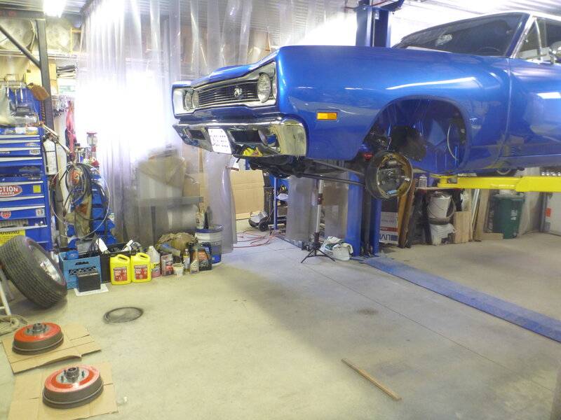

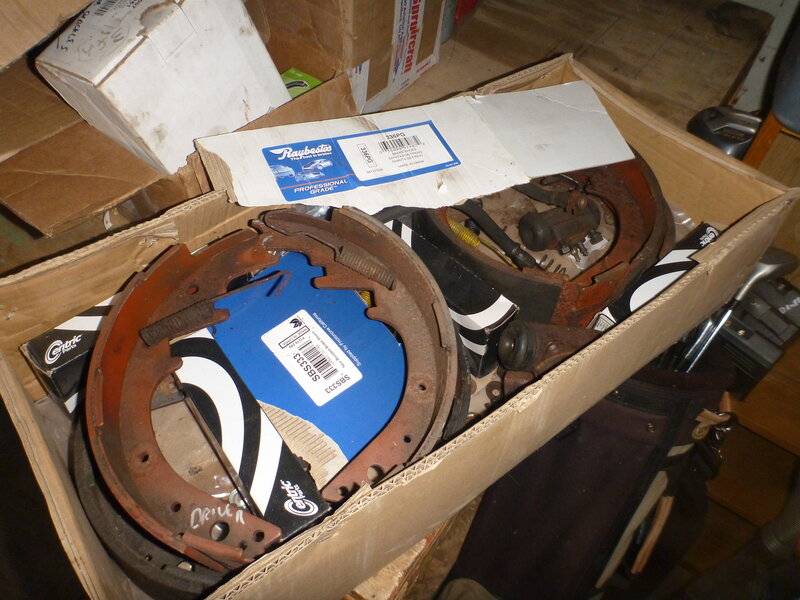

As noted elsewhere I've been searching for the cause of a hot right hub assembly (150F vs 90F on the left). Three times I've put it on the hoist hot and the wheel spins as free as a bird with zero drag noted from brake shoes. Driving it yesterday I found panic stops would brake absolutely straight, yet putt'n around the town the right front would grab and pull the wheel. Tore into her again today, with some good suggestions to re-grease all the shoe contact points and @mobileparts had pointed out yesterday in a picture that I put up that I had the wrong springs across my manual adjuster star wheel. I knew that, as it was what I had in a hardware kit and I didn't want to use my old OE's on assembly at the time. Well it looks like that cockeyed spring may have been tipping the shoe as the wheel cylinder pushed it out, as there is a galling mark in one spot on the inner side of the shoe surface. Why you never throw anything out! Into the box of removed brake shoes and hardware. Cleaned everything up, lubed, reinstalled all the shoe hardware using the correct OE bottom spring, reinstalled the drum (cleaned, as were the shoe surfaces) and retorqued the bearings (all clean and free) to 90in-lb and backed off a notch on the retainer. Test drive tomorrow about 20 miles each way to go fix #3 childs pool.
View attachment 959733 View attachment 959734 View attachment 959735 View attachment 959736 View attachment 959737 View attachment 959738 View attachment 959739 View attachment 959740 View attachment 959742

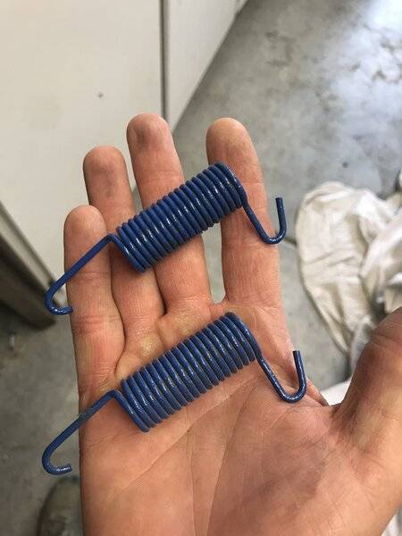

So are the blue Springs technically incorrect? I’m putting mine together for the first time and I have these blue springs that are similar to the one on yours. Are the original style springs available?

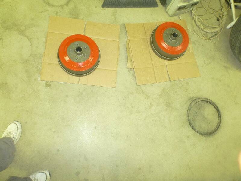

They are technically wrong if you have manual adjusting front brakes. That said, they worked just fine the way I had them installed, I was just covering all my bases to solve my heat issue. It wasn't the springs as it didn't follow to the other side. I know the overheating drum was the largest diameter, so possibly the shoes didn't like it. All has been fine since the hub/drum swap.

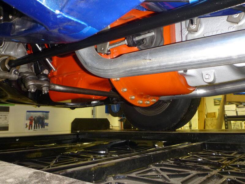

Figured I had the Bee out again and she's up in the air, so I'd show some shots of how things are staying clean and rust free, despite 3000+ miles since we hit the gravel roads again with her.... and I'll note that the underside from the engine back has not been wiped down in that time frame...other than my coolant leak dots up near the nose.
