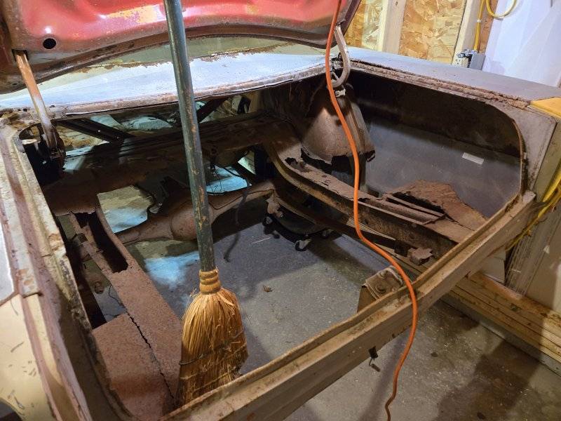

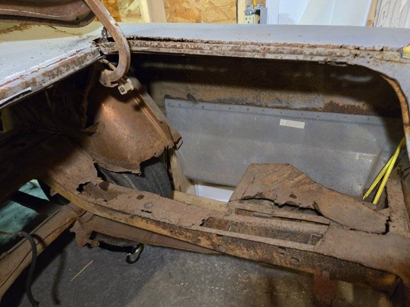

I would go with a frame jig. As rotted out as that floor is I think a rotisserie would make it flex in the middle.
Excellent Point.I would go with a frame jig. As rotted out as that floor is I think a rotisserie would make it flex in the middle.
Ya...it's trashed!OMG. Jesus Chrysler. All the best. No one here has ventured a guesstimate.

I'll send some pictures ASAP!

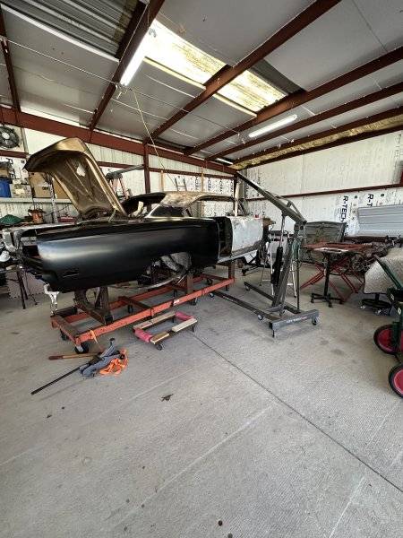

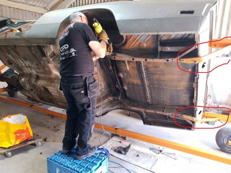

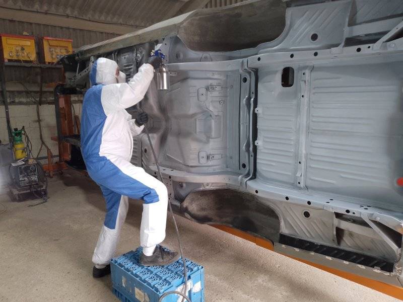

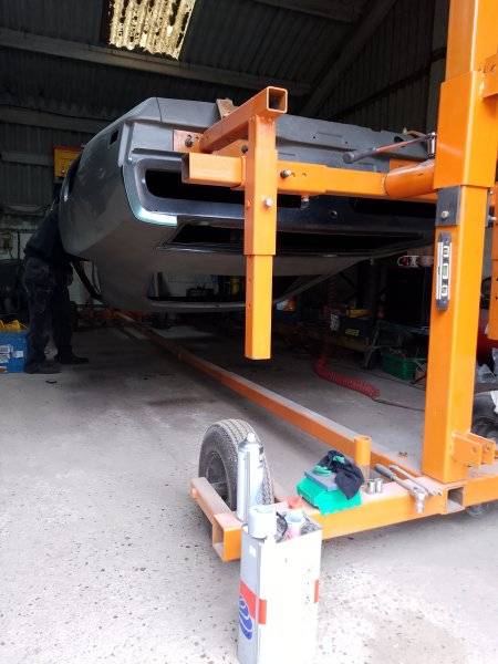

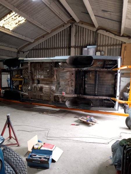

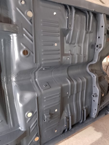

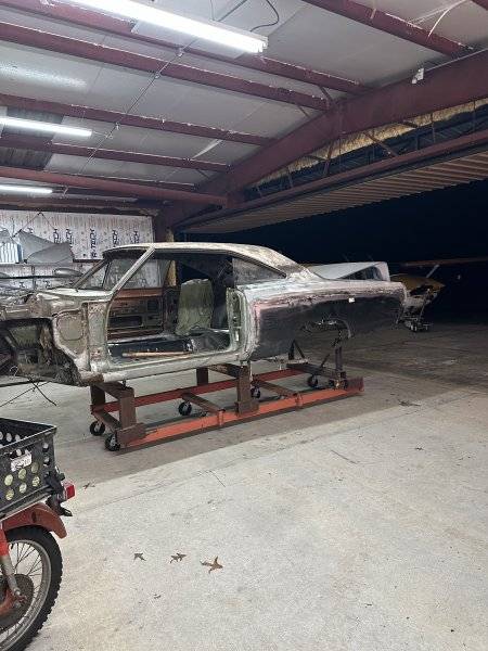

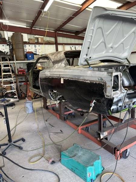

Here’s the frame jig I made. There’s a diagram on the web I built it off of. I built it a bit high so I could get underneath the body for floor panel figment and such. I would recommend you put it on rollers. After the one piece floor and one piece trunk floor and other repairs were accomplished I put it on the rotisserie. I can’t imagine have it on the rotisserie and doing that sort of work. Especially the rear cross member install.

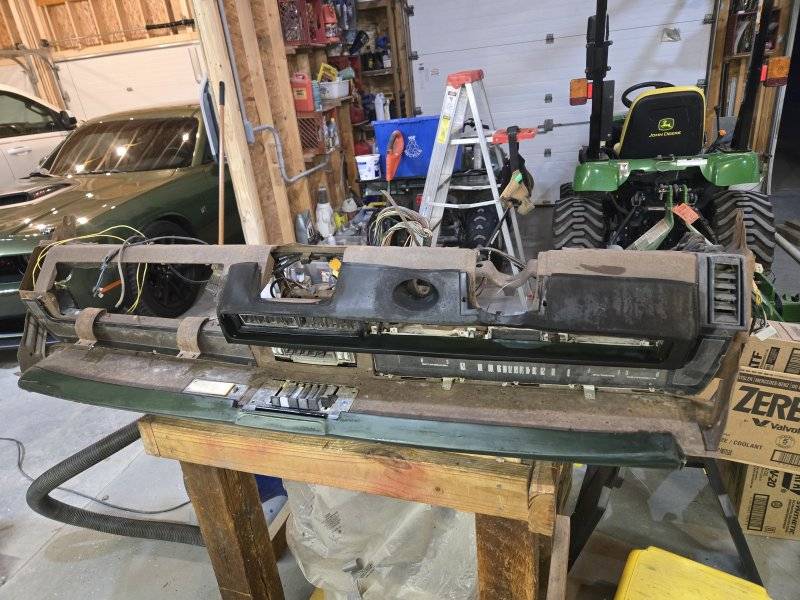

With a tach no less. Nice!!!Well...ok....

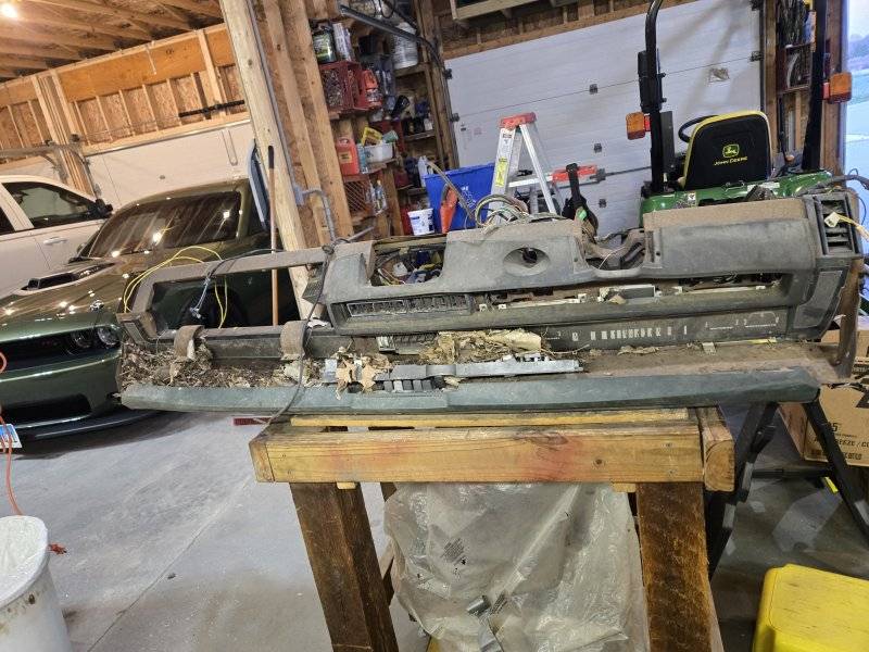

We have a donor dash from a Satellite!

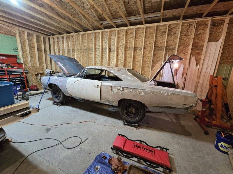

Need some advice....
I have a lot of organizing, tagging, bagging and meticiculous inventoring parts. During this period of time, I'll be saving and building my financial resources to invest and commit to the restoration. So, which direction makes sense?
My Goal is a complete ground up restoration/resto-mod. Should I fabricate a Frame Jig or Purchase a Rotisserie?
Frame Jig Option: If fabricated properly, I could "lock in" the uni-body factory dimensions for precise reconstruction. Ideal for Frame Rail, Cross member and rocker panel replacement (if required). My concern is the Frame Jig may or may not be useful for other/future B-body Projects without modifications.
Rotisserie: facilitate ease of access to most/all areas of the car. Can use Rotisserie on other projects after the roadrunner. Might not be able to maintain factory dimensions if structural support needs replaced.
What would you all recommend?
Please advise.
