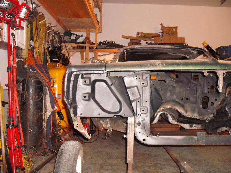

RIGHT QUARTER IS FINNALY BUTTONED UP N GOING TO START ON LEFT TOMORROW N HOPE TO GET BACK ON ROTISSERIE BY WEEKEND IF EVERYTHING GOES AS PLANED. WITCH RARELY HAPPENS.SHOULD BE READY FOR A FINAL BLAST TO GLEAN THINGS UP N GOING TO GIVE IT A GOOD SEALING OF PRIMER. ILL LET IT SIT AWHILE AND START TO WORK ON FRONT END PARTS TO GET THAT FINISHED.
Wow! That's great work saving that charger! I'm in watching this one as well! Thanks for posting.
Sure looks nice with new quarters on it, keep up the good work.

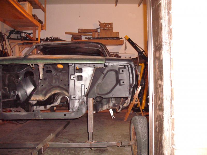

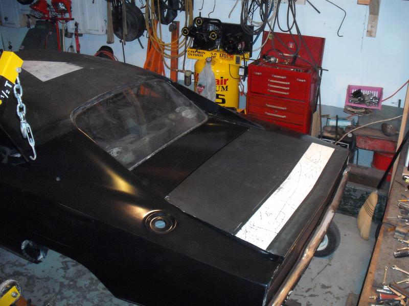

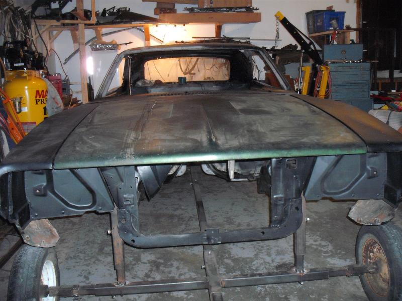

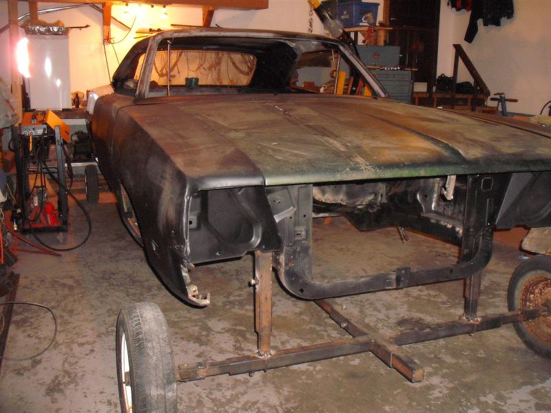

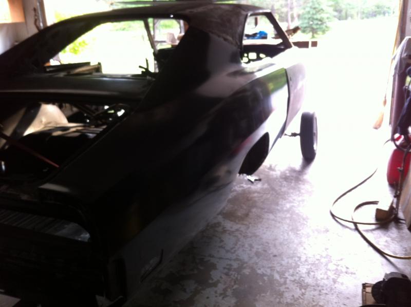

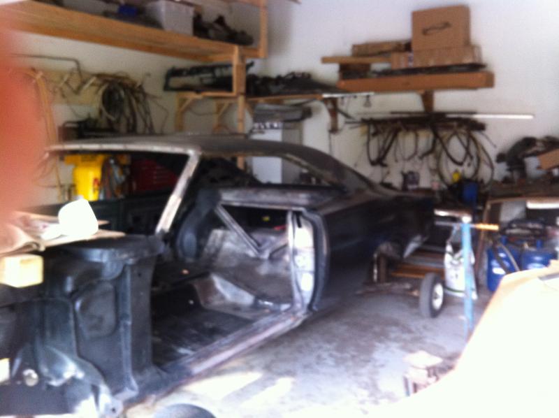

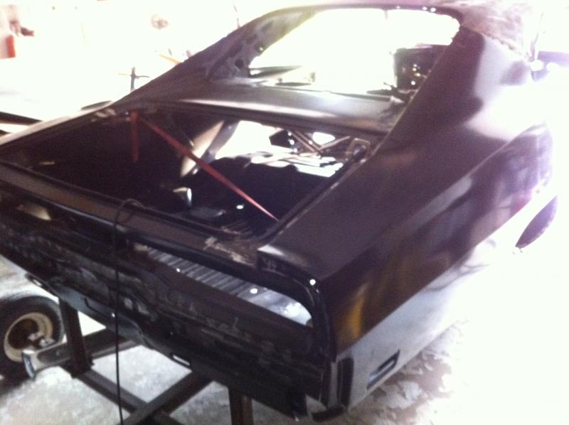

DSCF3163.jpgDSCF3158.jpgDSCF3159.jpgDSCF3160.jpgDSCF3161.jpgDSCF3162.jpgjust a few pics off update off car

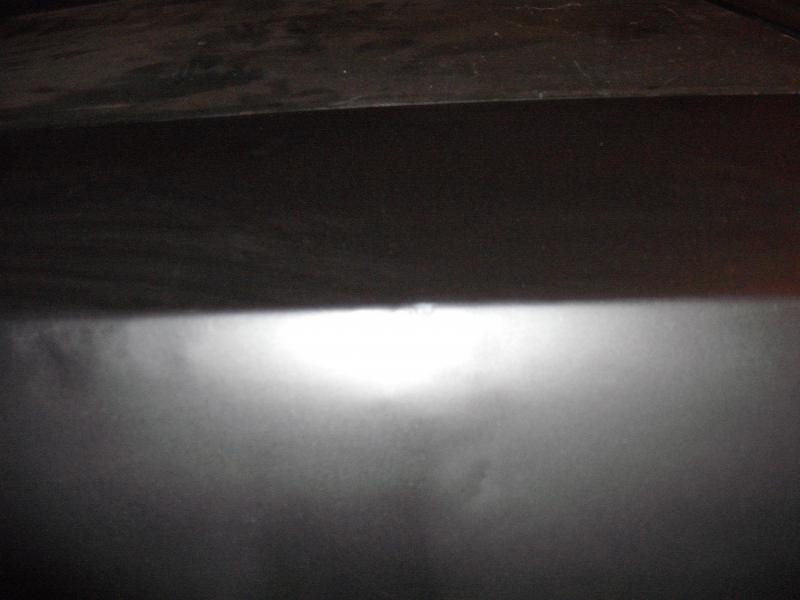

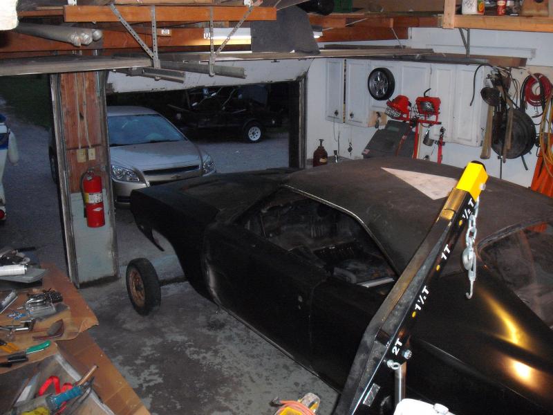

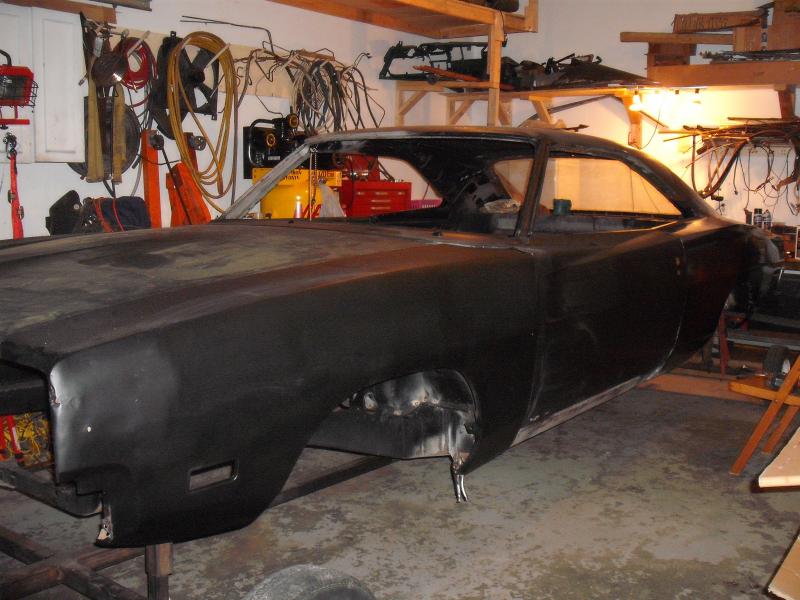

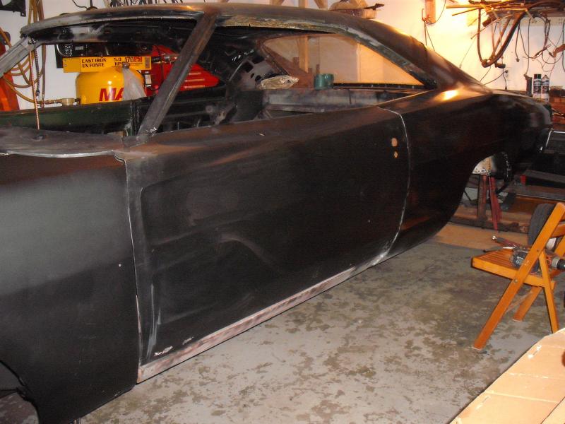

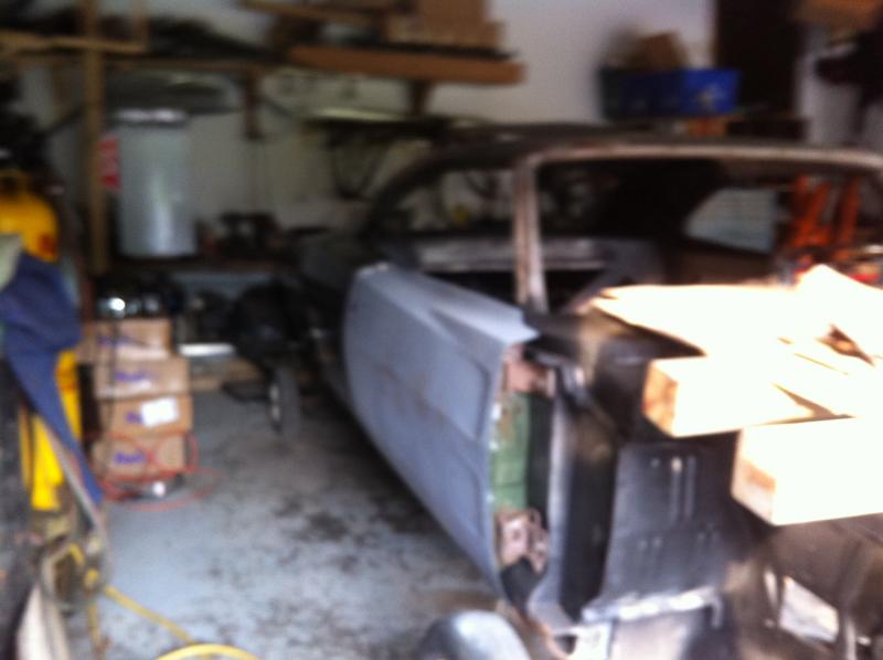

DSCF3154.jpgDSCF3155.jpgDSCF3156.jpgDSCF3157.jpgDONT KNOW IF ILL KEEP LF FENDER AS THERE ARE A FEW DENTS ON BODY LINE AT TOP ILL TRY N LOOK FOR A DONAR I HAVE TWO NICE 68 DOORS IF SOMEONE WANTS TO TRADE. I KNOW THERE IS NOT MUCH DIFFERENCE OTHER THAN LOCK HOLE BUT IT WOULD BE NICE TO HAVE A ORGINAL 69 DOOR
View attachment 197159View attachment 197160View attachment 197161View attachment 197165View attachment 197166View attachment 197167just a few pics off update off car

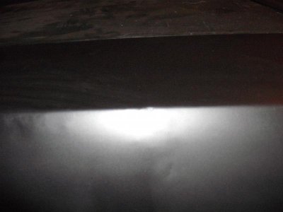

View attachment 197168View attachment 197169View attachment 197170View attachment 197171DONT KNOW IF ILL KEEP LF FENDER AS THERE ARE A FEW DENTS ON BODY LINE AT TOP ILL TRY N LOOK FOR A DONAR I HAVE TWO NICE 68 DOORS IF SOMEONE WANTS TO TRADE. I KNOW THERE IS NOT MUCH DIFFERENCE OTHER THAN LOCK HOLE BUT IT WOULD BE NICE TO HAVE A ORGINAL 69 DOOR

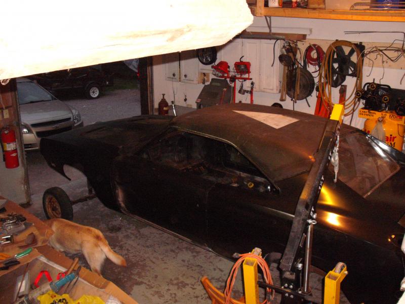

I remember this from ebay a while back. Dig the roof arrow. I would imagine it won't find it's way back on
Definitly not a few more things to button up and all the hill billy graphics will be gone. Getting ready for a final blast n than a good coat off primer n hope too paint under body n interior before snow flies lol

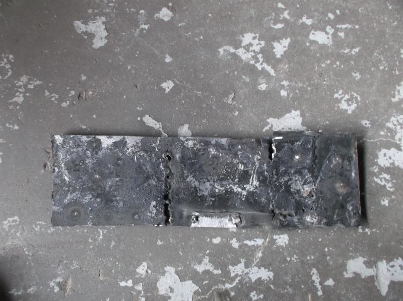

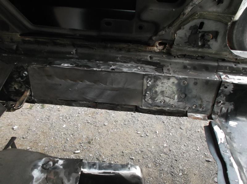

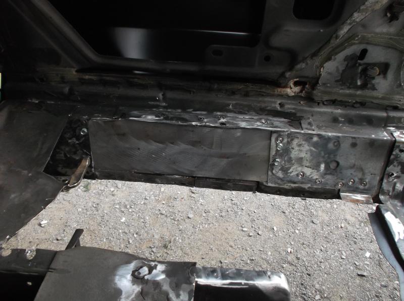

Just an update on progress n came across a panel that i overlooked as it seem fine at the time.just cleaning up the rest of areas not done yet n noticed a patch work on inner rocker at front rear frame rail.i cut the piece out n replaced it with 18 gauge metal with 4 inches off over lap on the inside than going to place patch in cutout n weld solid. Just need some imput if this is a good way to do this.DSCF3184.jpgDSCF3185.jpgDSCF3186.jpg

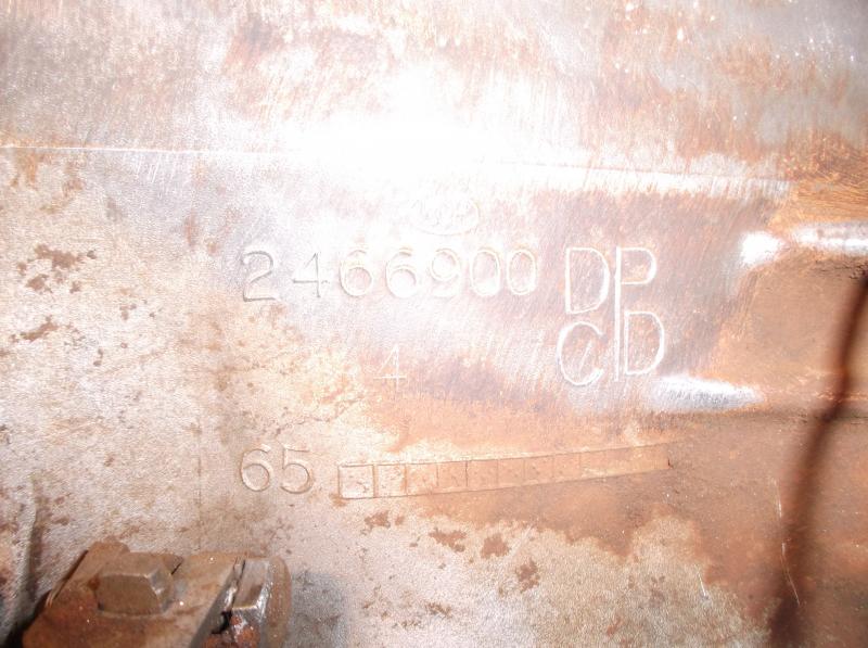

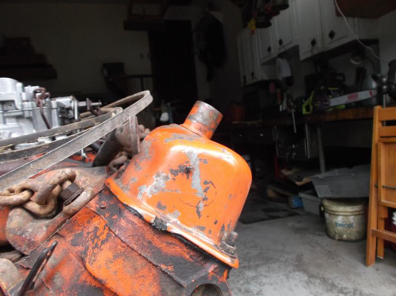

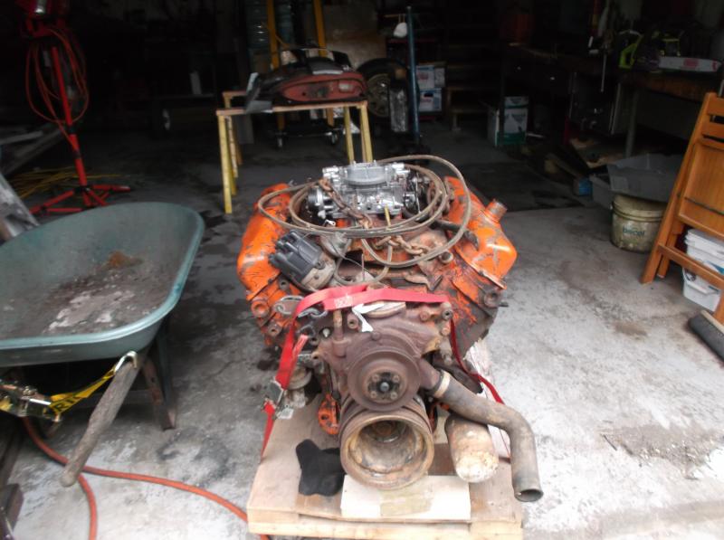

DSCF3186.jpgDSCF3187.jpgcan anyone tell me what the numbers on valve covers mean

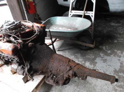

DSCF3188.jpgDSCF3190.jpgDSCF3191.jpgFORGOT HOW DIRTY THE TRANS IS WITH ALL THAT GEORGIA RED SAND

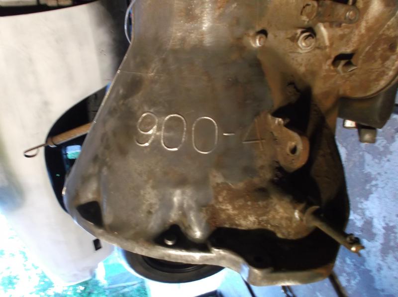

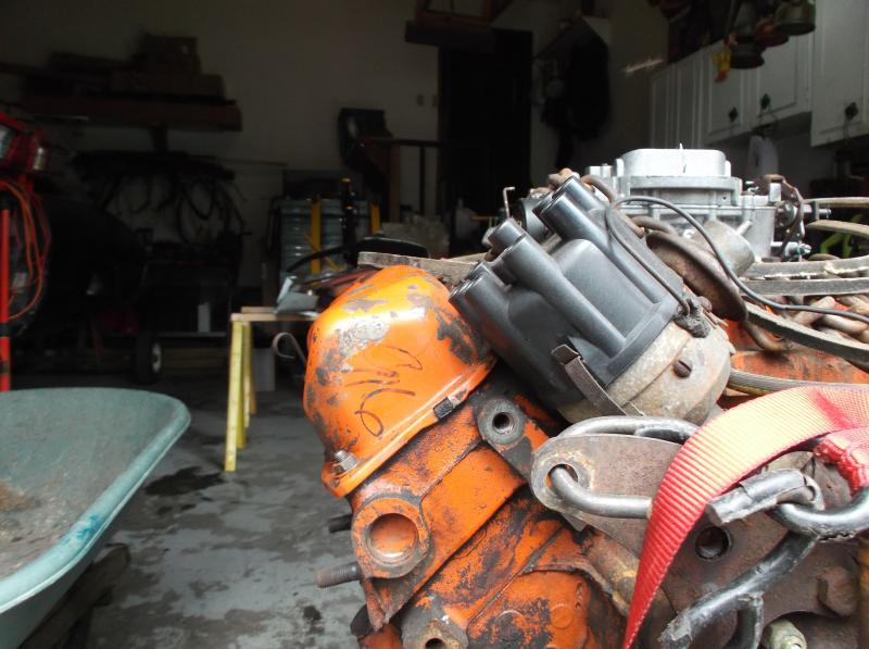

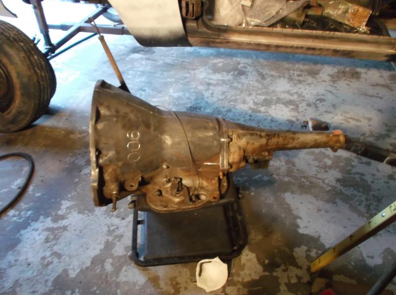

DSCF3193.jpgDSCF3194.jpgDSCF3195.jpgjust a quick update on cleaning duties on trans n motor n attached a couple pics to help identify trans n if its true to this car. Check previous thread to see how dirty it was.
Huge difference, looking like the body and the work you've done there! I know how much work all this is and wish you good luck with the engine!! :)
Looking good Steven!! Nice job replacing that mucked up patchwork, I remember doing the same thing like it was yesterday haha. And man you really went to town on that 727 from the black lagoon, looks like a whole different trans! Keep up the great work :icon_thumleft:
