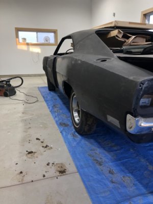

Now it is just the place and feel to see how you want it laid out! Looks like the car loves it!

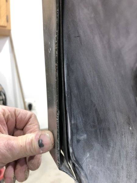

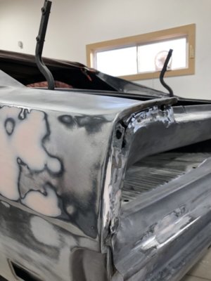

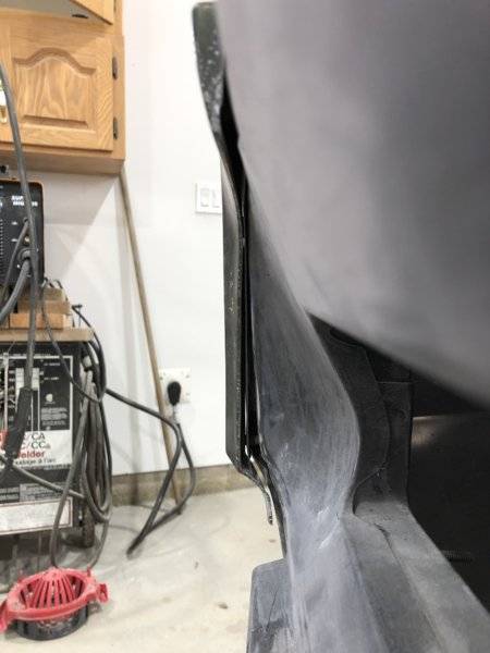

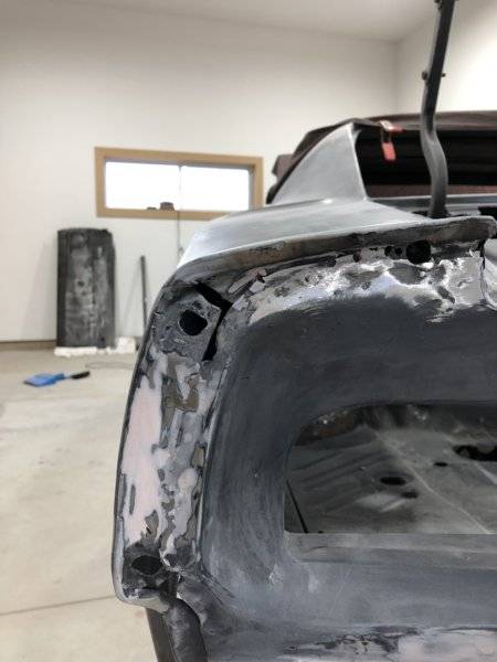

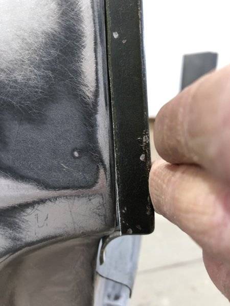

Are those after market end caps?Need a little advice on where I went wrong,and a possible fix,there seems to be a big gap on left hand end cap on the charger.The right side fits like a glove, all other areas line up fine,bumper,trunk lid etc,
Nope original to the car,is it possible these can distort over time?Are those after market end caps?
Was there some work done on that corner? Another question, is that cap tightened down?Nope original to the car, is it possible these can distort over time?
I think I had a little of the same problem on my 68, but can't tell from that pic. Can you post more pics, different angle views?
Ok, I see now, very similar to mine. I did several things to make mine better. They are now very close to right and most guys can't see any problem. I used glass filler to help, on the tail and the extension., just a tad of reshaping here and there. Before that tho, I also very carefully tweaked/twisted/and tapped on them to get them fitting better., but beware they will break easy.. If I were you I'd cut and weld some metal reinforcing to go inside behind the blown out area on the tail where they attach so you can snug them on. My problem was caused by a new tail panel not made exactly shaped the way they should have been used with my old original extensions.
