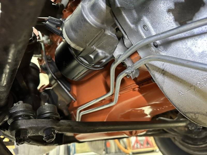

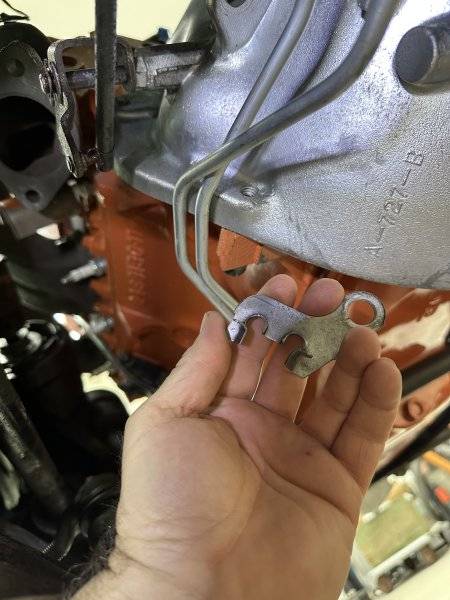

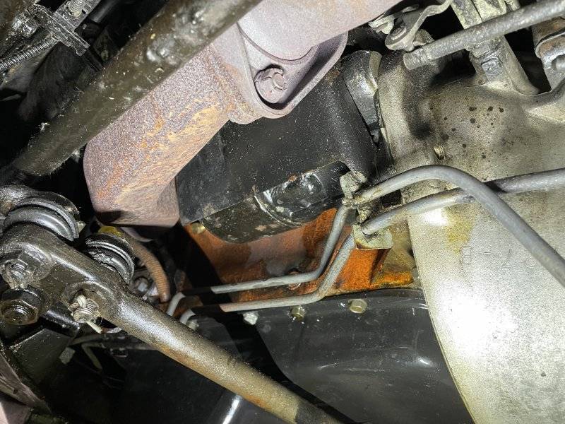

Looking for a picture of the correct location and orientation of this transmission cooling line bracket that bolts to the driver side transmission.

This was on my 66 Hemi.

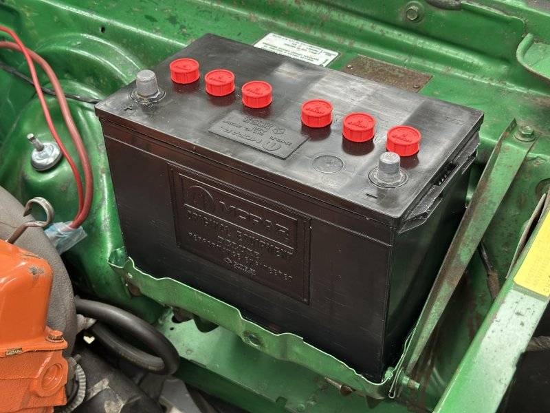

Instead of ordering the BCM battery and waiting for a year and a half I decided to go the less expensive route. I picked up a Diehard battery and Weskcar cap and label kit. I think it looks pretty good for the money!

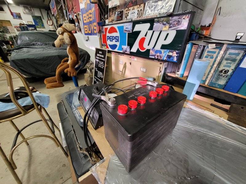

That's much nicer than their old offering of decals. Now it actually looks like a script battery !! Cut the carry handle end bosses off each end, polish up and damn near spot on to a real one as shown below.

I saved all the stickers and put the date stickers on the bottom and lower backside, and as soon as I feel comfortable that there’s no warranty issue with this battery, I will cut off the side handle mounts;-)

Yeah, the new decals look great! I’ll have to order up some more.

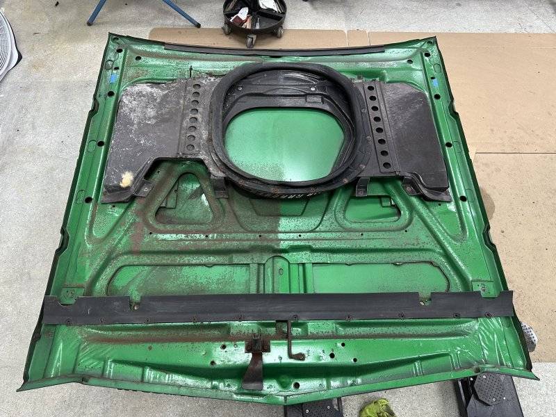

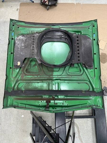

The worst part of this whole car was actually the underside of the hood. Lots of surface rust probably from condensation. The air grabber cleans up relatively easy with spray nine and a small brush. For the rusty metal I brushed on a product called On & off used to clean the waterline on boat. It’s a mild muriatic acid and it remove the rust from the surface without damaging the paint. Then I followed up using a color match green wax. Left right before and after;-)

Looks good! I've used that product before on the underside of my boat and the fumes it gives off are not good to breathe.
Yes, it gets very toxic when mixed with water, not so bad by itself. I would brush on Small sections. Leave it on for about 30 or 40 seconds and then wipe it off.
