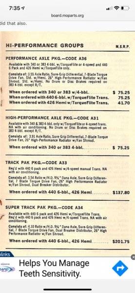

Axle packages for 1969-1971 8.75 are:
A31 high performance axle package 3.91
A36 Performance axle package 3.55
both came with max cooling, 7 blade torque drive fan, and hemi suspension.

4.10 gears were an option for the Dana, not the 8-3/4.

A Trac Pack car is a Dana and not a 8 3/4.
Track Pak
Code A33
(Available with 4-speed Manual Transmission w/ 440 or Hemi. N.A. w/ AC)
> 4-speed Heavy-Duty manual transmission with Hurst shifter with wood-grained shift knob and reverse warning light (available in Package only)
> 3.54 H.D. 9-3/4" Dana rear axle
> 7-Blade Torque Drive fan (Std. Hemi)
> Dual Breaker Distributor (Std. Hemi)
> 26" High Performance Radiator w/ Fan Shroud (Std. Hemi)
> Sure-Grip differential
Super Track Pak
Code A34
> 4.10 H.D. 9-3/4" Dana rear axle
> Power Disc Brakes

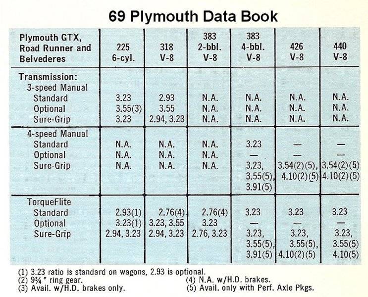

OK...let's try this....
