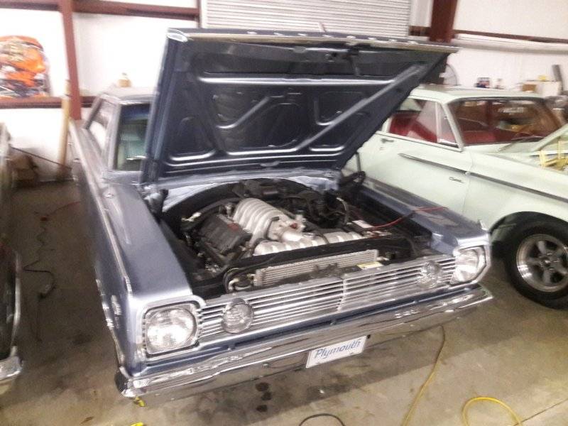

I'm at heart a stock person, but for your application I would go with a Griffin replacement aluminum radiator, they make one that is stock appearing that you can use your stock shroud and fan setup. You will have to paint it with a satin black, chassis black or to your preference. On special orders they put the inlets and outlets where you want them. I have one in my 66 Satellite and 62 Dart. At first glance in the 62 no one realizes it's not an original. On the 66 it was left aluminum for now. The 62 is over 500 HP runs a stock fan & clutch with no shroud. The 66 has a stock 425 HP Gen III Hemi with vintage air. It has computer run dual fans. Neither car runs over 170 degrees at any time. Don't expect to pay inexpensive aluminum radiator prices. With the investment you have in your engine and A/C system or your car in general don't cut corners here. Both my cars are 22" radiators.

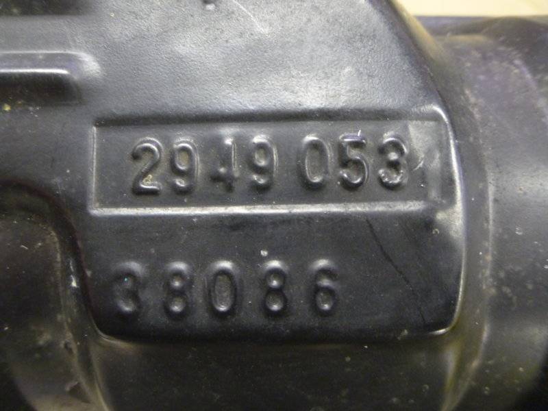

The only Factory # I see for '69 B-body, 383 & 440, is 2949053, 4-spd & auto. Contact Bob at Glen-Ray, as he may have one set to go, or build you one. Their product is "2nd to None"...

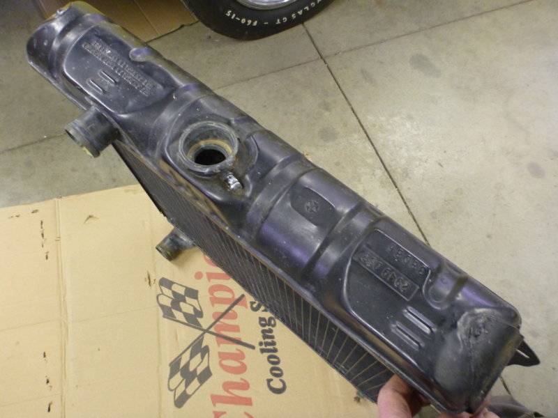

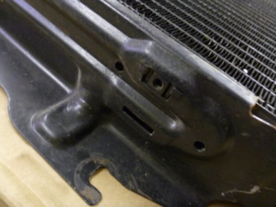

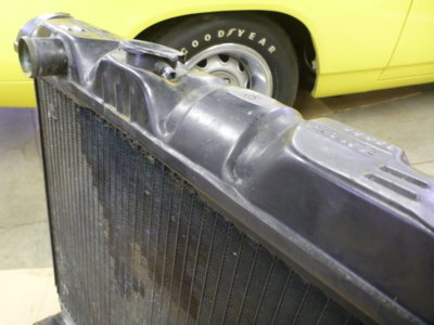

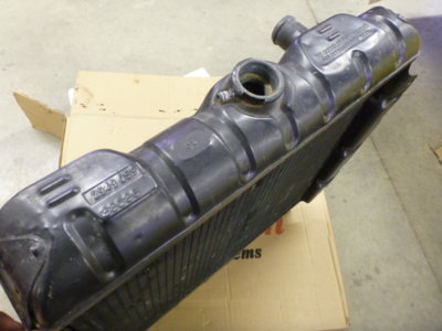

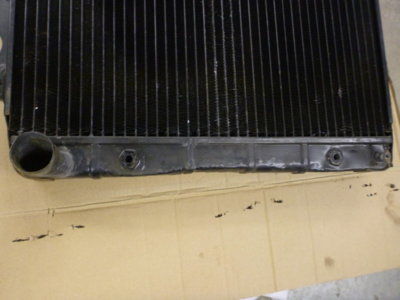

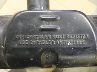

If you want to go "stock" I have an 053 x 22" radiator that is recently triple row cored and ready to go. Virtually dent free and darn near concours. $750US plus shipping. PM me if interested.
My two core 053 keeps my purple cam'd 383 right on the 195 stat on a 95F day... can't imagine that this triple core 053 wouldn't do the same for yours! Even has the lugs in place on the mounting brackets to install a shroud if you find the need.
radiator053 008.JPG radiator053 009.JPG radiator053 010.JPG radiator053 011.JPG radiator053 012.JPG radiator053 013.JPG radiator053 014.JPG
