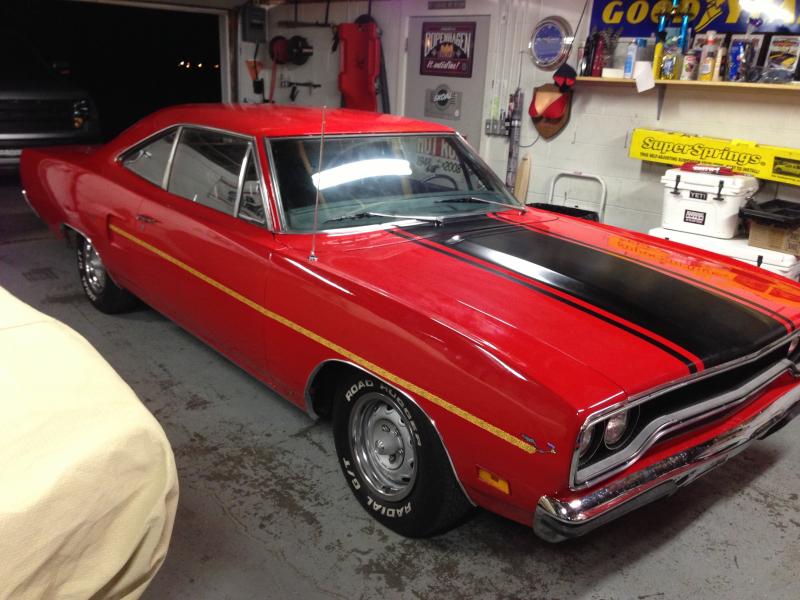

Getting ready to order parts for my dads car. Curious on thoughts for this engine build.
1970 383 bored .030" over
Stock crank and rods
Coated pistions, maybe forged.
9.5:1 compression
Stock 906 heads
4 speed car
Looking to run one of two cam packages:
Comp Cams Kit:
21-222-4 with XE262H grind
http://www.compcams.com/Company/CC/cam-specs/Details.aspx?csid=706&sb=0
or
21-223-4 with XE268H grind (Slightly rough idle)
http://www.compcams.com/Company/CC/cam-specs/Details.aspx?csid=707&sb=0
Also looking at running the Comp Cams Ultra Pro Magnum Shaft Mount Adjustable Rocker Arms and measured pushrods once length is acquired.
http://www.compperformancegroupstor...tore_Code=CC&Screen=PROD&Product_Code=1621-16
I will likely be topping it off with the factory cast intake and Holley 600CFM factory replacement carb I picked up for the car (only factory item the car is missing). Have a couple 750's laying around as well.

Car is weekend driver, fun car. No long hauls, but occasional 50 mile weekend trip (maybe more, maybe less).

I take it this is a 70 Roadrunner that the engine is for. Is the car an Air-Grabber equipped car? If so, then carefully consider any aftermarket intakes with height in mind. You need to make sure there is sufficient clearance so as not to interfere with the Air-Grabber box and baseplate when the hood is closed.
