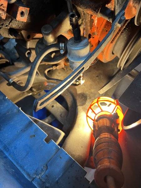

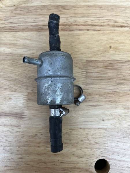

Try to figure out what this part is. I can’t seem to find it in any shop manuals. It’s located by the fuel pump. I don’t believe it’s the fuel filter.
Aftermarket replacement for the original vapor separator.
