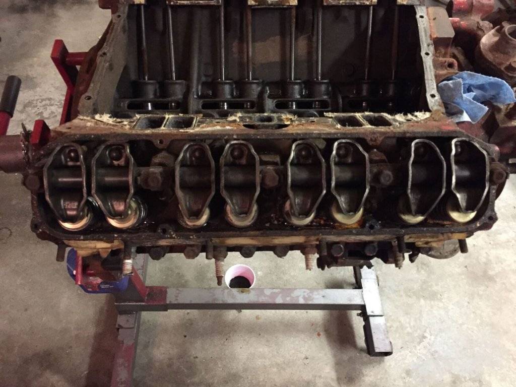

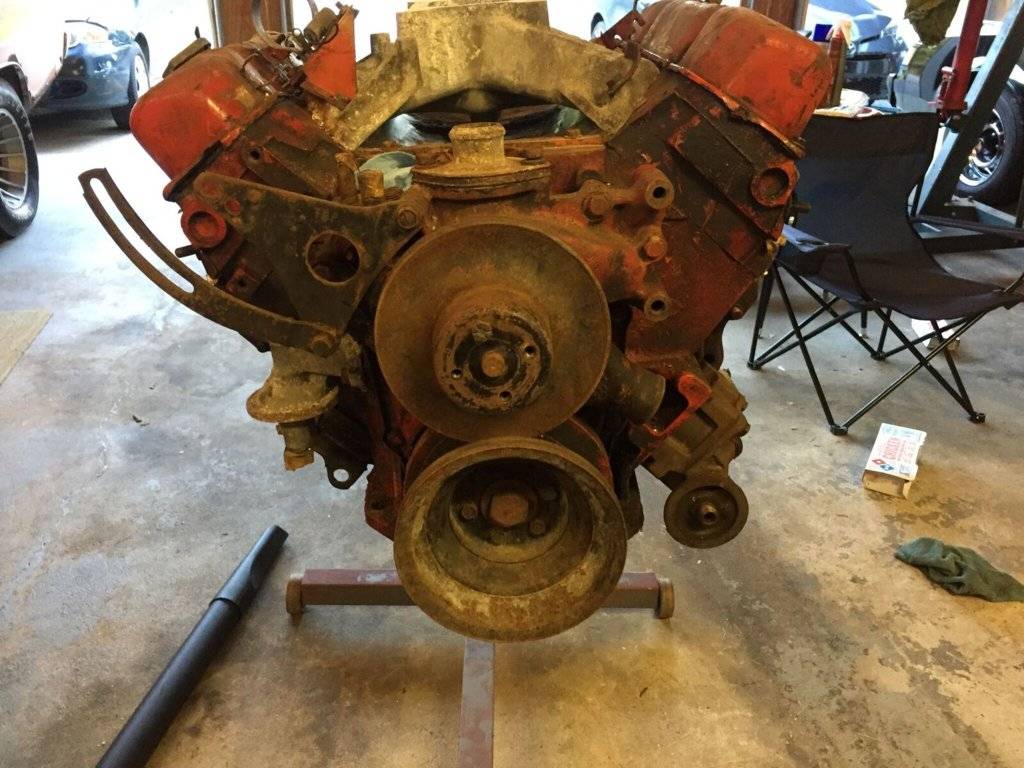

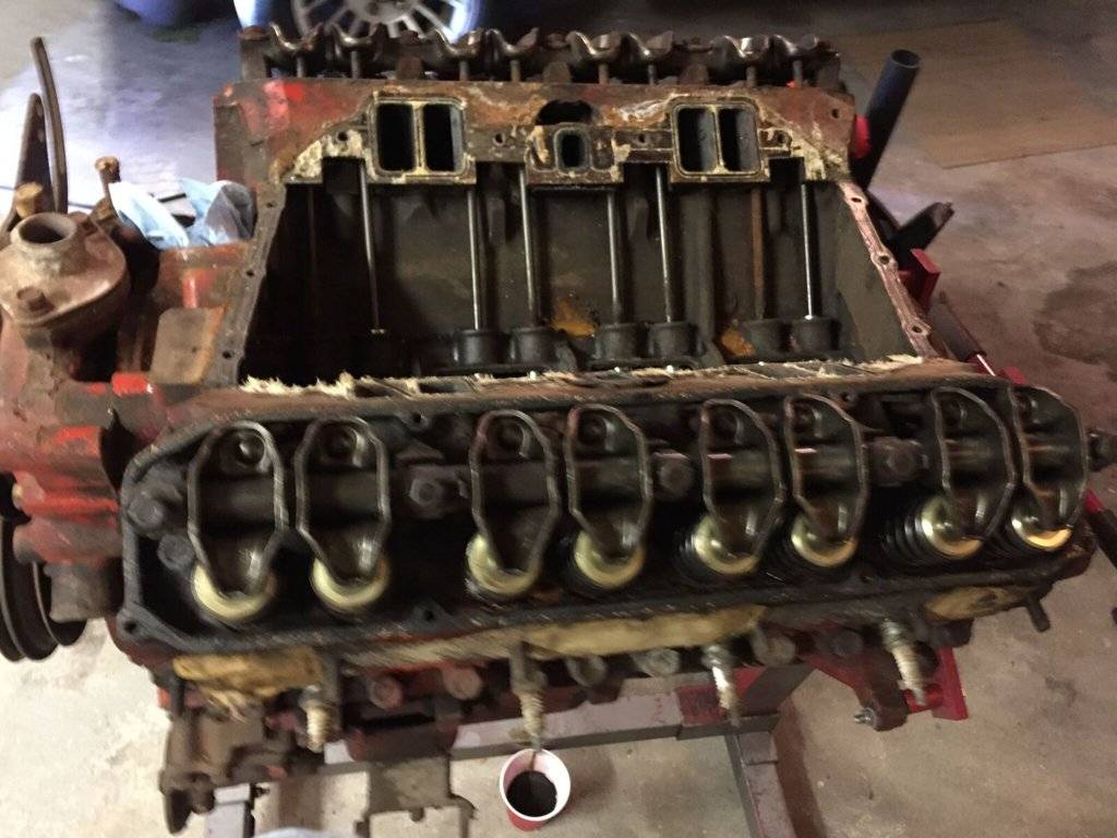

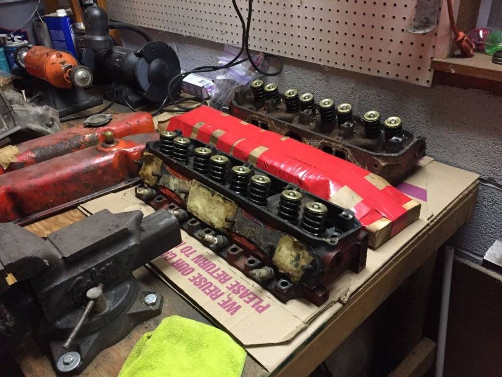

My roommate and have been cranking away. We started with the interior and tear down of the 440. Roughly 5 1/2 quarts of oil came out and 1 1/2 quarts of water. Not off to the hottest start. It's evident that this motor has less than 4,000 miles from the rebuild in 1975. the lifters are perfect, the crank is balanced and brand new. The cylinder walls have virtually no wear.
However, not all is well. It was locked solid- due to the rust buildup on the wrist pins. After weeks of lubrication, it has finally moved a quarter of a turn each direction! That's good enough for me. We've consulted with a few machine shops and Mopar guys. The move going forward will be to bead blast the rods, install new wrist pins and clean/hone the block. It will also need a valve job, as the current retainer caps are aluminum.

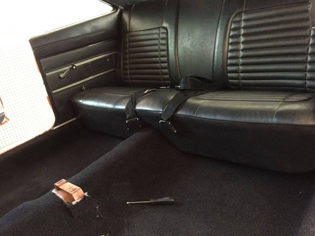

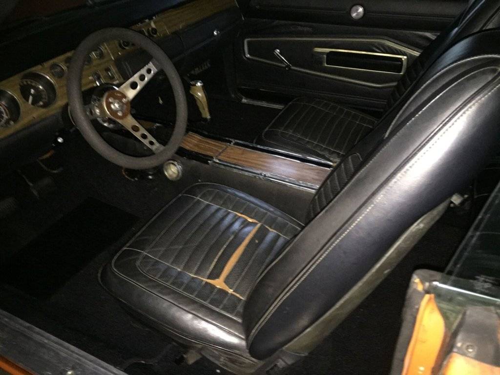

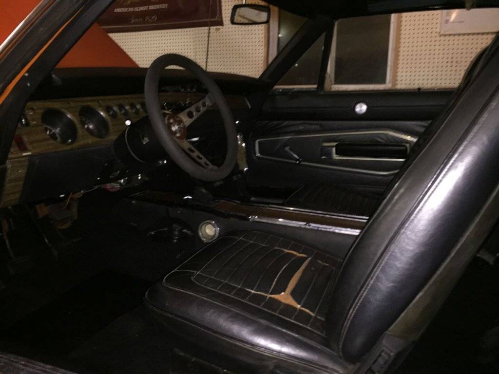

Next was the interior.

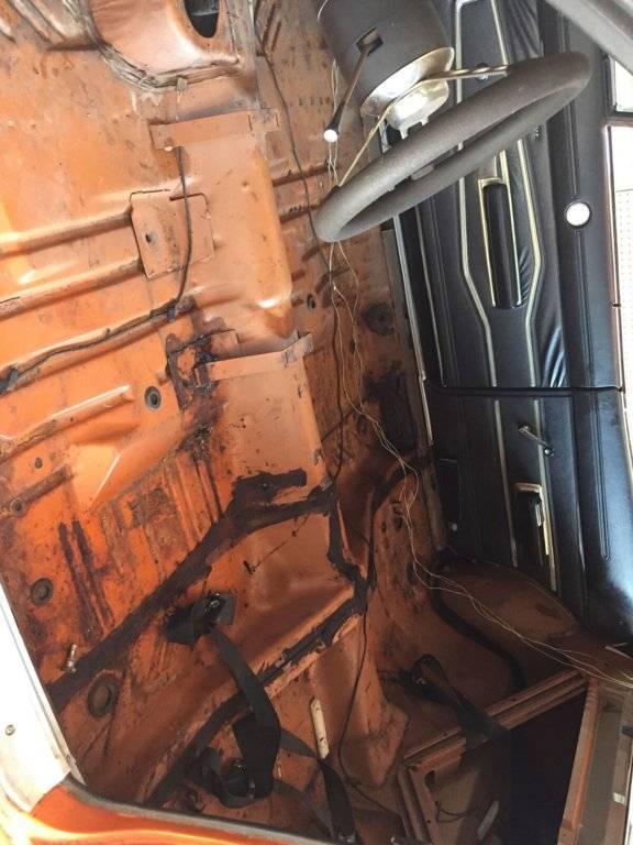

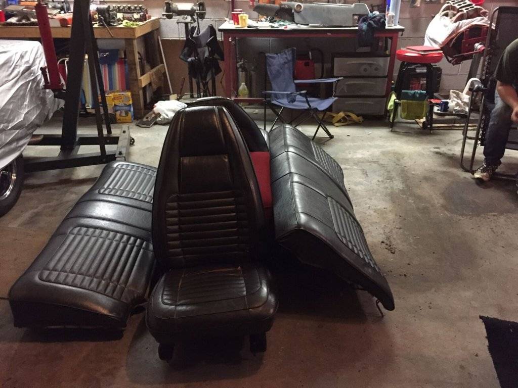

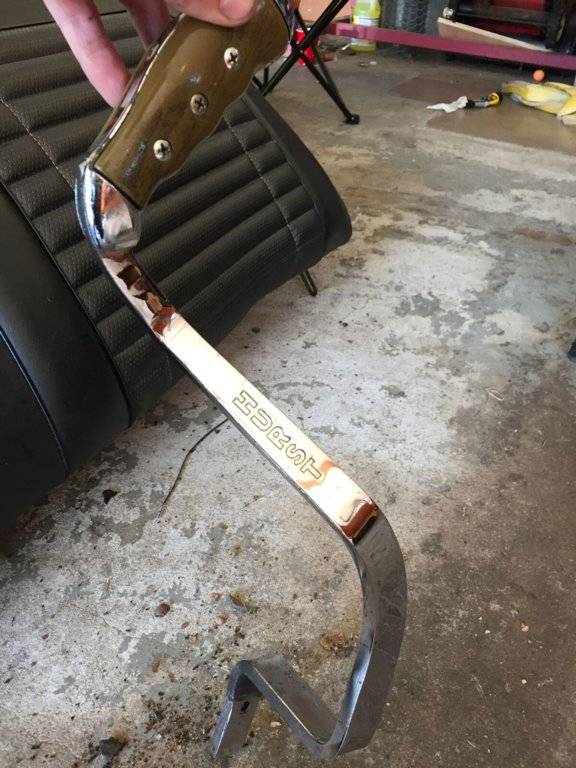

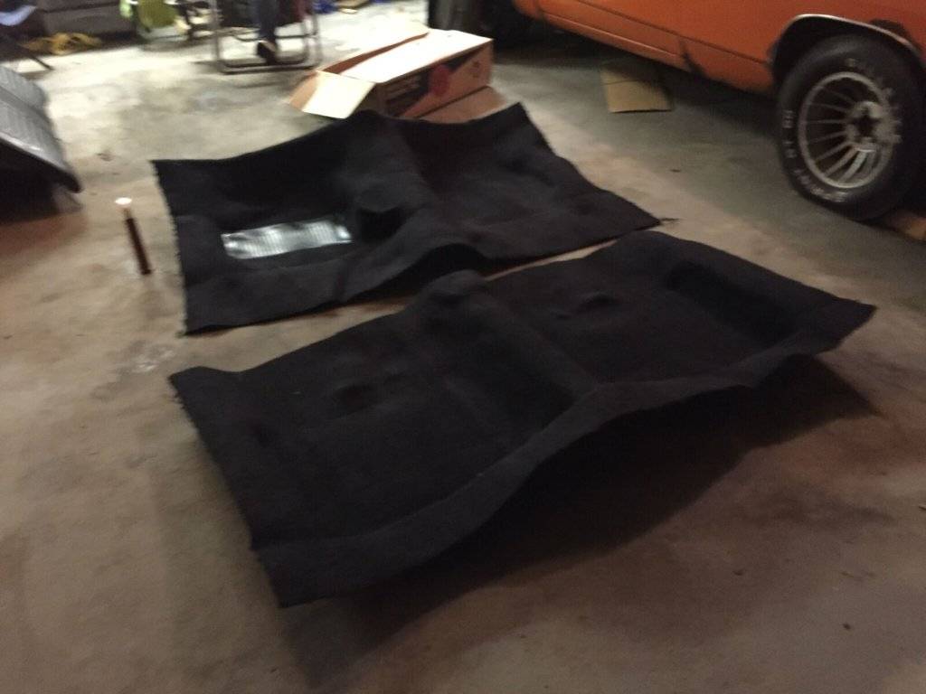

Sam, the previously mentioned roommate, pulled the original buckets and back seat out of the car. I struggled to get the Pistol grip released from the A833, but after a few broken tools.. it released. Next was fitting and trimming the carpet. Not a hard job, just time consuming. Meanwhile, Sam spent hours detailing the console, including buffing out the bright work. I brought the Shift handle back to life. We treated the leather, and threw everything back in. My Dad came down one Sunday to install a new ignition switch (missing original key) and we fired the 64 426 off.

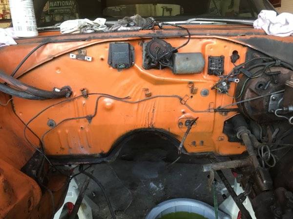

During the week we dropped the old rotted gas tank. Unfortunately, most of the trunk floor came out with it. It will need a pan. Add it to the list! Also, Sam and I managed to spill roughly 6 gallons of 25 year old gas all over the floor.

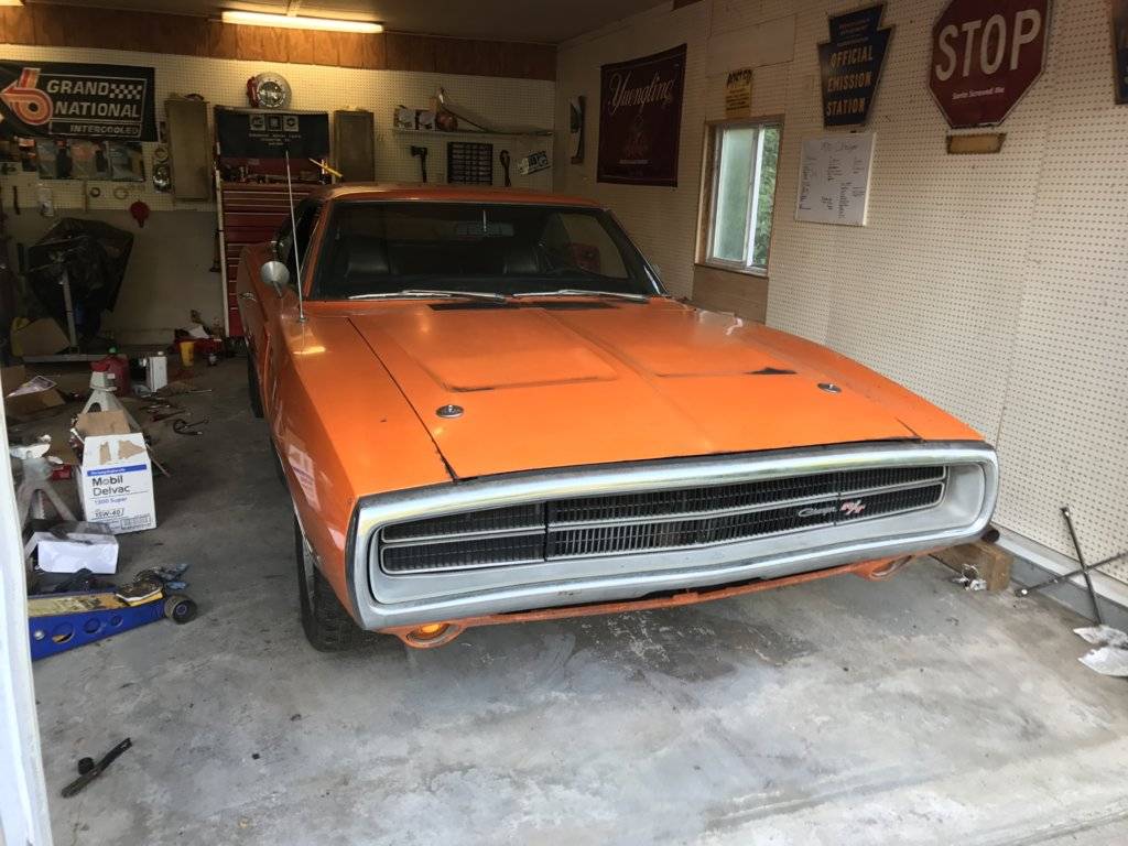

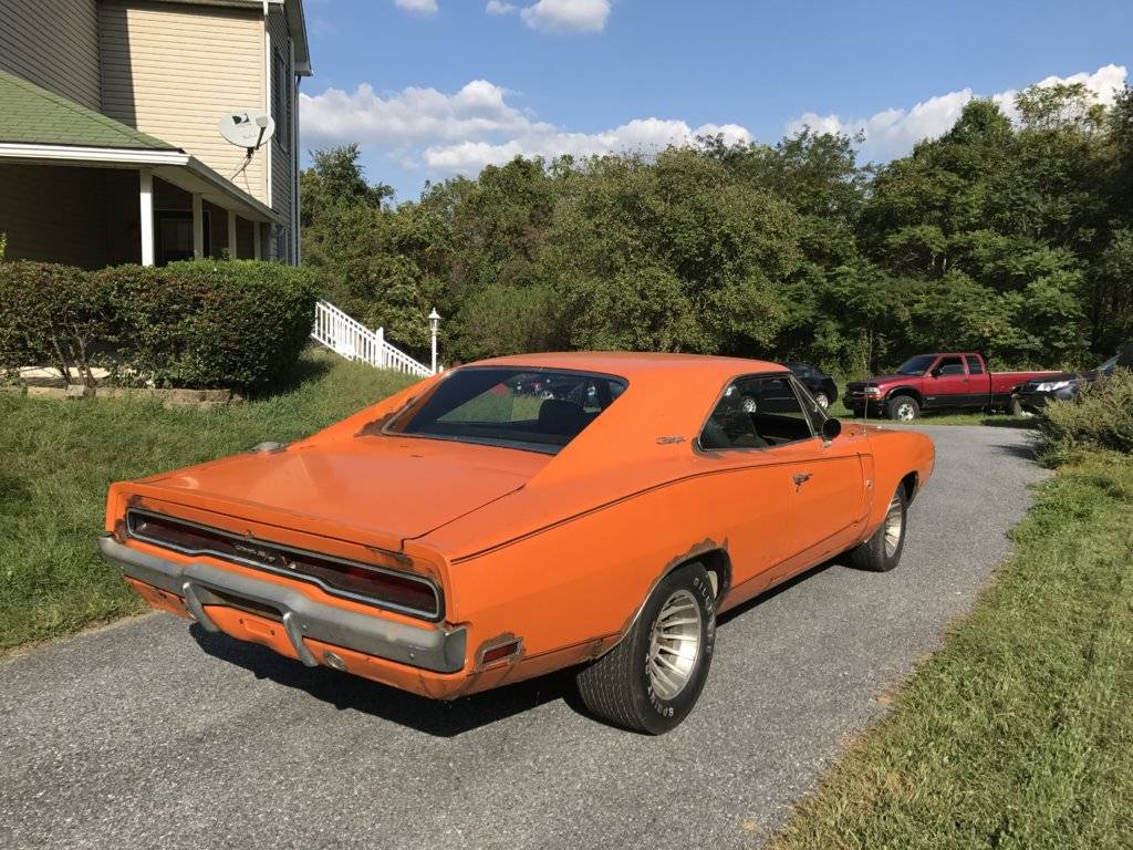

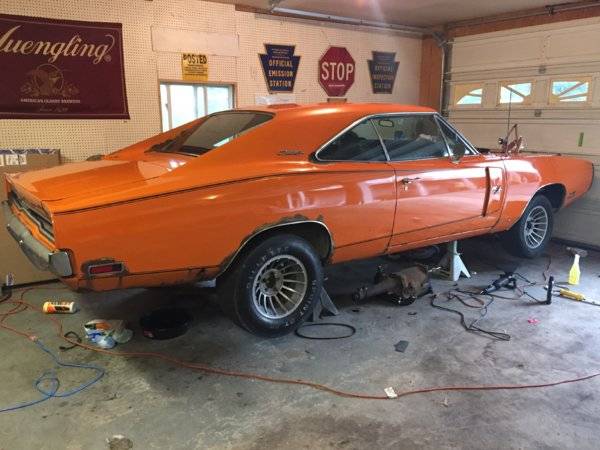

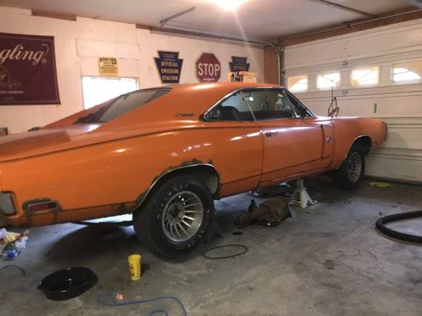

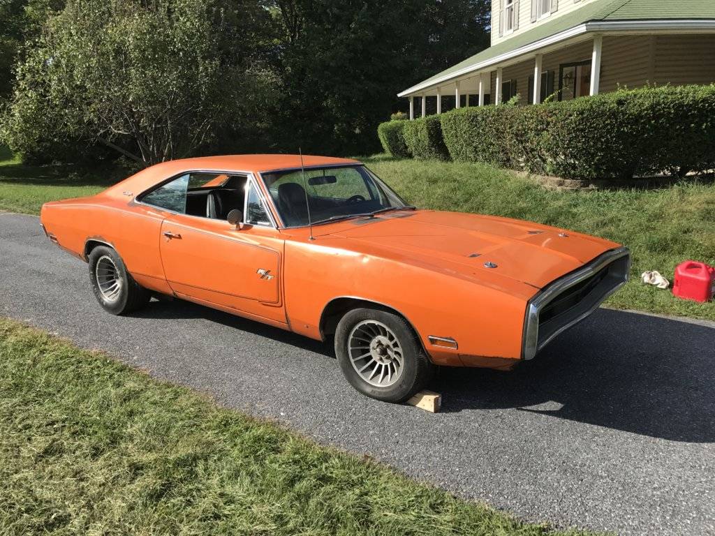

After rigging up the fuel system, the charger made its maiden voyage. It idles, shifts, and drives pretty well. It even roasted the tires in second! Enjoy the pics, the whole purpose of getting it running/driving was to flip it around in the garage so we can start pulling the 426. More updates soon.

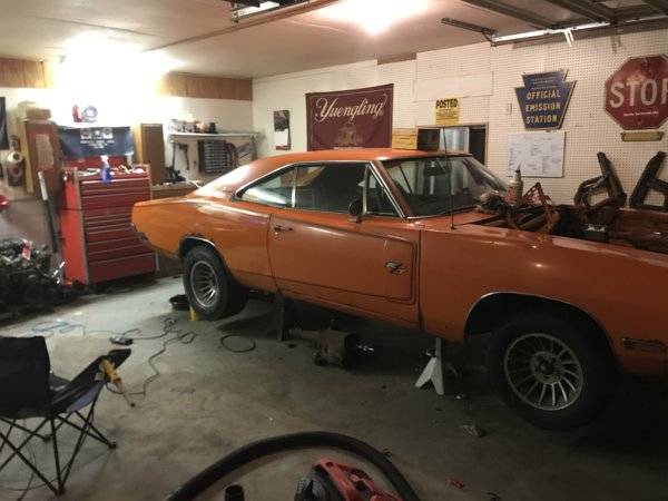

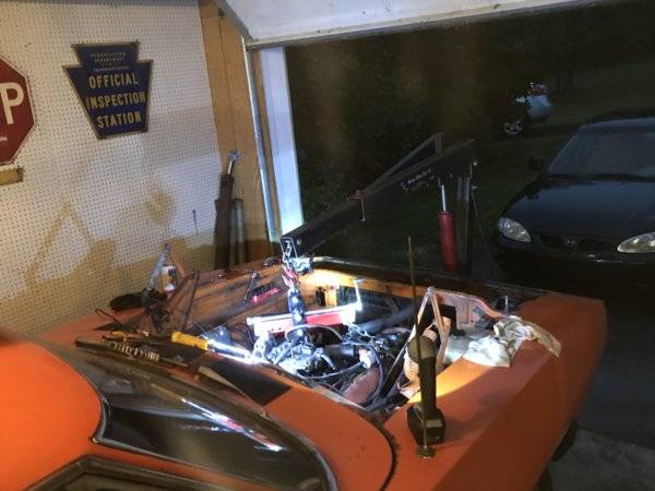

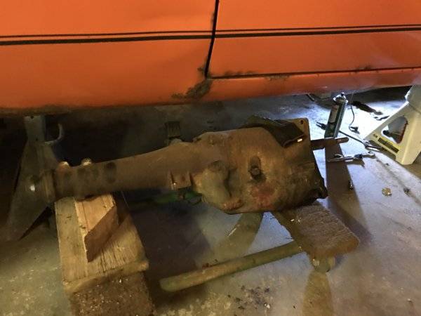

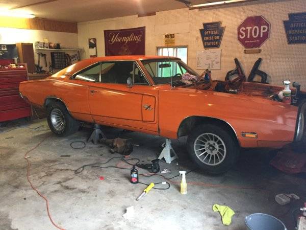

Then it was time to pull the engine and trans. The A833 is the correct 18 spline numbers matching trans. The 426 and headers played along nicely to pop out.

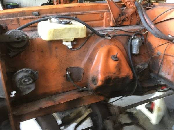

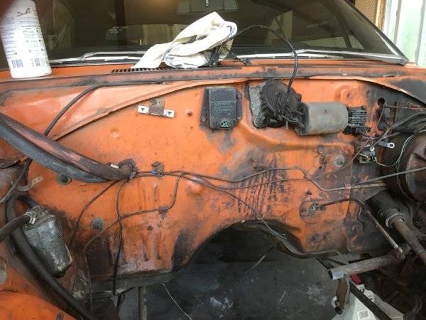

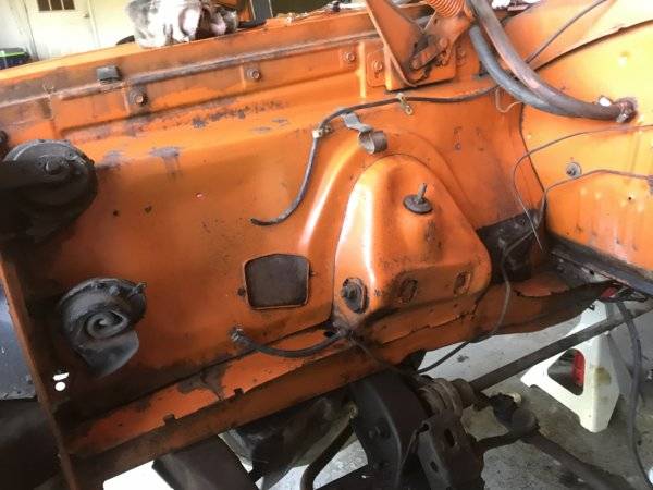

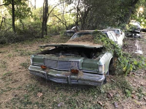

I was also treated to the surprise that my neighbor found the original exhaust manifolds!! As it turns out- the original hoarder of all this stuff would take apart things and "hide" them in the 50 or so junk cars laying around the property. This includes 383s laying in back seats. The New Yorker pictured below had the manifolds in the trunk. Attached are a few pics of the other gems for sale.

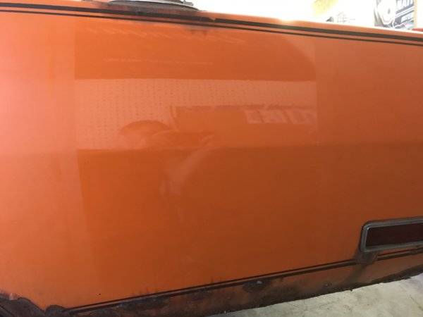

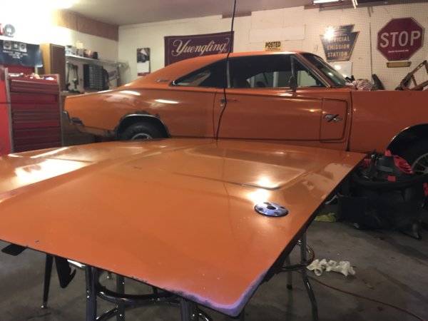

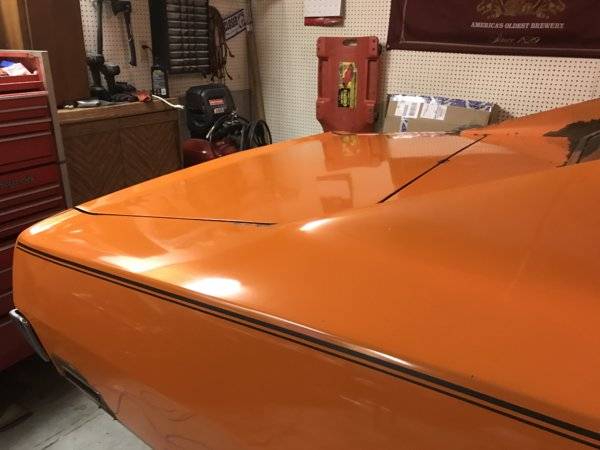

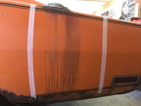

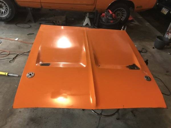

Bought a Meguiar's DA buffer kit to get an idea of how much of the Charger's original paint will come back. I decided to tape off a small section of the worst oxidation. Wow! Check out the result below.

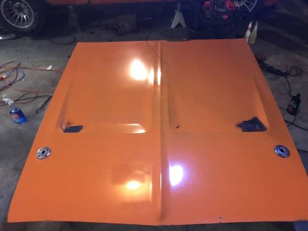

This thing is going to be so cool when it's done. A little detail work on the quarter and trunk lid.
This thing is going to be so cool when it's done. A little detail work on the quarter and trunk lid.View attachment 525011View attachment 525008View attachment 525009View attachment 525010

Appreciate the kind words! Sam buffed the rest of the passenger side. It came back really nice.

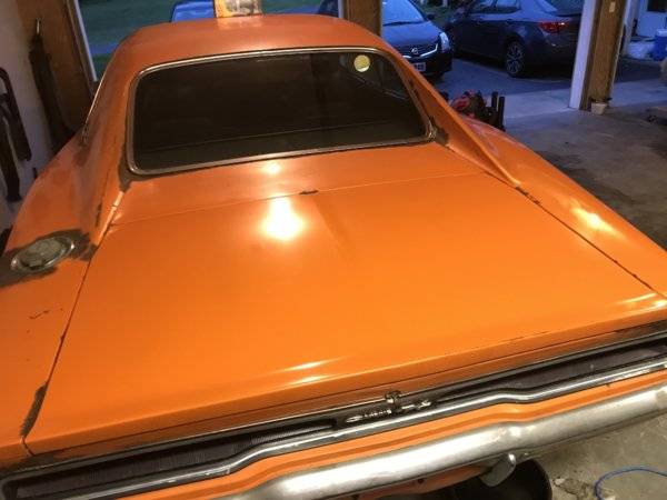

The last detailing post for now. Replacing the trunk pan this weekend!
Love the way you are protecting this car's heritage.

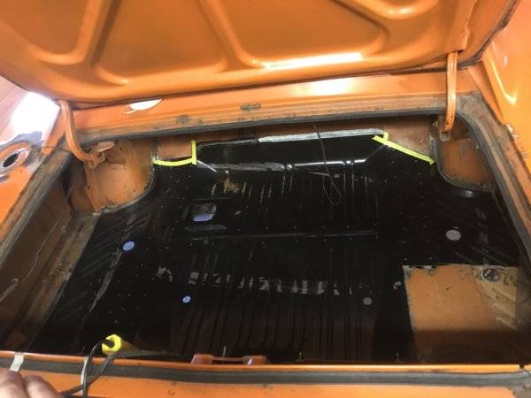

Still plugging away. The trunk pan is just about ready to be zapped in. After a lot of deliberation on how to go about replacing the pan, we decided to save as much of the original as possible and cut the 1 piece pan as needed. Really happy with how it's turning out.
