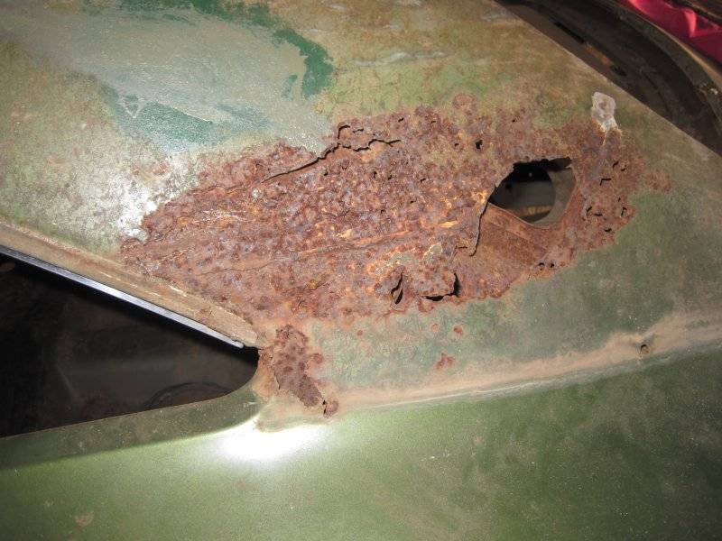

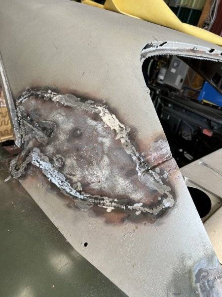

I have 3 spots in my rear window channel also....how are you planning on fixing yours ? Im so thankful my 440 didnt have a vinyl top n came from AZ as there is no way I could do the metal work u have done ...
SKILLS !Nice patch work. How do you like clecos?

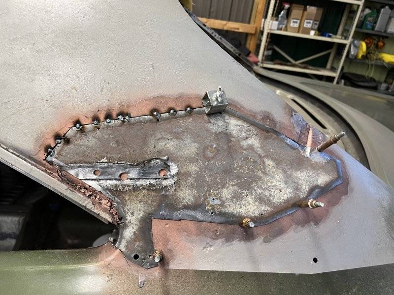

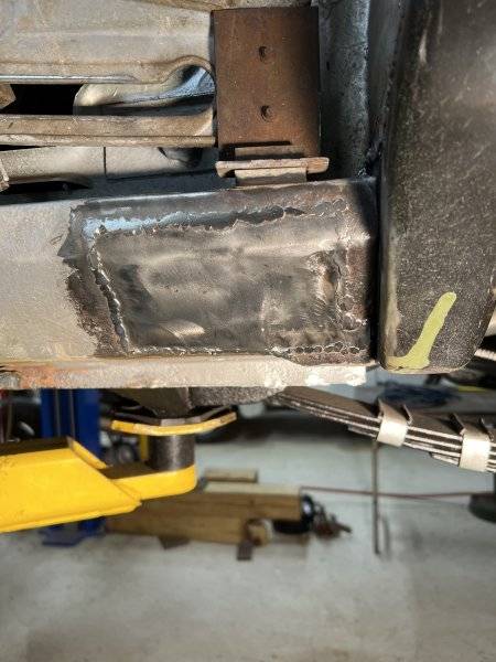

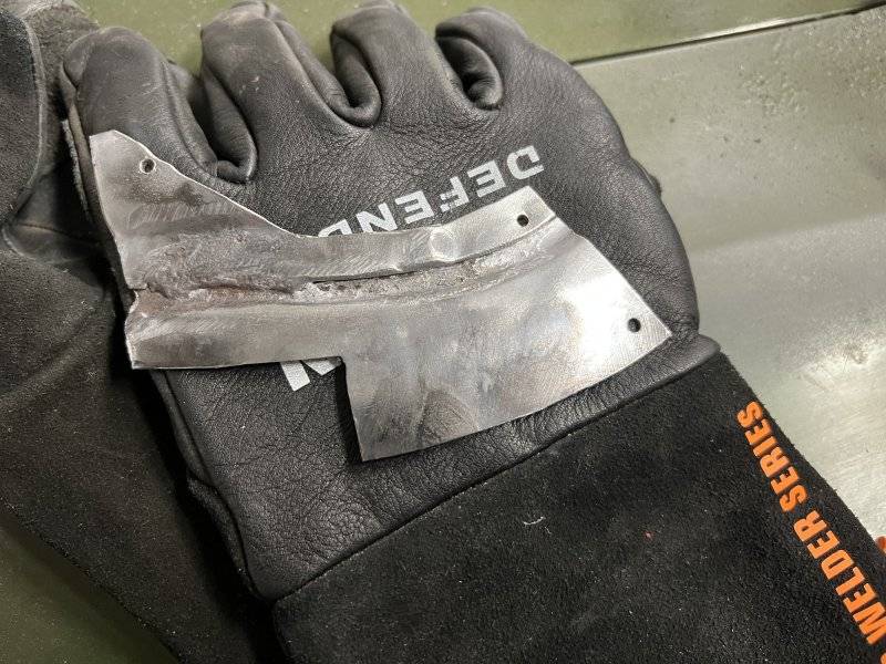

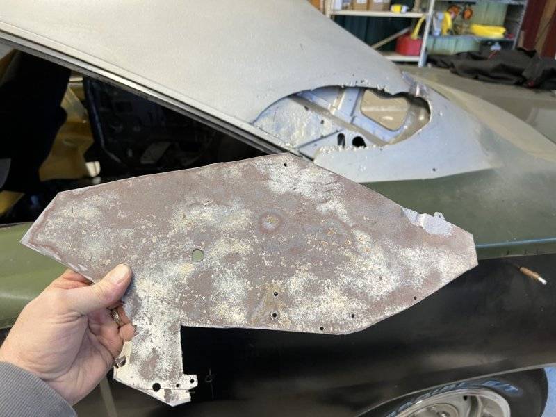

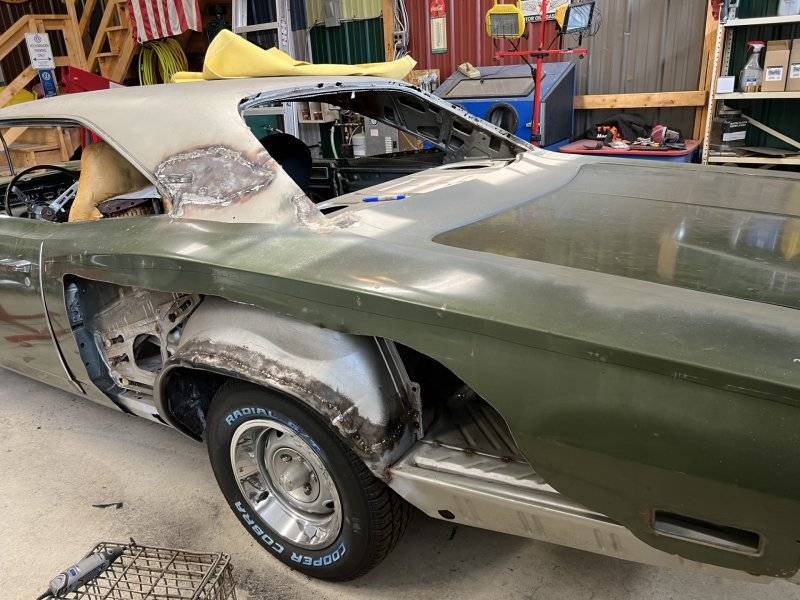

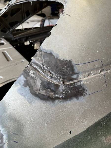

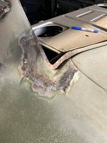

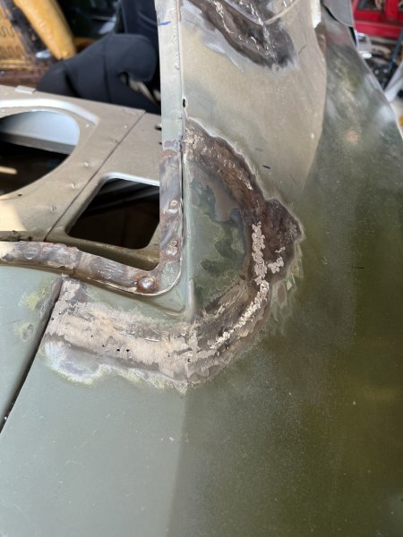

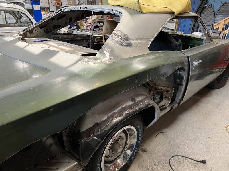

This is the second time I did the bottom corners. The pieces from AMD are a great start but the don’t just drop in. The first time I did them, I lap welded them…just because it was easier. I hated the way they came out. I would need too much filler to level them out. Since then, I’ve done a lot more welding, purchased a better welder and worked at getting better. Eldubb440 suggested that I fix the corners. So I cut the corners free, hammered and dollied the **** out of them and butt welded them back in. So to answer your question…..you can fix the holes many different ways. You can lap metal patches in or use a body panel patch and it may look OK when you are done. but I am going to remove the rusted metal and butt weld the patches in. I still think my welds could improve. I am getting better the more I do. You can do it too. It just takes patience, time and good equipment.I have 3 spots in my rear window channel also....how are you planning on fixing yours ? Im so thankful my 440 didnt have a vinyl top n came from AZ as there is no way I could do the metal work u have done ...
I like the clips. They eliminate the need for a helper on the big pieces. You have to leave a little tab on both pieces until you weld or they don’t work for butt welds. They are perfect for lap welds. I started using magnets to hold small pieces in place.Nice patch work. How do you like clecos?
I have some window channel that came from the rear window of a 68 4 door SATELLITE I will now use ...its solid as a rock....This is the second time I did the bottom corners. The pieces from AMD are a great start but the don’t just drop in. The first time I did them, I lap welded them…just because it was easier. I hated the way they came out. I would need too much filler to level them out. Since then, I’ve done a lot more welding, purchased a better welder and worked at getting better. Eldubb440 suggested that I fix the corners. So I cut the corners free, hammered and dollied the **** out of them and butt welded them back in. So to answer your question…..you can fix the holes many different ways. You can lap metal patches in or use a body panel patch and it may look OK when you are done. but I am going to remove the rusted metal and butt weld the patches in. I still think my welds could improve. I am getting better the more I do. You can do it too. It just takes patience, time and good equipment.

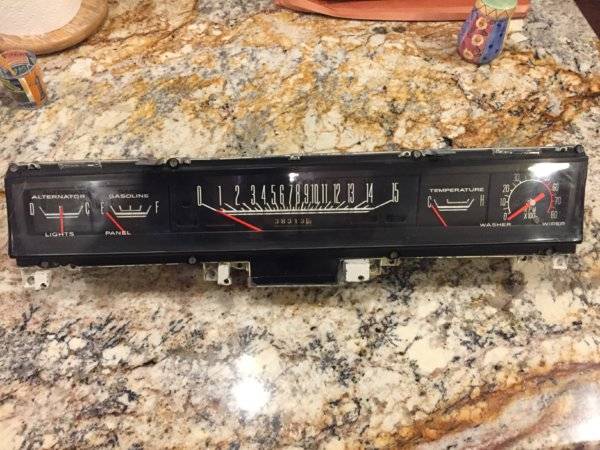

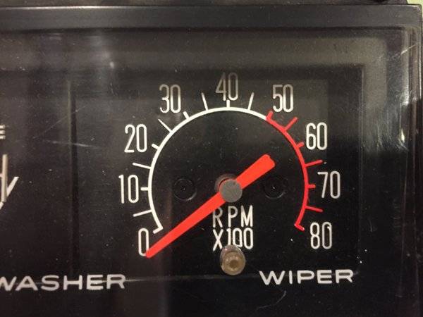

Is your tach 70 specific ?...I thought these tachs would not work on electronic ignition cars ?.. Also do you have any fuse clamps left ? I'm adding the same tach as you and need to do what you have done. All salvage yards around here just scrap the old cars they take in so I've not been able to source any fuse boxesI got a new tachometer for Christmas this year. It's from my wife. She is awesome. She ordered it from Year One. I like the way it looks in the dash. It's funny how they tell you not to rely on this tachometer for racing.
