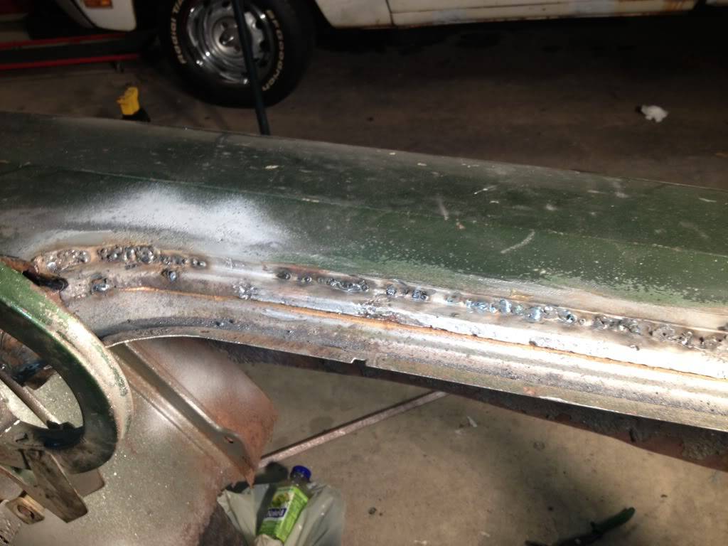

I still have some minor trimming and I have to finish the lip of the tray but I cut out the old filler and have started to fit in the new piece. looks like it around 1/16 or so wider than the old one. should not be a problem since I have to put in the new window corners in anyway. I was going to use the lower corners from a doner car but they had rust too. So I have amd corners now. Does anyone have a link to someone who details the corners of the back window?

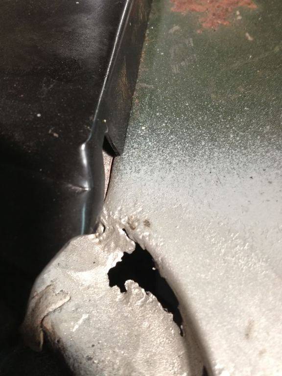

Thanks Propwash. Your posts are truly inspirational and the amount of work you have done is amazing. I see how the factory corners assemble. The corner is two sections. One for the window frame and the other the rear quarter. But AMD has reinvented the corner by making it one piece with the quarter panel now. I ordered the set and it seems to have the same piece repeated. What I mean to say is that the little pieces look like they are already incorporated in the larger piece. I tried to put these together but I am confused.

Could one be the inner part and one the outter? Mine needed those corners as well and when I started they were not made. Wish AMD would make complete shells of cars and give them a vin# and sell the bodies. I would love to build a hot rod but not mess up and original car.

Thanks for the kind words Dasfusca. Appreciate it. You the same have a momentous task and the work completed/at hand is quite admirable. Sure would have been nice to have a one piece like that, would have warranted some less stressful thinking and work.

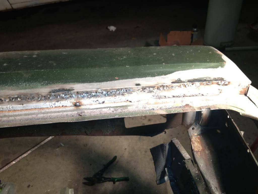

Here are pictures of the final fitting of the rear panel. It took forever to get to this point. Next I will work on the corners of the rear windows. I laid the pieces in to show where they go. I was right about only needing the larger patches for the corner. I don't know why they sell the 4 together?
I was stuck on this for a while. I was going to find new full quarters for the 70 coronet. But no one makes replacements for it yet. I bought new quarter patches for the entire outside but they do not extend to the drip rail of the trunk. I had some rust along the rail that needed to be addressed. I sand blasting the rust out of the drip rail and restitched the quarter to the rail with my mig. I sistered some metal behind any holes and welded it all back together. The welds will be hidden in the seam of the rail. After I grind it down it should look better.

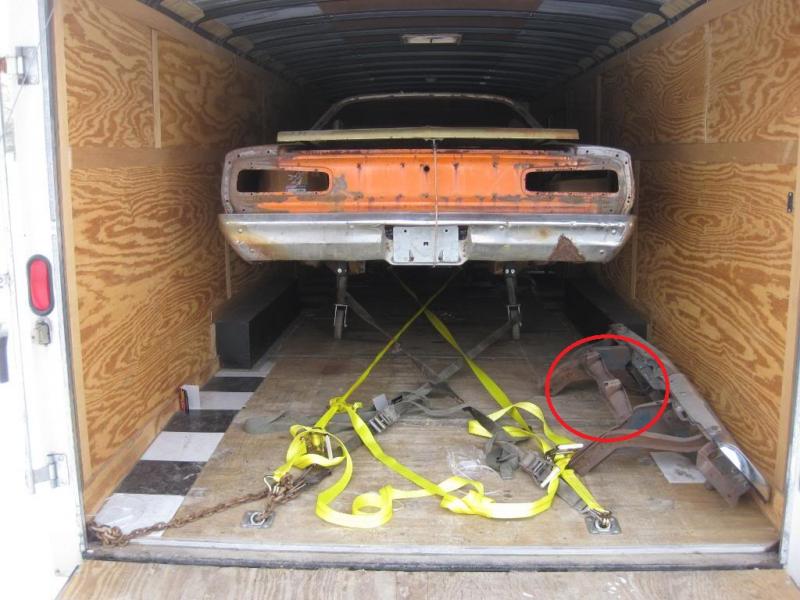

What is this crossmember (red ring), I don´t have it on my car?
Do you have some more pictures of it?
that's for the front bumper. "68-'69 Chargers had'm too.
