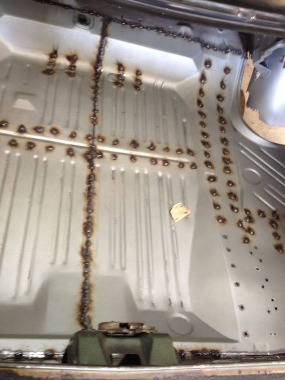

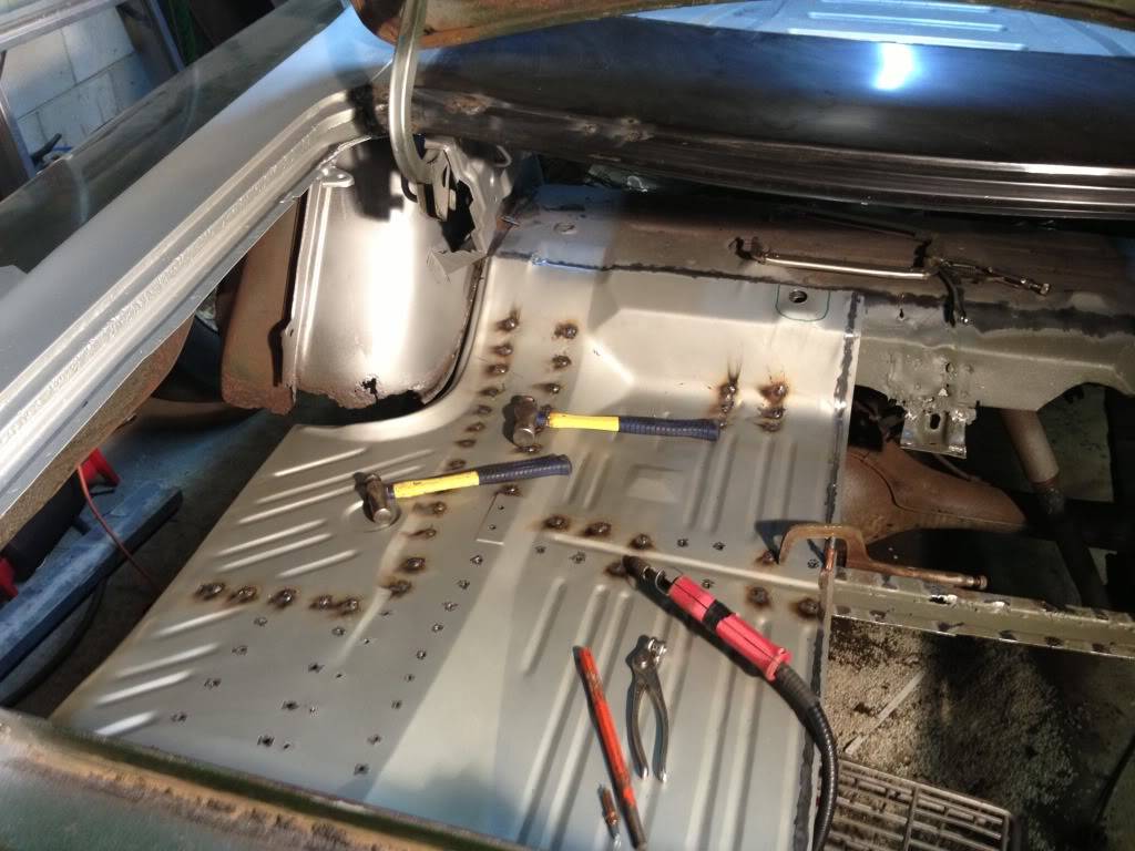

Had to remove the paint from where the new welds would be
Moving forward. should be done the trunk pans Monday night

Plug weld,plug weld, and more plug welds. After only a few welds, I decided to increase the size of the plug holes i drilled so I could get better penetration into the rails. The brown marks around the welds is the rust bullet reacting to the heat. I cleaned the paint from around the holes before I welded. I will sand and repaint after I grind down the plug welds to be a bit flatter.

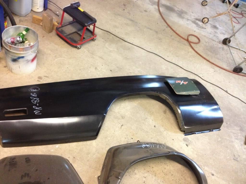

Here is a shot of more metal that is going into the car.
I am using a mix of AMD and some older sheet metal. The older stuff is supposed to be made in the USA.
