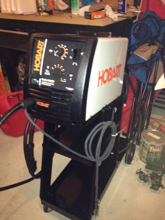

I have a new welder.

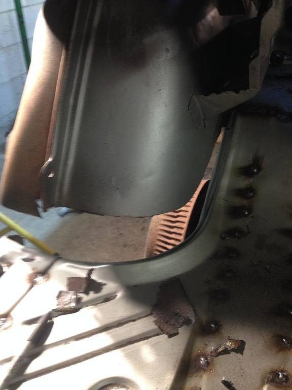

I also started fitting the inner wheel wells.

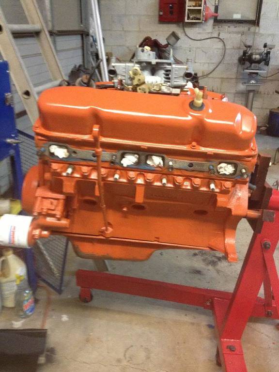

I am still going to eventually fix the original numbers matching motor. This new one was for someone else's project and they went in a different direction. It's Fresh out of a PennDel performance and machine shop. It is a 1976 block, 30 over bore, cast crank, hardened seats, bronze valve guides, 23204 melling cam and it came with a brand new 80508 750 Holley carb and an electronic ignition and distributor that looks like a stock mopar.
Nice welder and I see you wasted no time putting it to work. motor looks great. Put it in your car when you get ready, that will give you something to "romp" around with till you get the other motor done.

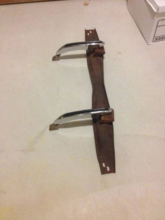

I bought these cool bumperetts. I did not know they had a big metal support behind them. Now I am looking for the rear ones.

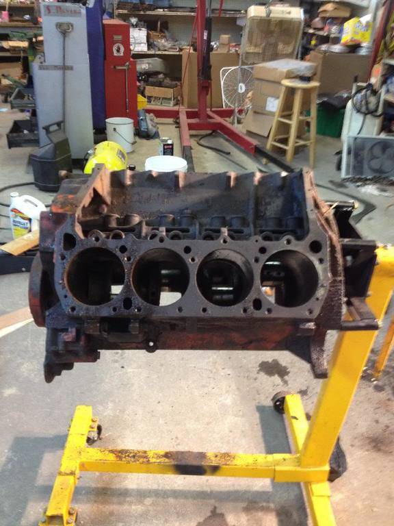

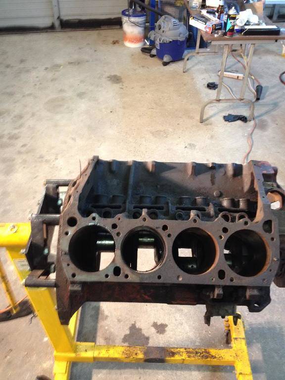

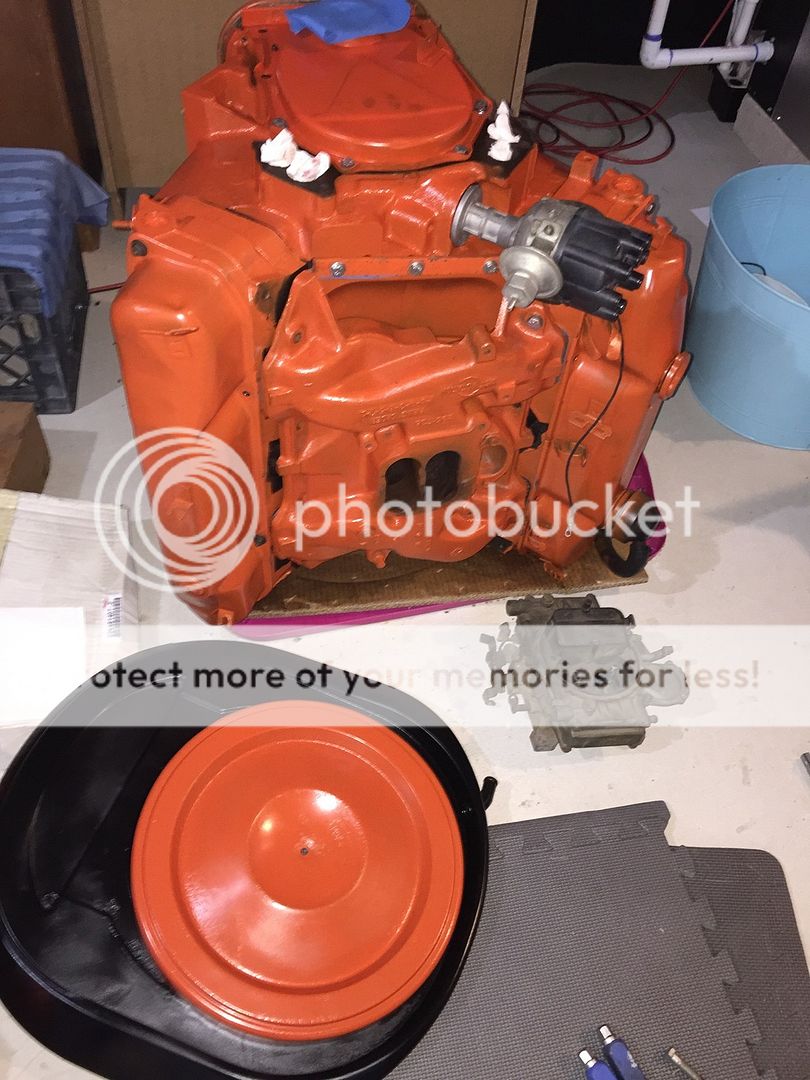

Great news!!! Today I actually got the last two seized pistons out of my block. I soaked these things for over a month. They eventually tapped right out. It is the original block, but it’s going to be put together slowly while I drive around on my rebuilt 440 for a while. Maybe years....Who knows.
I am not positive, but this center bar looks like a 68-69 Charger piece that someone welded on a couple of brackets to. Maybe one of the Coronet guys could chime in to be certain.

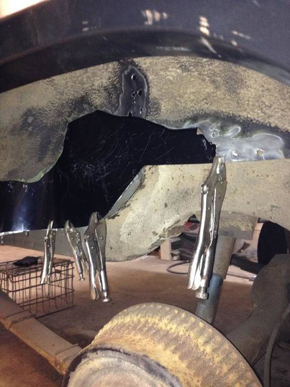

I finally got around to welding in the inner wheel wells

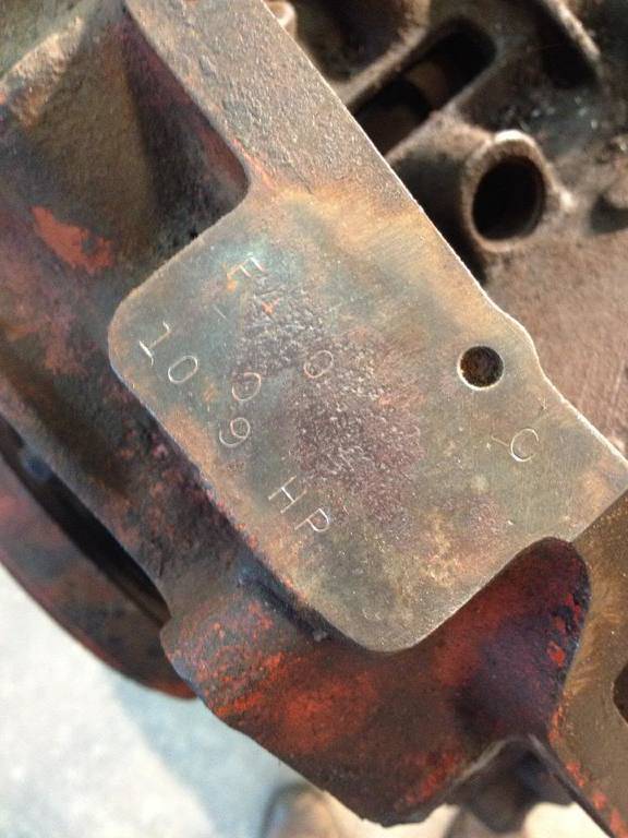

This is the original numbers matching 440 hp engine for this car. I had it baked clean and magnafluxed. The machine shop said it was a good block and rebuildable. I am going to leave it "mothballed" packed in grease and wd40 for a while and I will use the replacement 440 with all the 1970 parts on it that sits on the engine stand in the car.

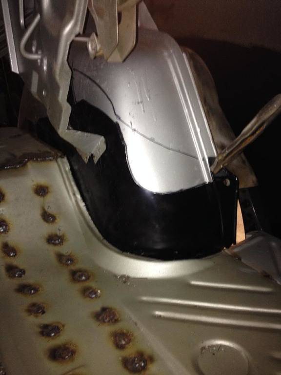

I am continuing to work on the body. This is the first fit for the outer wheel section.
There were some cracks that I welded up inside the rear quarter panel area.
