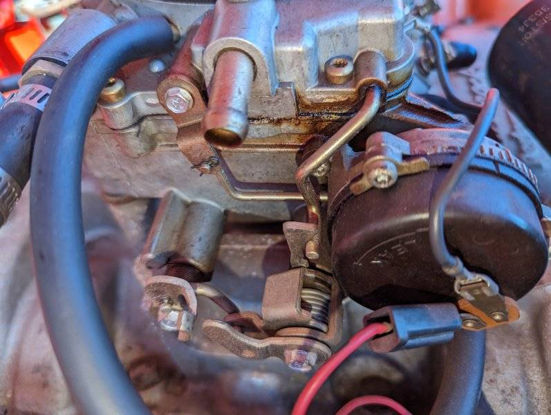

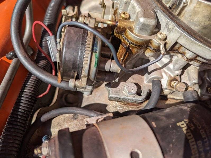

Bottom left on the front base , next to the mounting bolt or stud , will bee a carb number #
Give it to us
A lot of those Carter Carbs have been exchanged or replaced over the years
We need a Carb #

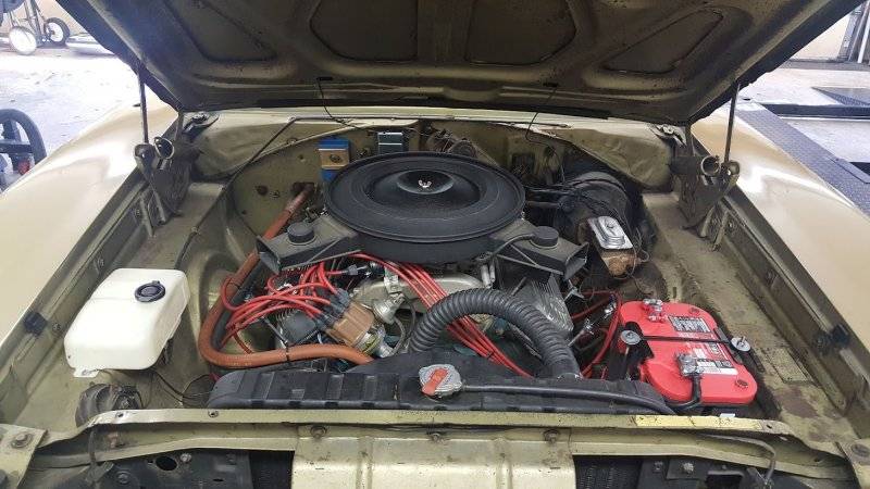

I see an ECU
So he has a Chrysler Electronic Ignition

This is what it looked like when the previous owner got it and before repaint. I hope to get one without the air cleaner today.
I just went to pick up the car to fill up the gas tank with Ethanol Free Premium - Mechanic still working on it. Before the car ran pretty good, it just had a minor backfire. The Mechanic is not done with it but now the engine runs terrible - the engine shakes bad and thought I was going to stall at a red light. The Mechanic is going to install new plugs. He said he put the car settings back to where they where when he started and doesn't know why the car runs worse than when we started.

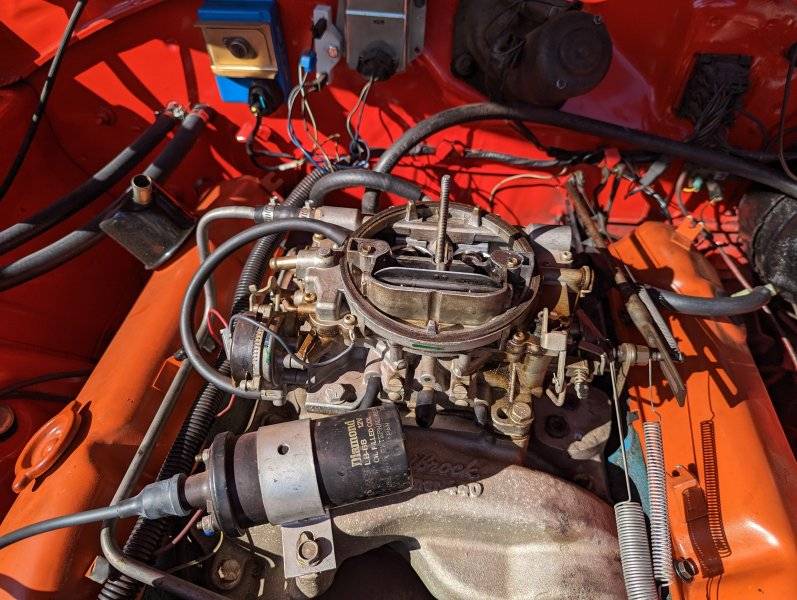

I took pictures of the engine compartment while at the gas station.
Looks like an afb competition or ELdahBrock
