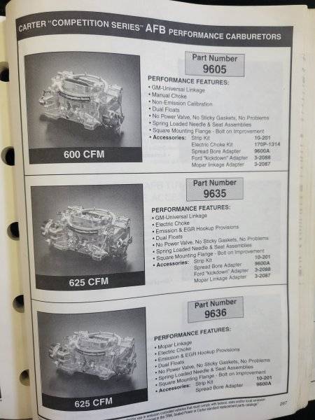

Thank you Geoff that is great information. Did you say why you thought my carb was Carter though? I think it is because of the picture of the ID number of the carb I posted? I just wanted to say your carb is a Carter because of _____________. so I don't make any assumptions.

Well the Carb and CFM inquiry was to find out what the stock brand and CFM was for this 440 engine. Even thought anything may work okay, I wanted to know what was stock and the original intent. I think I can safely say that it came with a Carter carb with 625 CFM - at least that was rating at the time. That inquiry is not my issue now.

Your carb IS a Carter because of the 9XXX stamping on the mounting foot.

@matchek here is a listing for your competition series carb straight out of the carter catalog.
