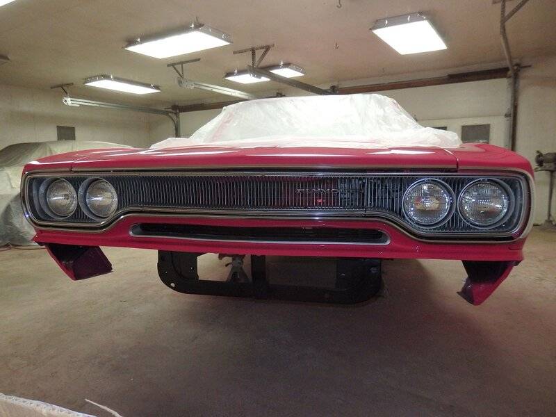

thanks. It's a really cool car which makes it worthwhile seeing it come back to life.
I've been following your project. Looking good. 2 years is a pretty good rate to get as much done as you did.You work much faster than I do. It took me about a year to get my Roadrunner into paint and now almost another year to put all the pieces back on. About a week or two from being done now.

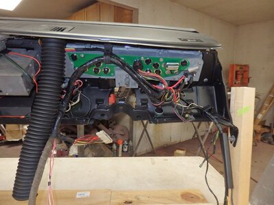

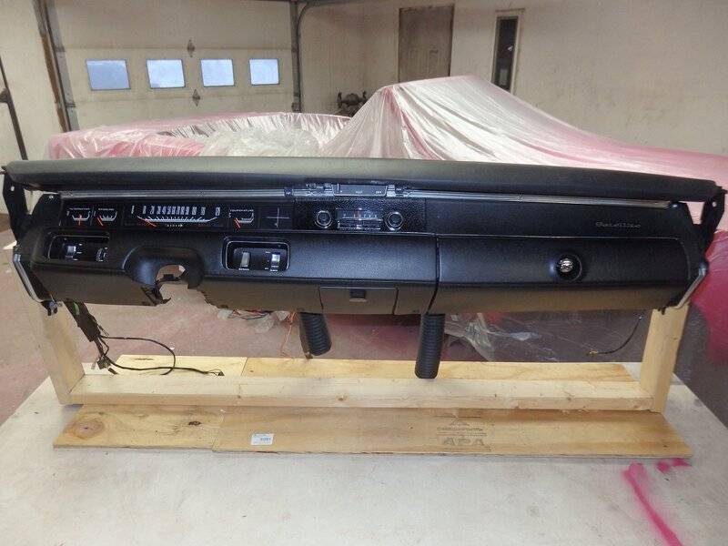

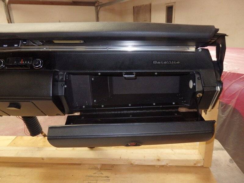

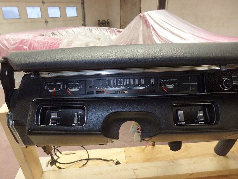

I am redoing the dash myself. I got the textured paint from Instrument Specialties. I did get a quote from them to do the whole dash. Can't really post it hear, but it was in the thousands.Chris, Did you get the dash refurbished & if so by who?

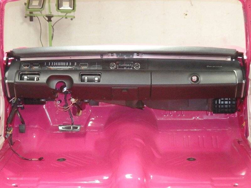

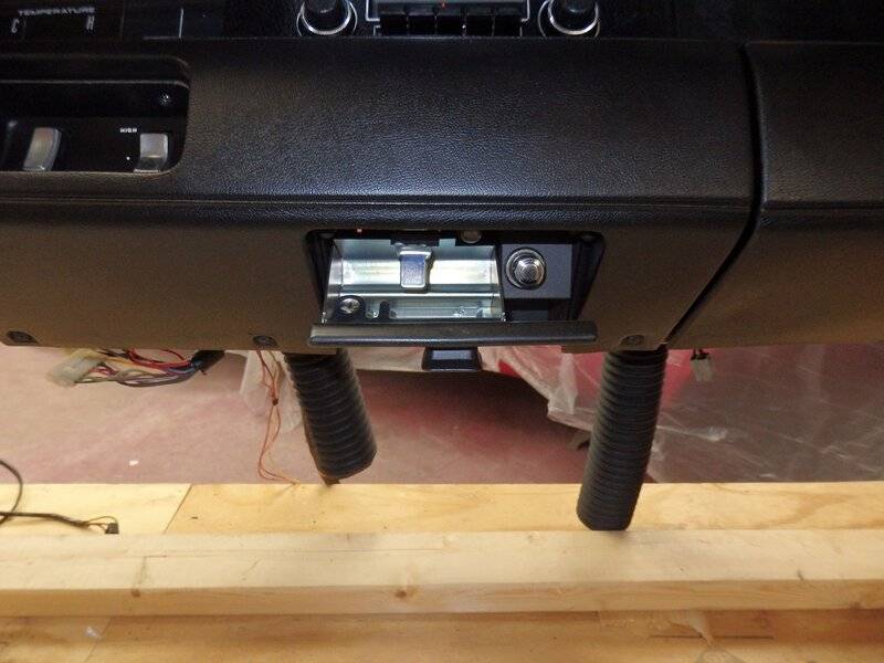

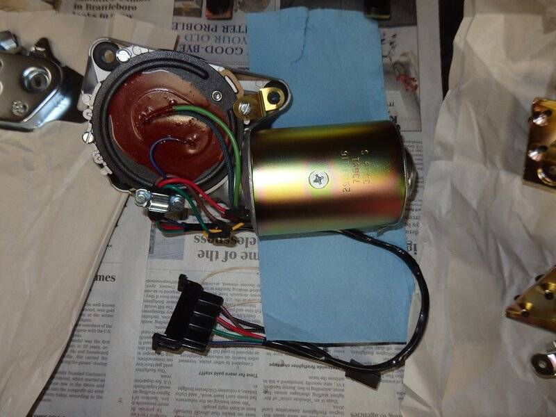

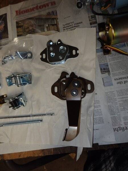

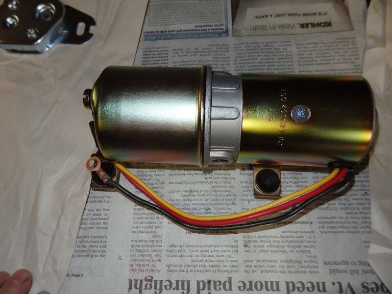

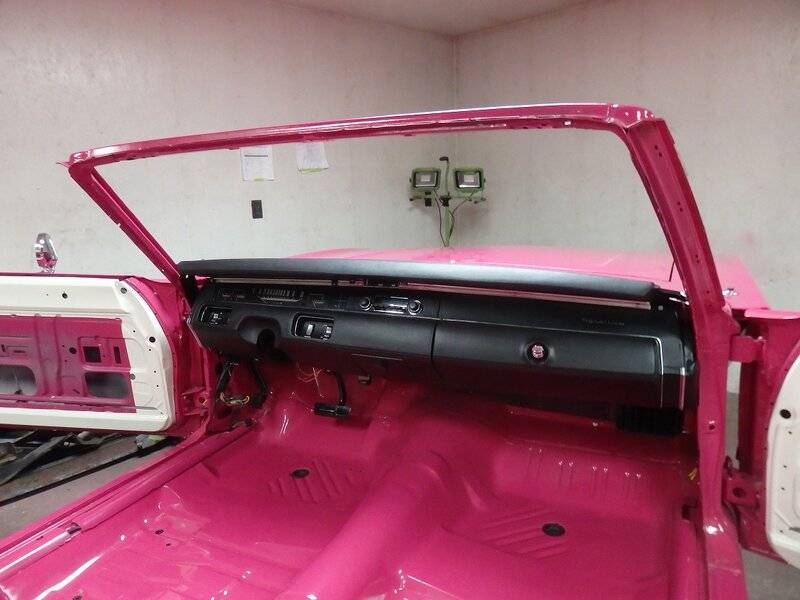

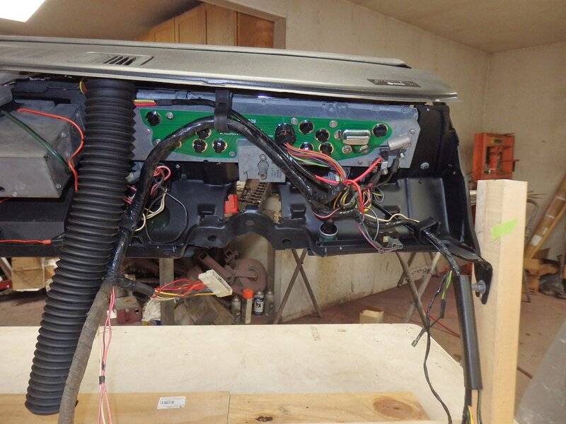

UPDATE 3/2/2022: With the restored wiper motor and parking brake assembly installed, I was finally able to install the dash last night. Couldn't have been easier. I followed moparnation74's lead and installed the dash with the heater controls removed and made the cable connections after the dash was bolted in. I am still waiting for my date-coded windshield to come in to finish that area of the car. next up, install door trunk & hood latches and then the grill and headlights...
View attachment 1248265 View attachment 1248266 View attachment 1248267

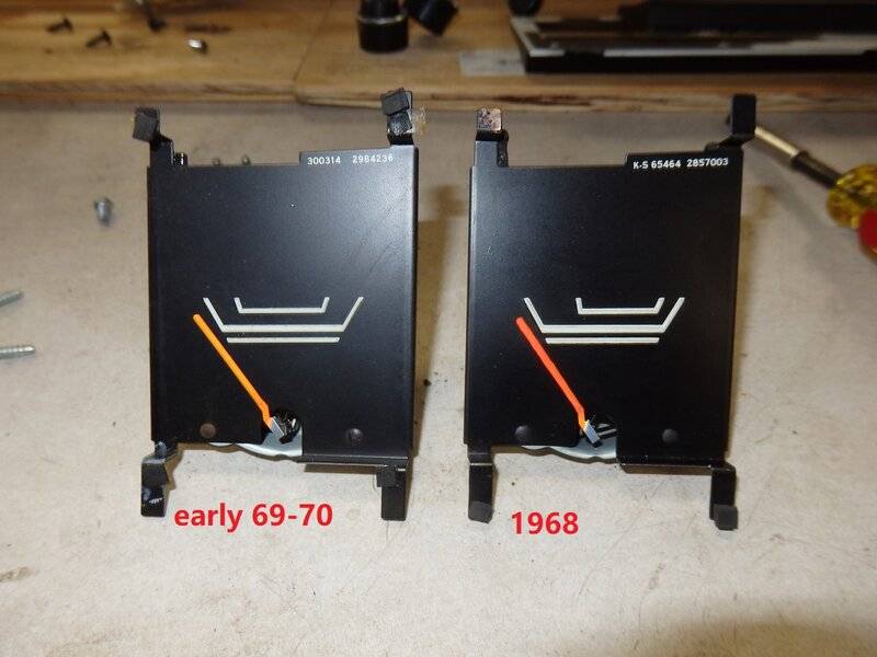

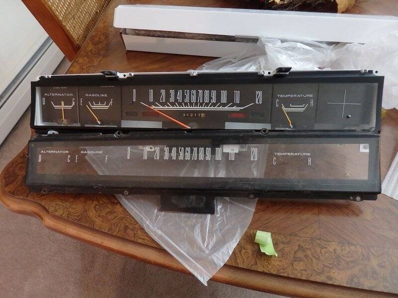

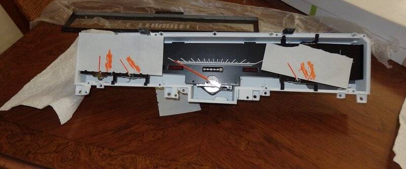

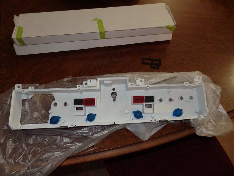

Thank you. What all was involved with doing it? How did you do the speedo and it's lettering?I restored the cluster myself. I thought I did a good job until I found out I had to take it apart and replace the temp gauge when I discover I had one from 1968 which has different temp ranges.
View attachment 1248502 View attachment 1248503 View attachment 1248504 View attachment 1248513
I was lucky that the instrument faces were nice. The inside, I just cleaned up and painted with flat white paint. the clear bezel with the lettering on it it reproduced. It's really nice, but the hole for the clock knob is a little larger then the original. in my case no clock. so I used the original plug. I had to add a little glue to keep it from rattling around.Thank you. What all was involved with doing it? How did you do the speedo and it's lettering?
