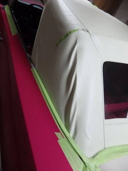

So I have been having trouble with installing the convertible top. I am on my second top. The first one was from Electron Top and it was over 1-1/4 too wide at the rear bow. The one that is on it now is from Kee Top. It fits pretty good, buy I have to deal with these wrinkles on the sides. Chrysler put what they call "stay straps" that run from the rear bow to the well area. the replacement tops don't come with them. Since my original ones were ruined I thought I could get away without installing them. I think I was wrong. I've got some material on order and hope to get this fixed in the next couple weeks.
