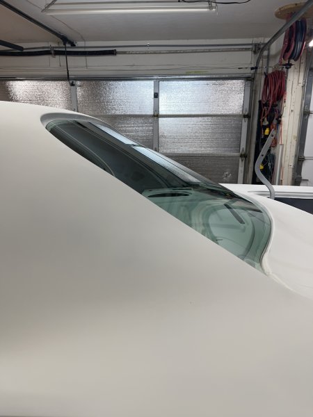

Working essentially with a broken right wrist for the last few weeks. Needless to say progress has been very slow. Reworking the clear coat on a door panel. Its looking good and hopefully I’ll gain more function in my right arm soon.

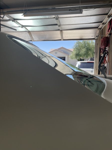

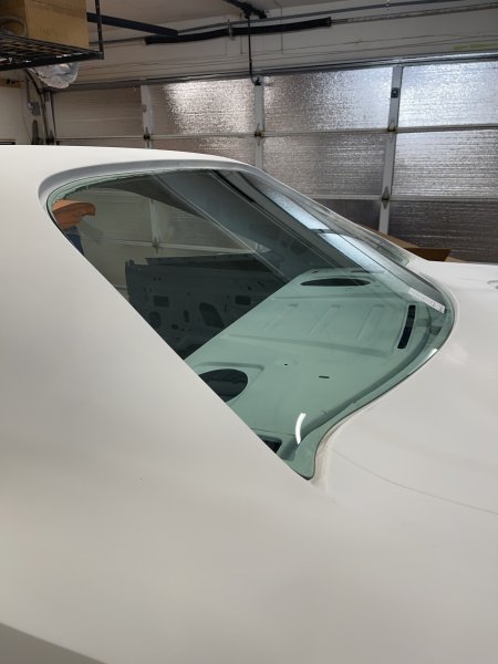

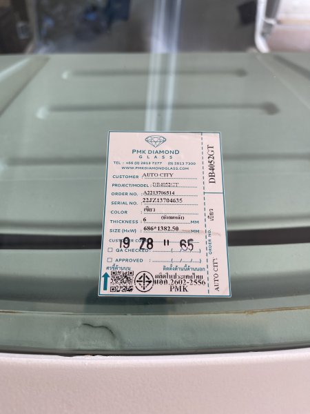

Also received my new rear glass today. The AMD had a defect and I sent it back. AMD then they ran out and it went back order. I believe the profile of the AMD wasn’t factory correct with the bubble bulge as noted by others. Apparently the mold is not accurately reproduced.
So I ordered one from Auto City Classic Glass. I believe this is the right profile. If it is its good to get the word out as everyone lost confidence in all the glass mfg. this is the green tint and is very good quality. Comes from Diamond Glass in Thailand not China.
Let me know what you think of the glass!
Looks good in those photos.

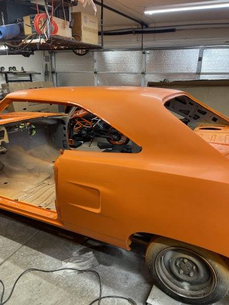

Restarting the paint clock with a fresh coat of epoxy for final seal and paint and clear now in sight.

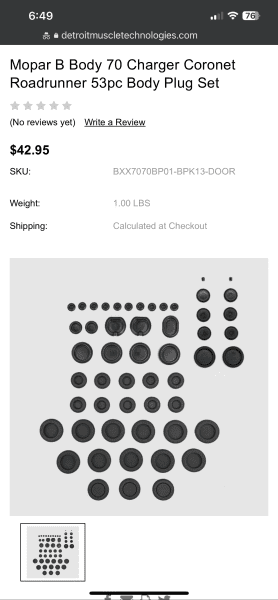

Paint goes on tomorrow. Wow the amount of work that’s gone into this is crazy. Starting to think about the assembly process and the interior scoping out carpet and body plugs already purchased.

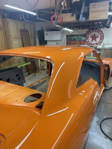

This is the 3rd Wanda base coat and I just put on the 4th. Went on over 4 coats of SPI white Epoxy and 1 coat SPI Epoxy sealer. Went on smooth flat and no orange peel. I am very happy with the color. Tomorrow the clear will go on!

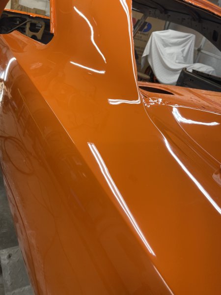

4 coats of SPI Universal Clear. Yup more runs than the Cubs could hope for but overall happy with the results. Up next cut and buff then assembly time yikes!
Ok all runs gone using razor method. Then I decided to cut it. Started with 1000, 1200, 1500, 2000, 2500 and 3000 all by hand. I found that even with a great DA I would see swirling with the 3000 so I just finished by hand. Laborious yes but gratifying seeing it actually start to shine with wet sanding paper. Going to start buffing after I get my compounds. Just bought a full set of pads white yellow green and blue for my new forced geared DA.

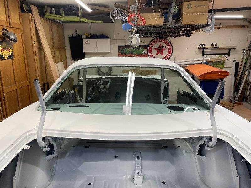

Ok so while waiting for my buffing compounds I decided to build a high quality heavy duty shelf plate. I used the heavy brown fiber board and covered it with heavy cloth backed vinyl. Trying to decide when to put the rear glass in now that the tray cover is in. I need the space in the garage…..
So I was able to get buffing on the Satellite yesterday. Decided to use 3D 500 with a wool pad then moved to a blue coarse pad then 3D 520 (smells so good) with a yellow fine pad. Cutting and buffing really takes a nice paint job to another level. The SPI Universal Clear is very workable.

That looks gorgeous! Lot of time and effort paying off. I would wait to put the rear glass in until you get the headliner in.
Headliner should be here any day. I still need to find the bows. Might not have all the clips and I am not sure if I have the door plates with teeth. It’s been so dang long ago that I disassembled this car.
