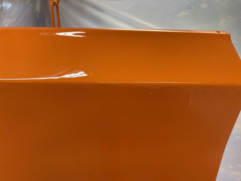

I like the darker orange on the left. It may not be the exact 999 code but I like it.

That’s what I was thinking as well. ThanksI like the darker orange on the left. It may not be the exact 999 code but I like it.

You guys must be better with a razor blade than I am, lol. It would mean an entire repaint if I got a razor blade within five feet of a freshly painted car!Ron, that's a great color! Sucks that you got the runs in the clear. Let it dry fully like Jim said. Use a modified razor blade to scrape them down. As long as the coat is thick shouldn't be any issue.
You tape up the ends so only 3/8" are exposed in the middle. Keeps it from digging in or going too deep.You guys must be better with a razor blade than I am, lol. It would mean an entire repaint if I got a razor blade within five feet of a freshly painted car!
I have a run razor, it's a tool that holds the blade at exactly the right height. Adjustable.You guys must be better with a razor blade than I am, lol. It would mean an entire repaint if I got a razor blade within five feet of a freshly painted car!
